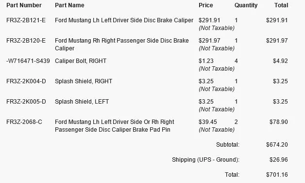

Finally the Tasca cart at $701. ordered new caliper bolts just because. At only $5 more, I say it's cheap insurance. Sure I could reuse the old ones...that only have 6K miles on them, with some Loctite but why bother when new bolts are cheap?
Tasca order screen shot below...sorry the formatting of my post is all screwed up.
So the total is $1,057 and that's with the crossdrilled rotors and performance pads. That's still less than the cost of the FP front-only Brembo upgrade, which doesn't get you the fancy rotors for the front, never mind the rear, or the performance pads.
Obviously, I'm doing the work myself, so there's no additional installation cost save the 16oz bottle of brake fluid I bought on Amazon for....$16 I think? I did have to also buy a bleeder kit, but that's tools, and tools are an investment so I'm not counting that cost.
AT $1,057 I'd say I did OK.
*edit* I did order new banjo bolts from RockAuto. Not for the bolts but for the two brass crush washers each banjo bolt comes with. I did not want to order one of those 1,000 piece kits off EBay and then I wind up not using 99% of the parts it comes with. I ordered 6 bolt/washer sets just because I wanted to have those extra washers. That was $16. So I guess if you wanted to say "That's part of the total cost" I'd agree with that. So $1,057+$16=$1,073.
$1,073 for all that including new crush washers...still a good deal IMO.
