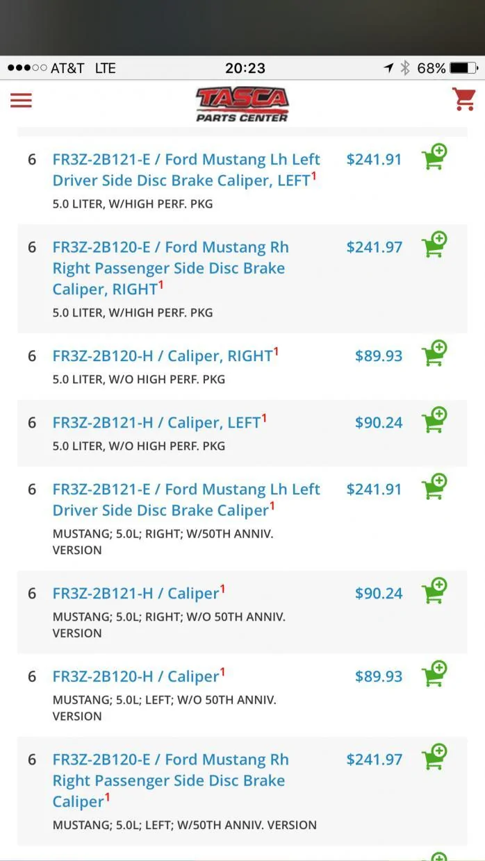

Those are the correct part numbers for the Hard Anodized Black that comes on the PP GT. "Flat" black with red lettering. All the calipers start as these then they either paint the Gloss Black or Red (50th/Bullitt) The Number changed because they are now made at Brembo's facility in Mexico rather than Italy. Same exact part from 2015-2019.
Is there something I’m reading wrong because in every description for this part number it reads 4 piston? Is this an error in the description because if they are indeed the 6 piston Brembo the price is very good..
