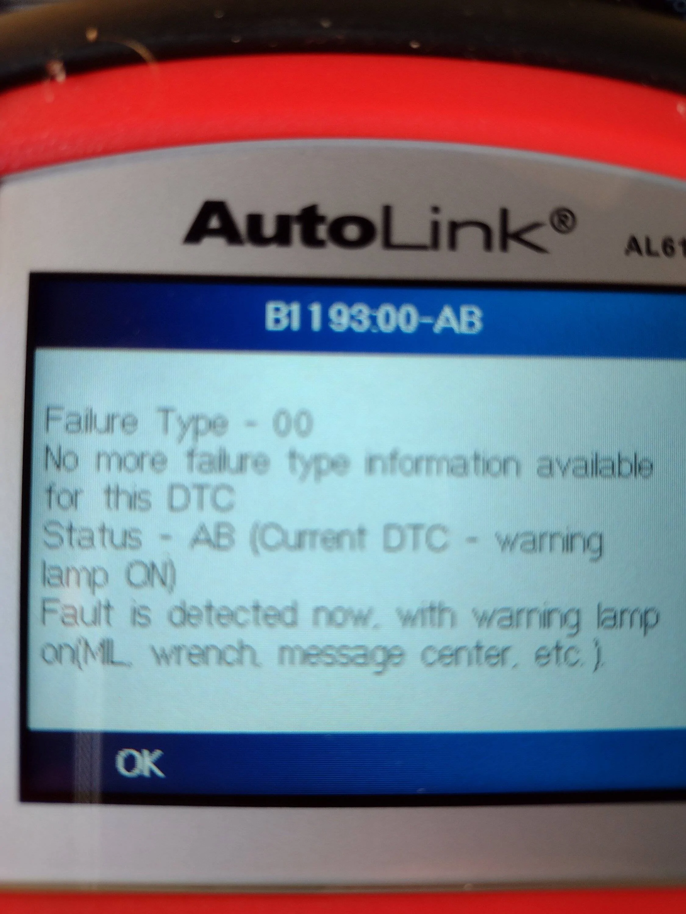

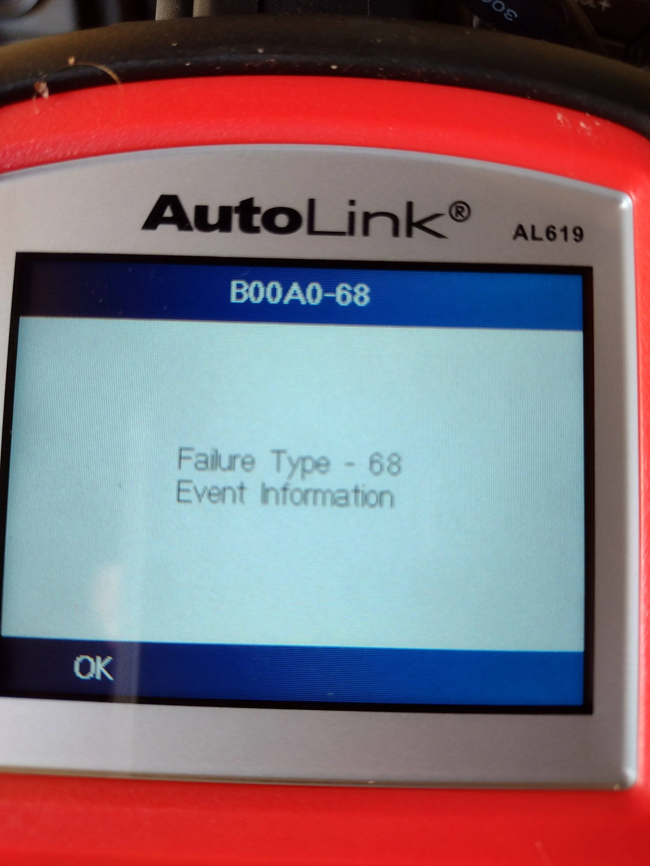

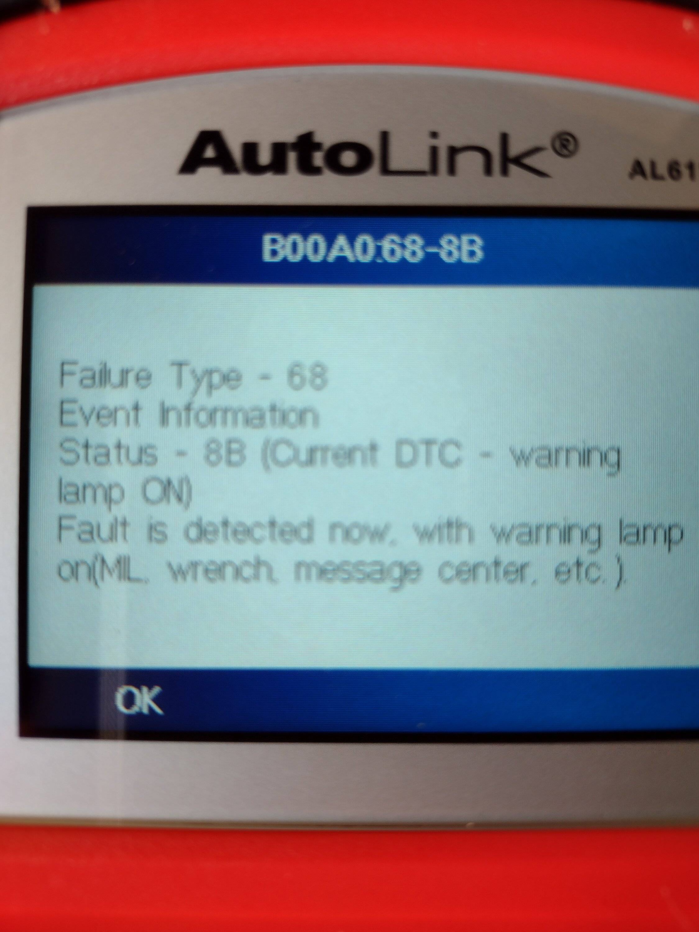

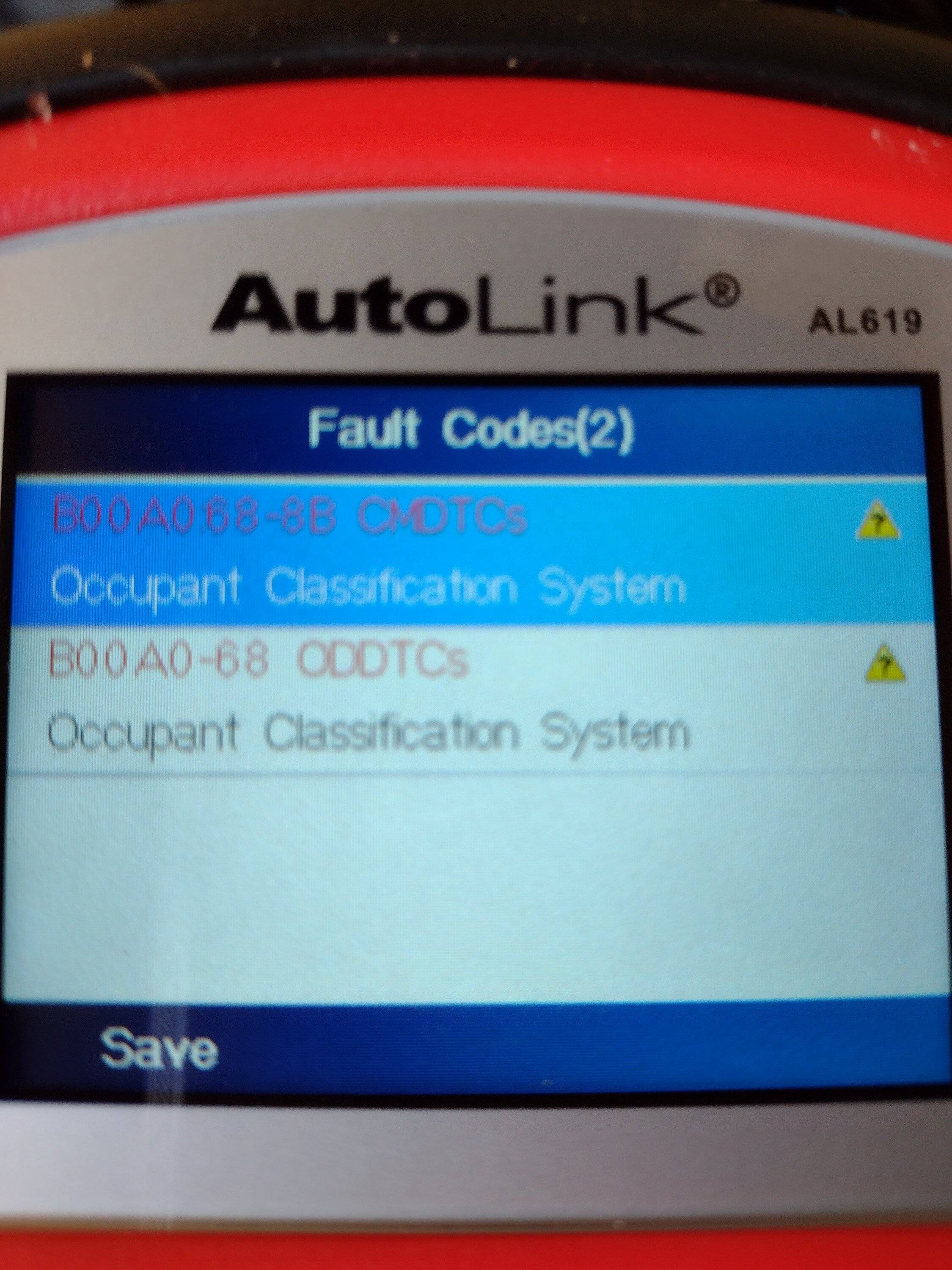

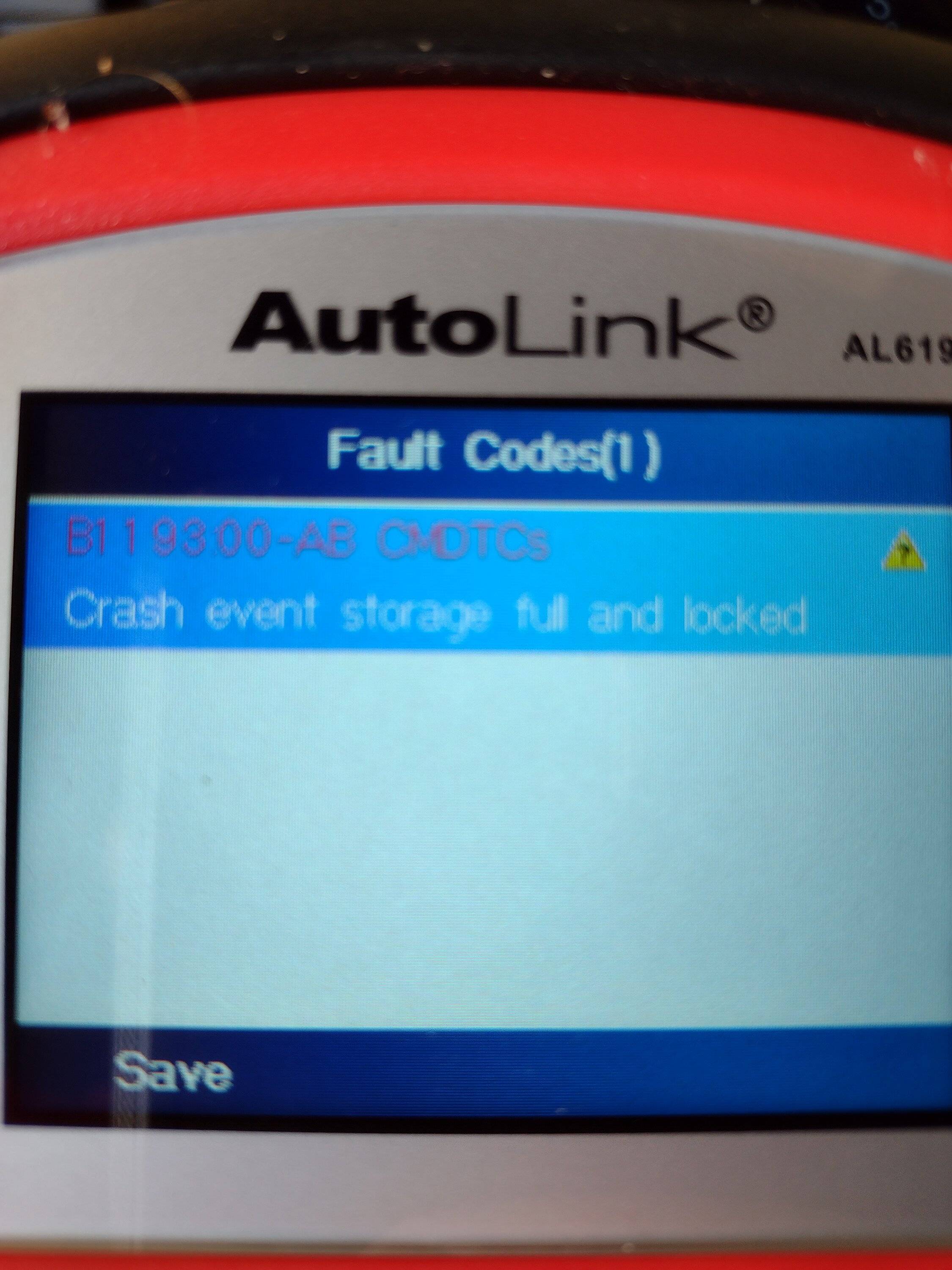

Put the "new" passenger seat back in, got the airbag light. Below are the codes.
Code B119300-AB CMDTCs seems to mean that the Airbag Contol Module needs to be replaced, which makes no sense, since that's part of the car, and the car hasn't been in a wreck. The passenger seat was in a car that was crashed, but the airbag is intact. I assume that something in the seat knows it's been in a wreck, and that's where this is coming from. Replacing any part of the car doesn't seem sensible to fix this.
Do you think switching the backrest from my stock seat over to the new passenger seat will clear this, since the car will recognize its original airbag?
