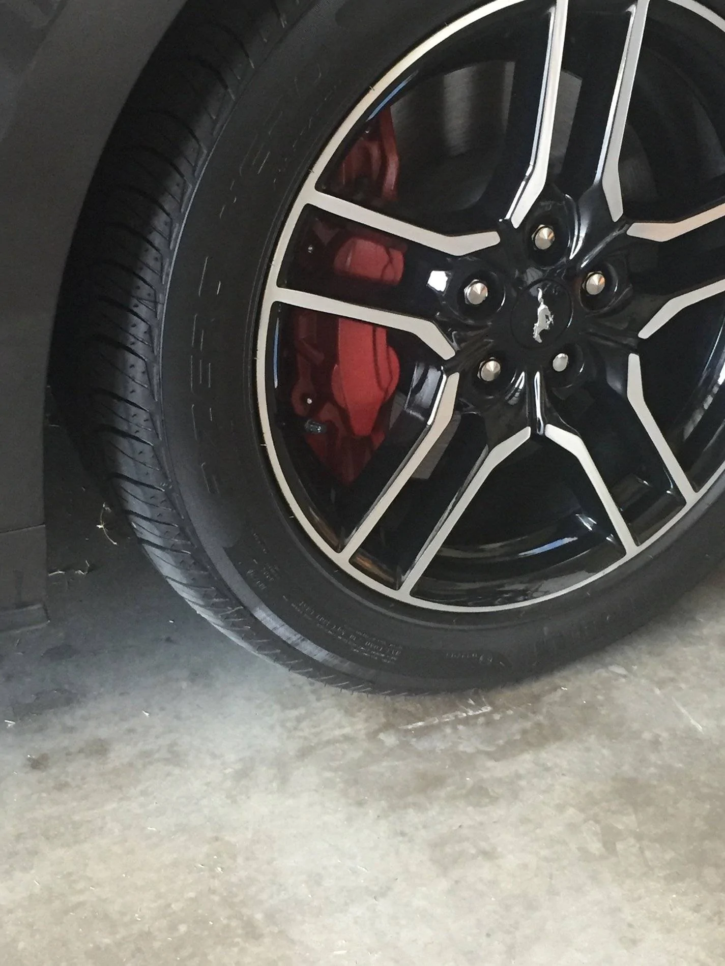

I'm a mechanical idiot, this was the only time I've ever had a car on 4 jack stands and only mod I've ever done, and it was very, very easy. Looks great as well, I must say.
And the company was great to work with, I ordered black right when the shutdowns started in March/April, but they sent me gold instead. I called them directly (Amazon order) and they rushed the black out to me 3 days later knowing they would probably never get the gold back. I'll try and return the gold at some point when things get back to normal.
