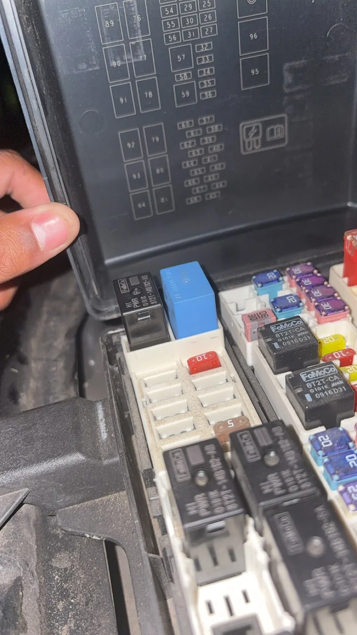

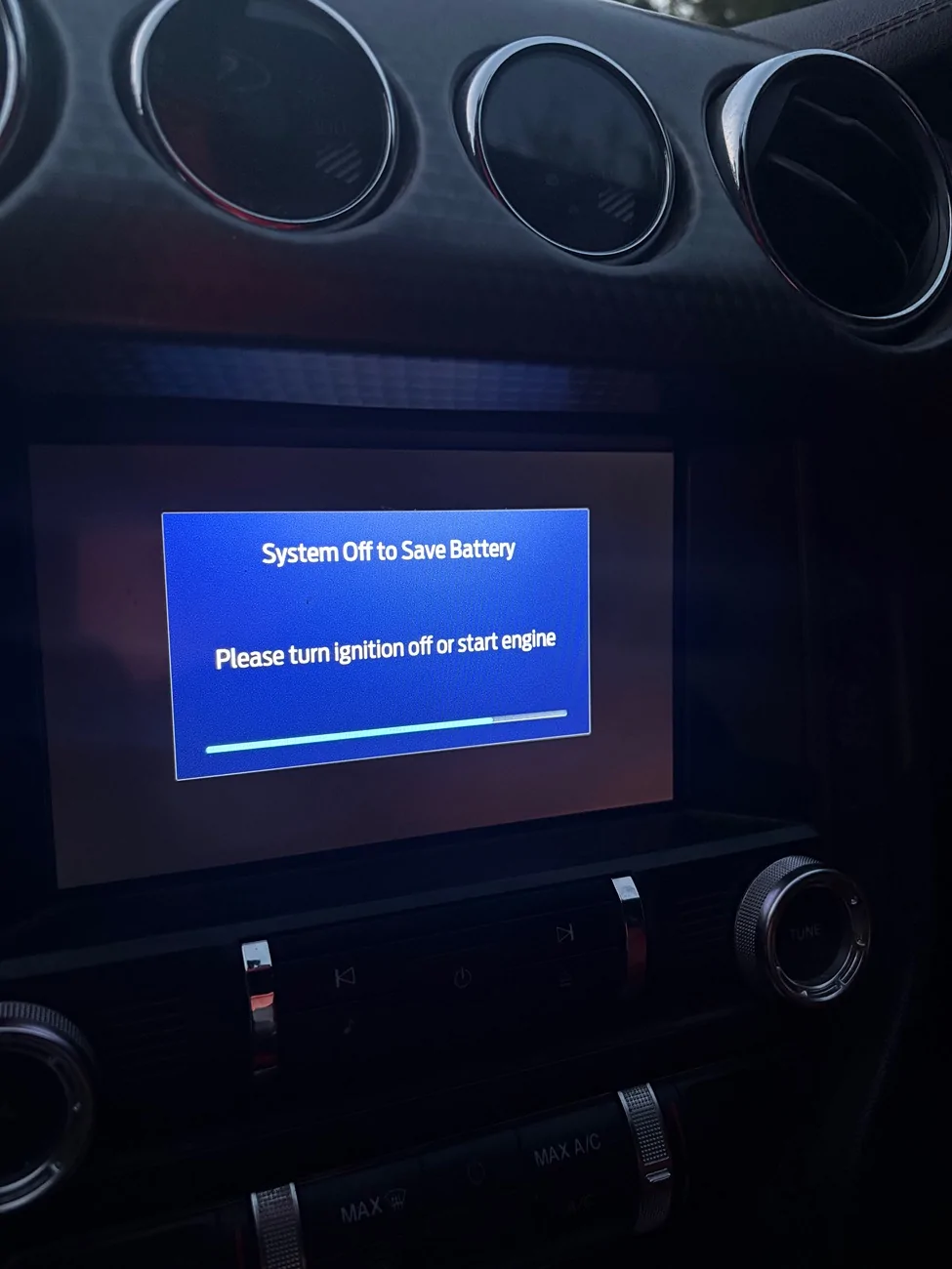

ANOTHER UPDATE: just got home, was going to start it when this message was on my sync screen, car unlocked fine and everything, and then I heard the throttle body actuating and a clicking noise from the fuse box area, pulled the black relay in one of the pictures below, and it stopped, put it back in and it kept doing it, anyone have any ideas what it can be?

Does the fuse box label describe what the relay is? Also, if you have electrical issues and you're trying to troubleshoot charging problems you're going to need a voltmeter. First thing when you see that error is check the battery directly and see what you're reading. If it less than 12.5 volts you definetly have battery drain issues. If you can start teh car, you need to see how much voltage is reading athe battery with the car on using your meter. It should be over 13.5volts. If you're seeing 13.5 turn on your AC and radio and read it again. It should be reading over 12.5 volts under load, and ideally 13 or more.
For that relay that is clicking, you need to use your meter and see if one side is hot with the ignition off. If it is hot and the relay is sticking, you could be draining that way.

It says it’s the powertrain control module relay
If you have electrical issues and you're trying to troubleshoot charging problems you're going to need a voltmeter. First thing when you see that error is check the battery directly and see what you're reading. If it less than 12.5 volts you definetly have battery drain issues. If you can start teh car, you need to see how much voltage is reading athe battery with the car on using your meter. It should be over 13.5volts. If you're seeing 13.5 turn on your AC and radio and read it again. It should be reading over 12.5 volts under load, and ideally 13 or more. Low voltage will cause all kinds of weird gremlins to pop up. You have to be 100% sure your battery and alternator are working as they should or you'll be chasing your tail in circles.
Another thing, a bad chassis ground can cause major electrical problems as well. I chased a bad ground on my old E34 M5 for months. Visibly, the ground looked fine but when i finally removed it, the backside was completely corroded. Replaced and everything began working like new again. So checking your chassis grounds would be a key step as well.
