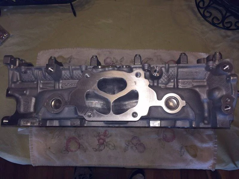

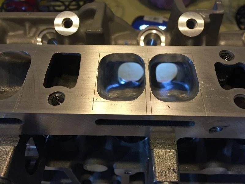

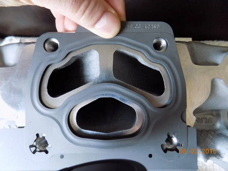

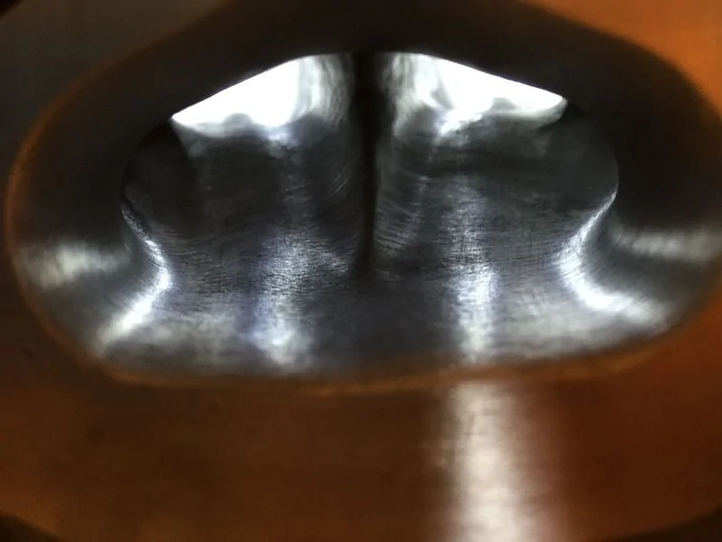

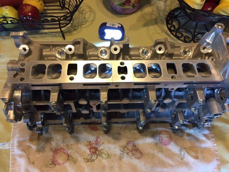

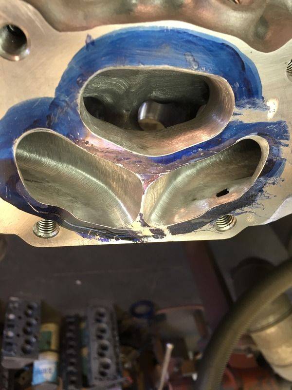

Came out pretty good! I replied to your email about a cam tool.
The exhaust side is very very thin because there is coolant that runs through the exhaust side up to where the turbo bolts to the head. We do the water pressure testing for this very reason.
Thanks Adam, I'll take it. I plan on making this available for our forum members use, along with all the extras Buckets I'm going to end up having.
Back pressure could be significantly higher than that, I've measured 100psi of back pressure before.
I do understand that, back pressure can be 3 times boost pressure with a small exhaust housing like these cars have.. It passed pressure test today at 45 PSI, I think that should be good considering coolant pressure will offset 15 PSI or so....
I'm getting really jacked about getting this head on, hoping the shop will get the head done quickly!

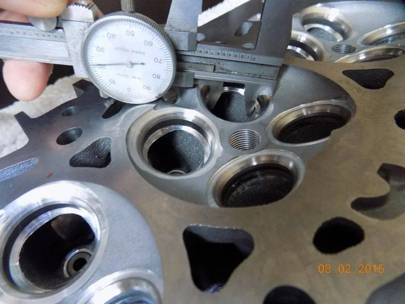

Well the head is together and the new Ford Racing cams lash has been set. waiting on the cam alignment tool now. I think I have everything else to install it....

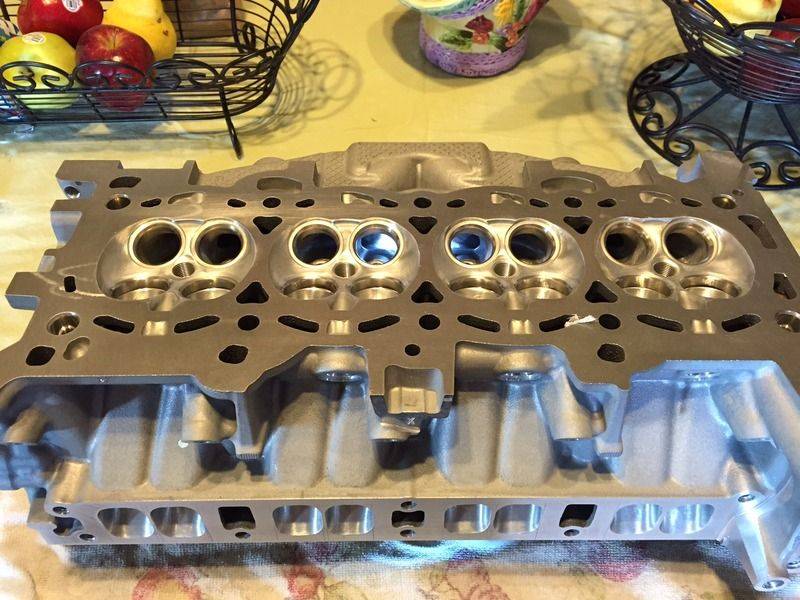

Wes King did the porting, he was a understudy to Grumpy Jenkins, very good at what he does. I'll break down the cost for you guys.
New head. $850
Porting. $1000 lots of hours in this head. He said next one will be $1500
Machine work $383 (valve job, pressure test and surfacing
Cams $270
Buckets to set valve lash $200
Top end gasket kit $212 (came with everything including new head bolts)
Plus my time disassembling the head running it all over, setting lash, I prob got 10 hours in it. Not cheap to do the way i did it. Keep in mind I'm still running stock valves, springs retainers and valve guides. At this point for my setup I don't think I need those parts. If I build a bottom end later I'll add as needed
