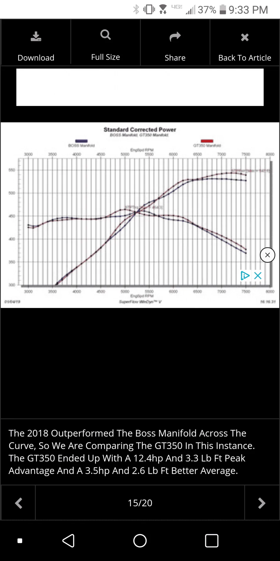

I switched from a ported Boss to a ported 18 manifold. Boss carried power from 7500 to 8000 better but the 18 mani has better torque and power everwhere below 7500. 18 mani will still pull to 8000 no issues but you can feel the difference but it is not major. 18 mani is better all around compared to the boss mani. Much more torque, and for a daily driver it's a better driving experience in my opinion. I had the Boss for more than a year. Had the 18 manifold for almost a year.

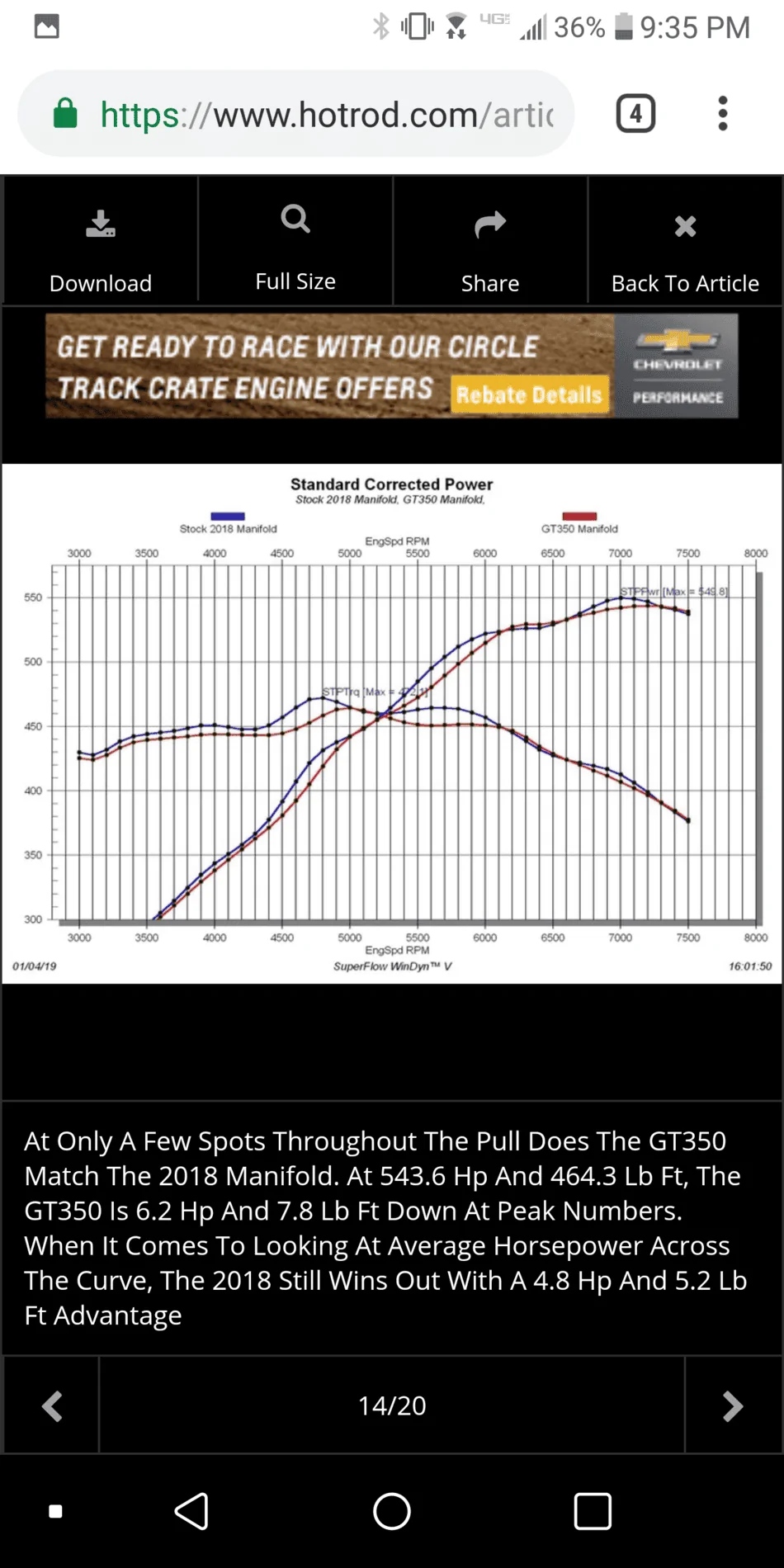

:inspect::inspect:
https://www.hotrod.com/articles/dyno-every-ford-coyote-intake-manifold-on-gen-3-crate/

There are a lot of other changes between the Roadrunner and the Gen 3 Coyote besides the manifold. 12:1 vs 11:1 CR, slightly larger displacement, and the addition of DI fueling in addition to port, to name a few. The Gen 3 is a ~470-475 hp engine. No doubt the manifold is a big part of the performance, though.
