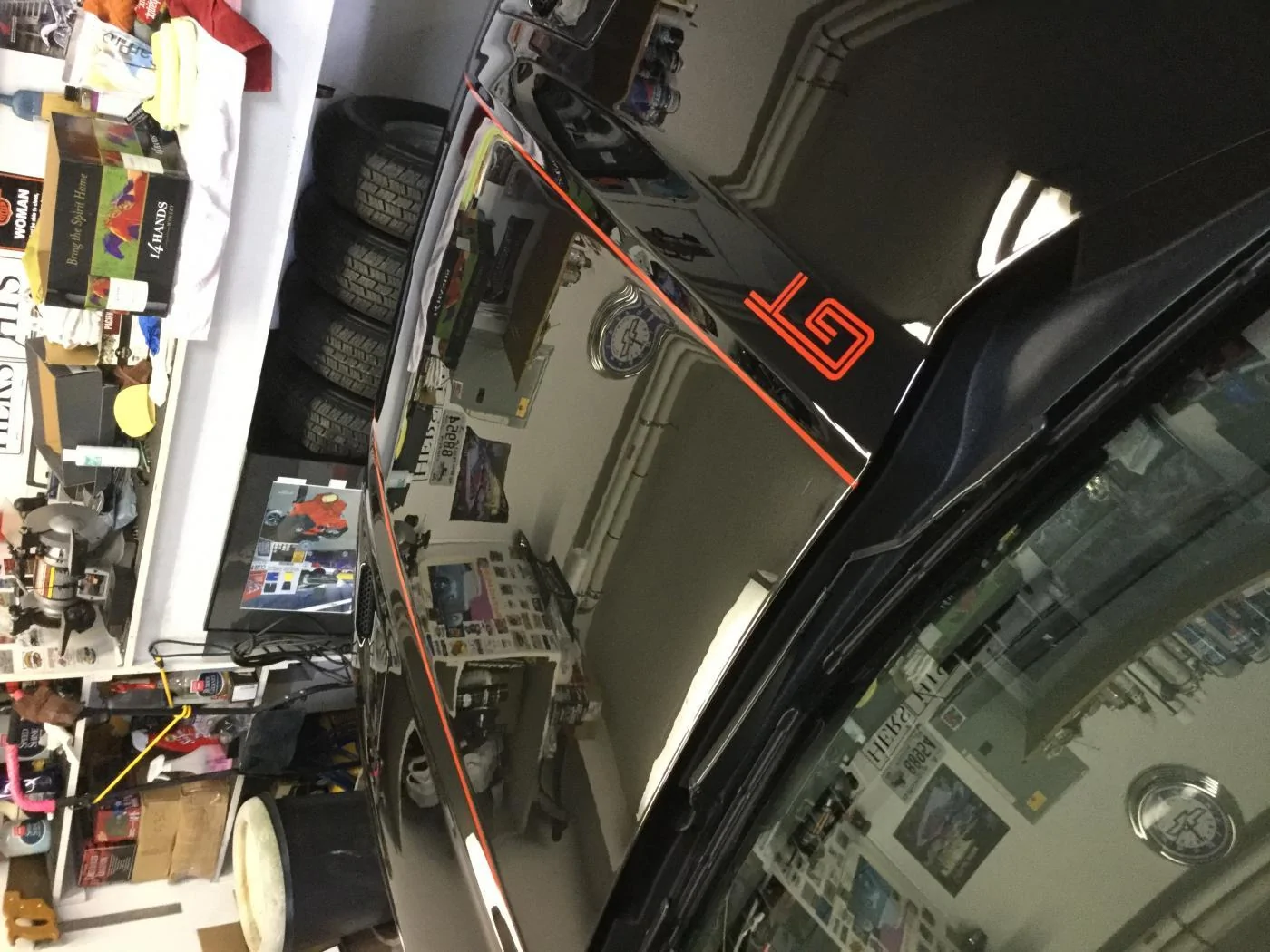

I did mine this weekend. Check out my end product per stage. I didn't show the process, but you can see the end product per phase. Using Chemical Guys products. For Swirls and Scratches, it is a pain to remove so proper technique per wash is important. Not doing the proper wash will be counter productive. I learned from watching the Chemical Guys videos. There are other great products out there, but I decided to use these guys. The end result was AMAZING!
