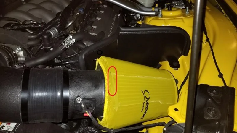

I've had the PMAS for a few months now and had a couple of questions.
1) Does your PMAS make a slight whistling sound on acceleration? Mine does (high pitched sound). I checked and all connections looks tight. Reviewing the forums, seems like there isnt consensus on this. This was expected in my Turbo Audi with diverter valve, silicone hoses etc - was surprised to hear intake sound on an NA car (I like it).

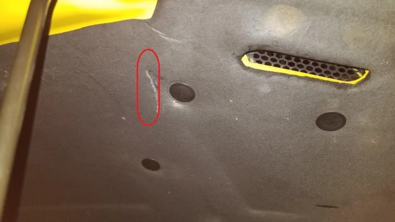

2) My PMAS intake rubs slightly against the liner on the bottom of the hood. See picture. I tried pushing it down but doesnt seem to spring right back up. Any idea looking the the photos if this is normal or I need to make further adjustments? This maybe keeping the box from sealing properly.

mine rubs pretty severely on the elbow, but not at the filter to my knowledge.

I have an older gen with the full heat shroud, and I see a small place where it rubs the elbow, but it is very minimal. You probably checked this, but make sure the elbow is rotated down as far as you can get it. That would require loosening the clamp at the TB and turning the elbow. It's a tight fit for sure!

I'll recheck. I'm sure it moved when it was reinstalled last by the mechanic who replaced my TB. I'll double check....the general fitment of the PMAS leaves a little bit to be desired.

Mine rubs the top at same point. It does not hit the filter. I run the same pre-filter as well. Keeps the water off nicely.
