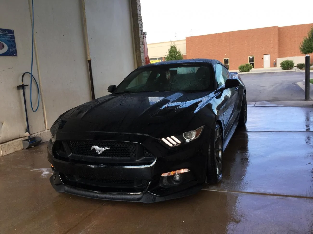

I was thrilled to rinse it of after it hung out in the shop for weeks and became filthy. Wouldnt let me attach more pics so just the 1 it is.

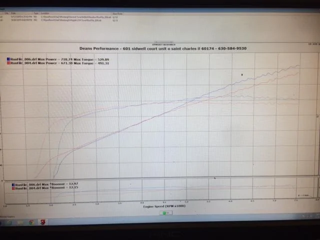

I got my front runner skinnies in so now the car is 100% track ready. But I put it on the dyno last night and my new tune is down about 50hp so all track plans are called off until the car is back up to at least 700rwhp. Hopefully that gets resolved soon. It's looking like I might have to shift gears once again back into the direction of custom tuning. We will see if anything comes up in the next few days but I am not sure where it could possibly go from here other than that.
On a positive note the new fuel system is holding pressure in the rails all the way to redline... So that part of the car is ready to go further.
Attached dyno of my old graph versus the latest. I did pick up a little low end but I think I'd prefer to go back to the much better top end!

so what happened to 50 hp? I thought you said it was running great on the new header tune??
It runs and drives very very nice, even better than before, like I was saying.
It just also makes 45-50 less HP when I floor it than it did on the last tune.

Its probably the same tune as the car that did better, there is just something making my PCM unhappy. Its most likely pulling timing out for some reason. My guess anyway. I dont have any evidence as to anything else that would be hurting the power. A/F's look well enough, boost is all there... timing, unfortunately, I cannot see.
I suppose its possible my engine is hurt, but its not showing any obvious signs of that yet.
Charles dis you flip the octane switch on the software?
I left it how it was set, didnt pay attention to it. I dont recall what position it is currently in... whatever it would default to I suppose. But that is an interesting point. I dont really have any information about my calibration, and I dont know if its setup to utilize that switch, and I wouldnt know which direction it needs to face to be in the more aggressive mode.
I moved the Mustang home last night, but I can plug in the laptop and check tonight when I get back.

From what I've learned the switch "on" will reduce timing. It was designed incase of not having good gas available or if wanting to run "safe" and it cuts timing so the timing will be at a lower starting point.
If your switch is on it would explain the loss in power.
