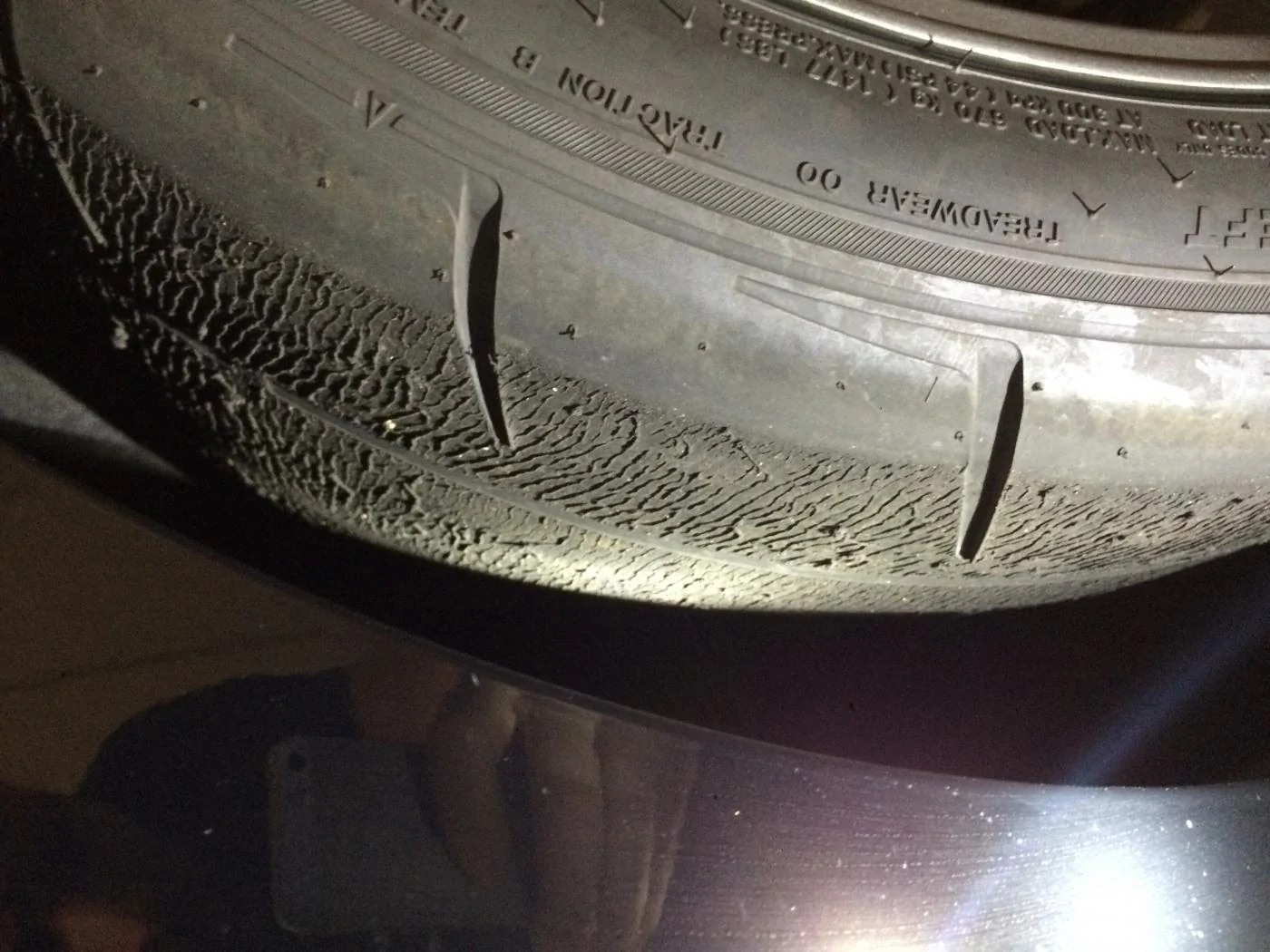

Im going to try another tire... I am suspicious that the NT05R might just really suck for use on a IRS car. The entire surface of the tread is covered with rolled up peels of rubber. I can just roll the peels off with my hand... there is no way its not hurting the grip to have a layer of rubber roller bearings between my tire and the road. I believe this peeling rubber is a side effect of having anything other than zero toe and zero camber like a solid axle car.
This peeling effect is also why I probably got only about 2000 miles out of the tires. It could also explain why these tires hooked awesome when they were brand new (no peeling rubber on the surface, just clean fresh tread), then started to suck after a week or so. I initially was blaming heat cycling effects on the compound but now I am thinking its a screwy wear issue.

Photo attached of what nt05R turn into on this car... Definitely worth an eyebrow raise towards my traction problems.
