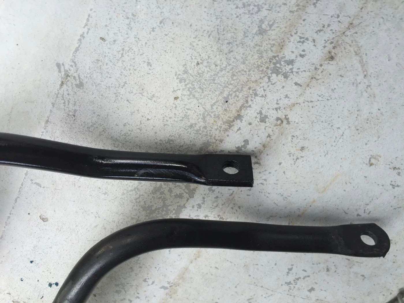

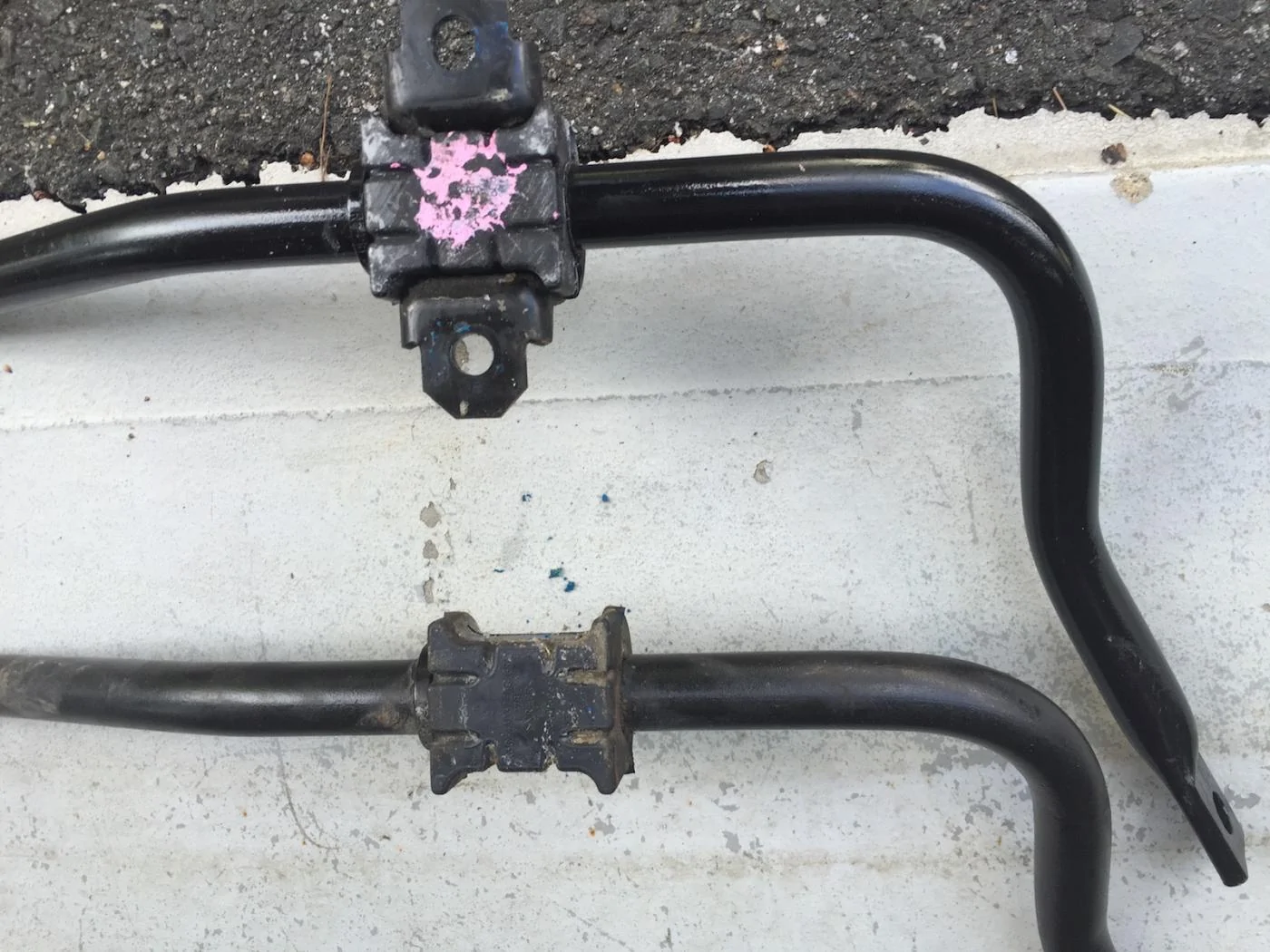

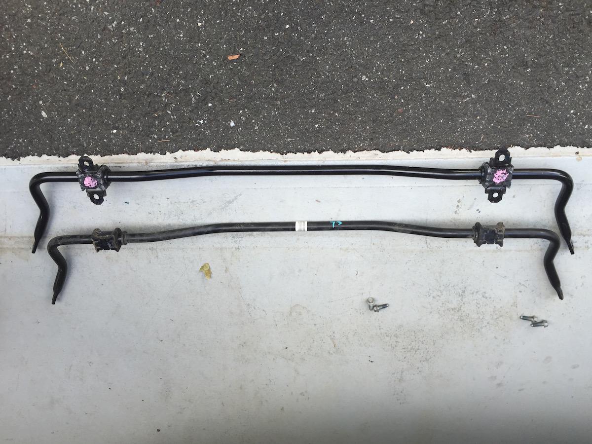

The mounting bushings are NOT the same. Neither are the mounting saddles.
The PP comes with a larger mass, more rigid, "sticky" bushing that increases the rate technically.
The Non-PP comes with a smaller mass, less rigid and "floating" non-bonded bushing and a weaker mounting saddle.
See the photos below. Non PP left, PP right.
Honestly, I see people posting quite a bit of misinformation from phone calls they have made to companies that you would think know better.
I am here to tell you, that person on the phone hasnt touched a fraction of the S550s I have. ;)

Thanks for posting this Kelly! Pictures are always worth way more. I still stand by the fact that the difference between the PP and non-PP front bar setup isn't worth the effort if you're planning on upgrading to aftermarket bars later. It's certainly a better setup over the non-PP, but a set of your or Steeda's bars with your respective mounting brackets is a much bigger and more worthwhile change to go through with it. If you've already got the car apart and are doing springs, for instance, maybe.
