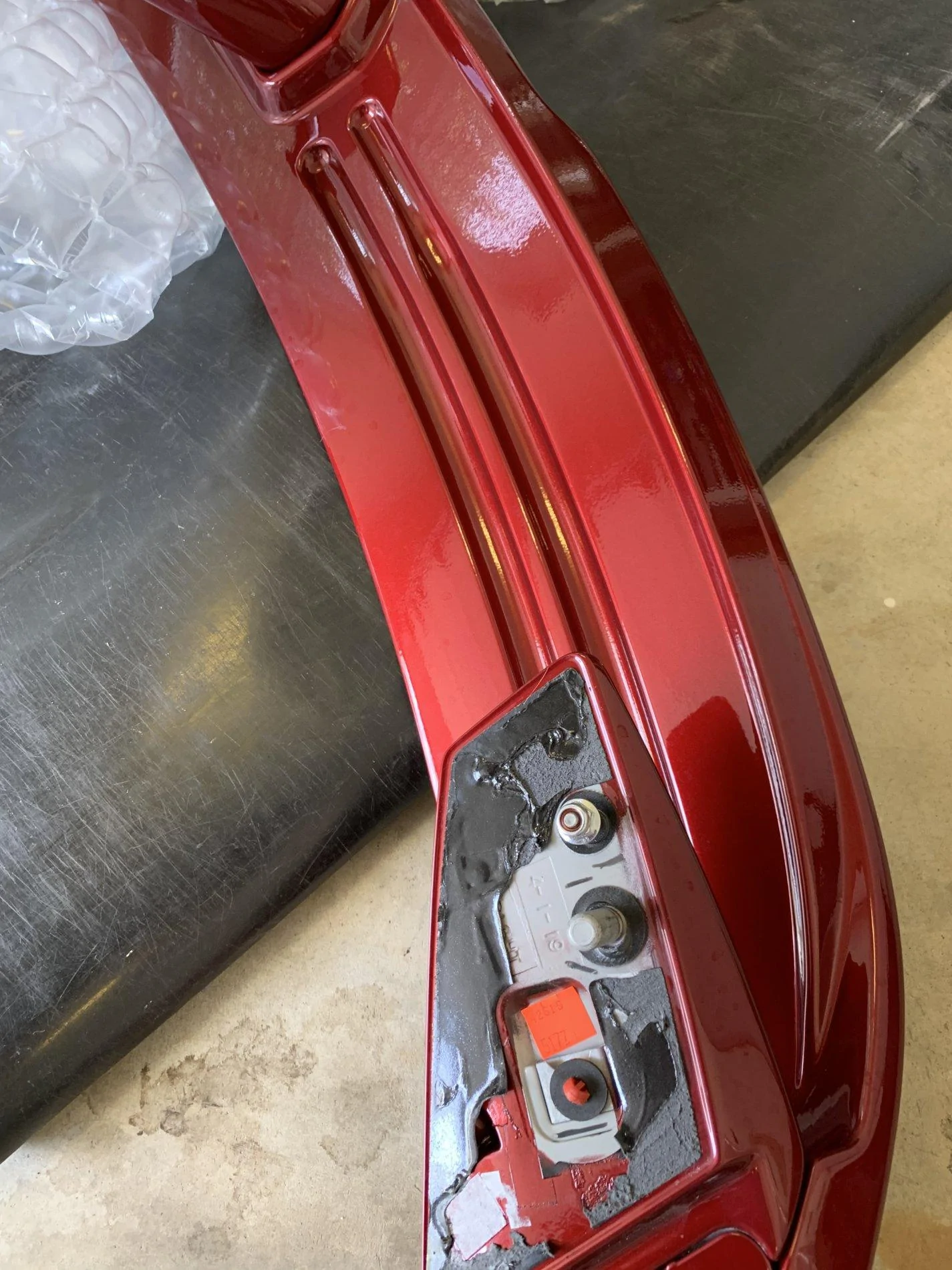

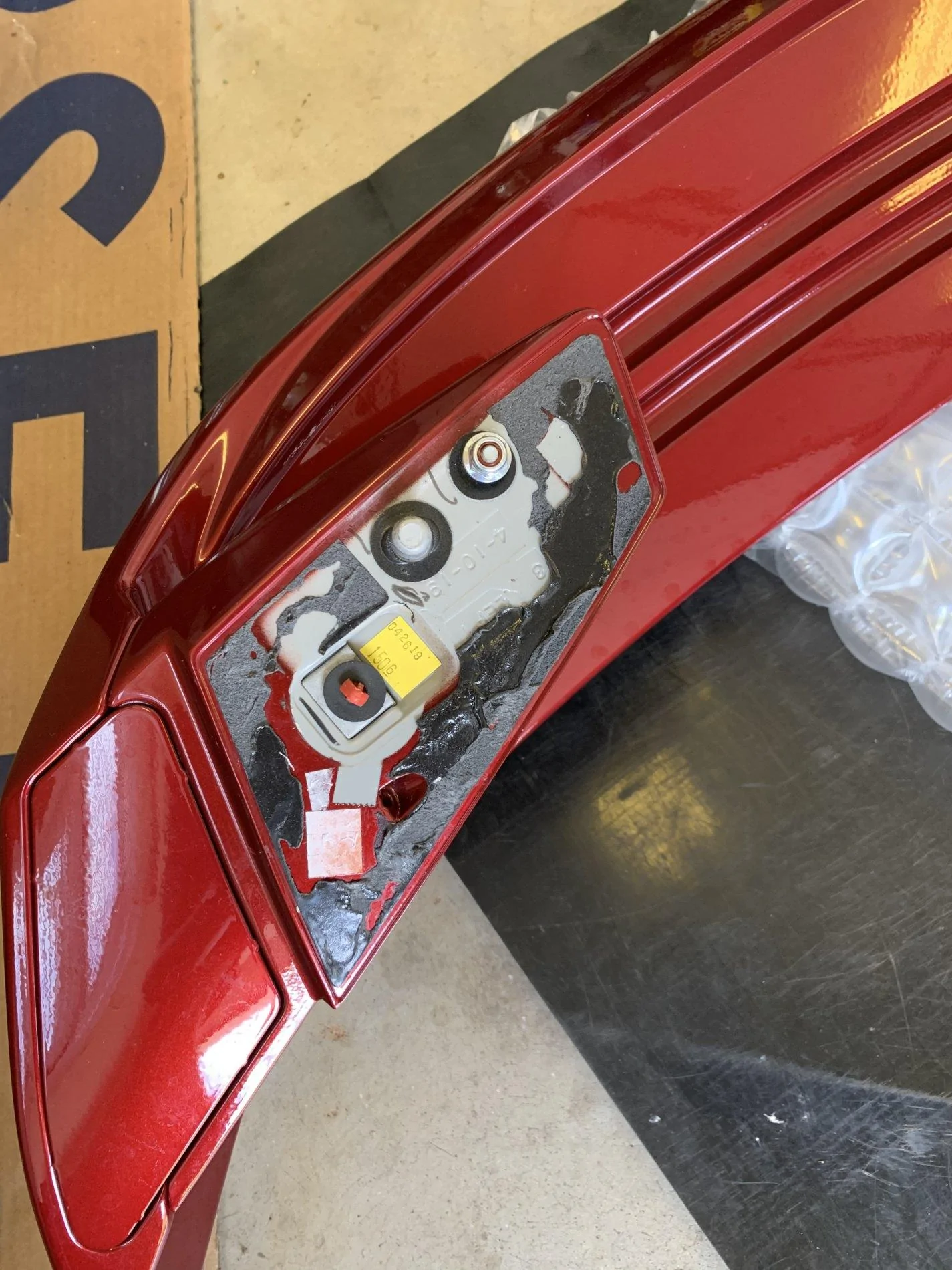

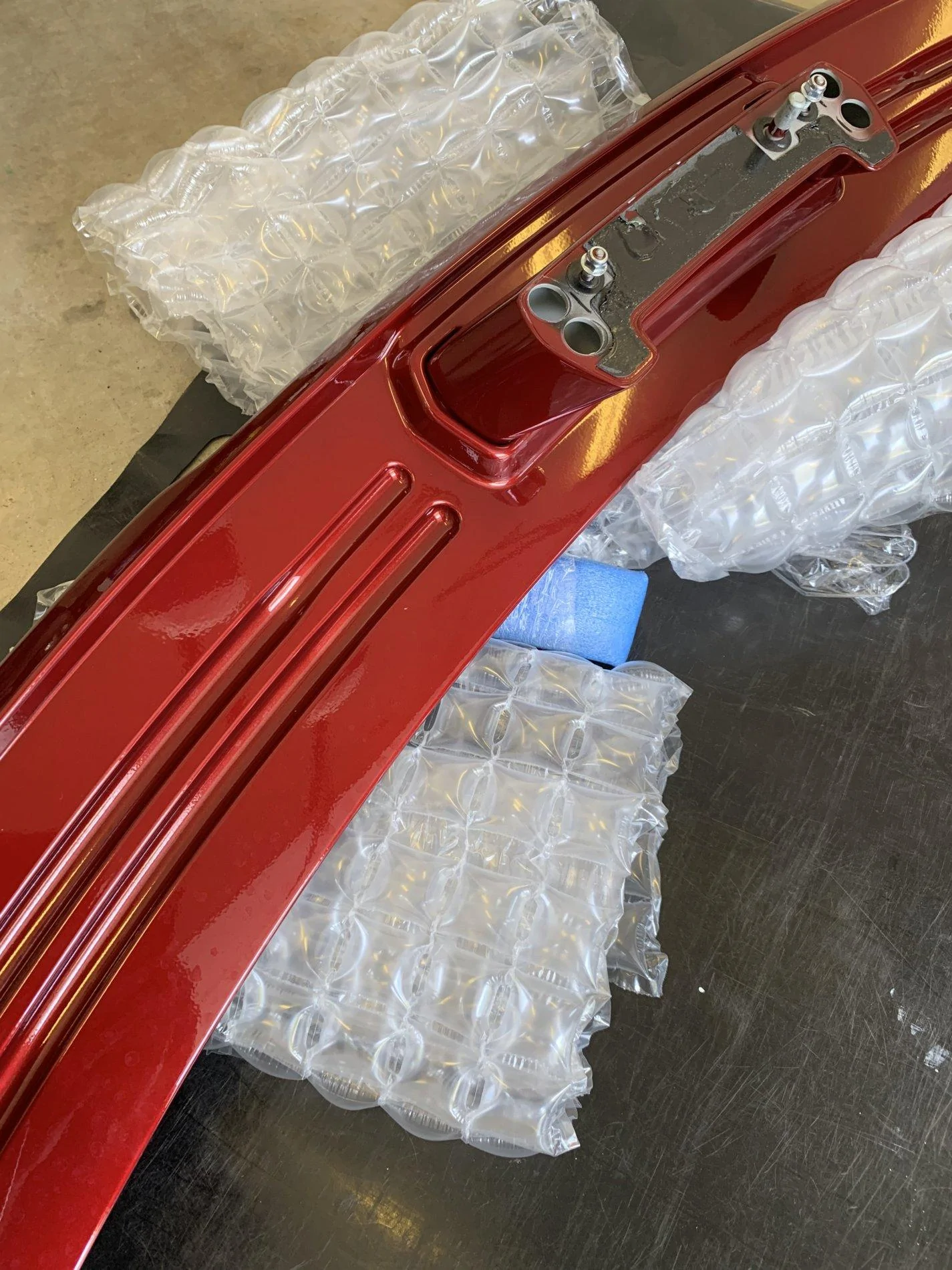

Removed my PP1 spoiler this past weekend on my 19’. Hope these pics help you guys.
Thanks. That definitely helps. Looks like Ford uses one piece die cut double sided tape. I assume those unthreaded posts are locating pins?

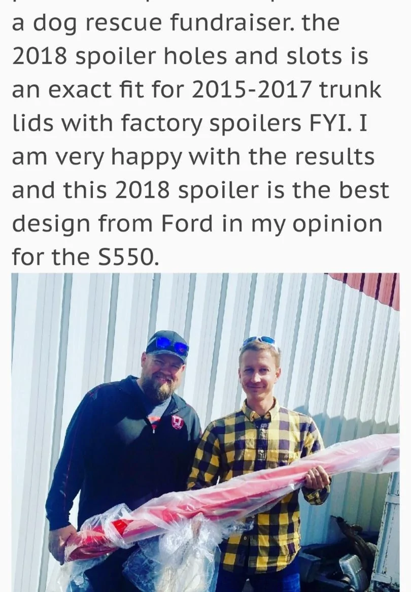

I am doing a spoiler swap on my '17 GT to an '18 PP1 as we speak. Bought Kermitz's actually. All the info I've come up with is that the bolt holes match. This pic is of a guy with Bill from CJ Pony who did a swap.
