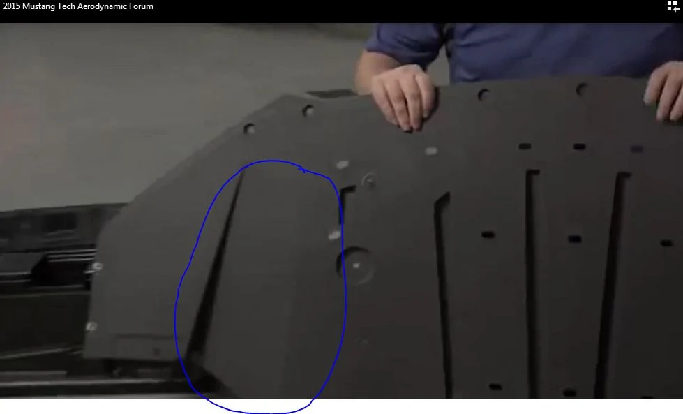

I second GJarret's questions :
Is it simply a different mold of belly pan that uses the same mounting points?
Same question for the air deflectors on the control arm...
