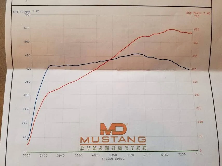

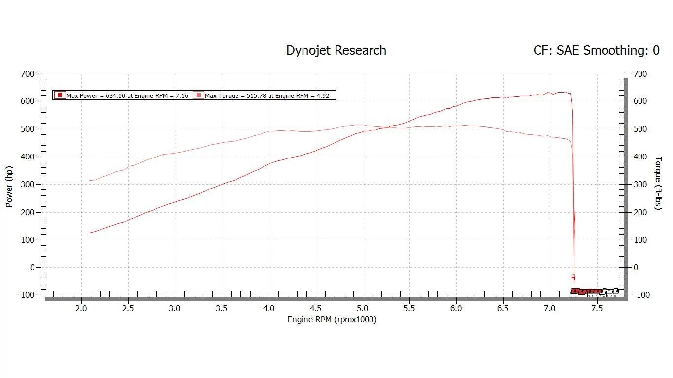

Let be honest though for others considering a blower in a hot climate. You will be better off with a centrifugal and a large front mount intercooler that keeps intake temps near ambient, rather than rely on a PD with a small chargecooler sandwiched between the blower and lower intake manifold (i.e. in a very hot place).
Horsepower and torque differences between a PD and centrifugal blower are modest anyways beyond 3500 RPM.
Case in point are two graphs below. Stock cars minus mid pipes. Yes, different dynos so don't focus on the ultimate numbers, but the curves.
Whipple Stage 2 with Whipple tune and 94 octane

Procharger P1-X Stage 2 Custom Tune 93 Octane
I tend to agree. I’m not a brand loyalist. The only thing nice about the TVS, is the fact it’ll launch hard without a stall.
