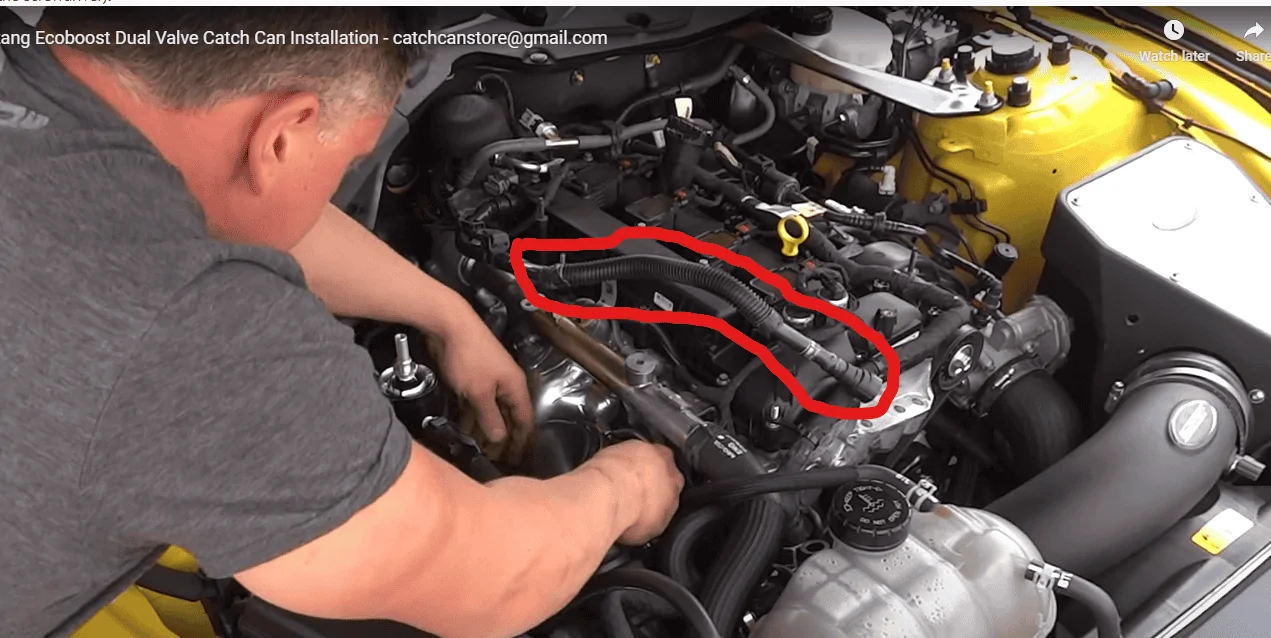

I'd recommend lifting the car for the install, that's really the easiest way to do the install. If you don't own a lift/jack your next best option is to remove the intake manifold.
If you don't want to do that either like I did, you could try and get it loose from the top. But be ready to swear a lot lol. You can only reach the bottom pins this way so just push those up with something as hard as you can. Ideally you want to press both of them at the same time because if you press one up the other side goes back down.
I'll post some links of video's I watched before doing the install.
The install from the top like I did (without the screwdriver):
Tips on removing the clips:
