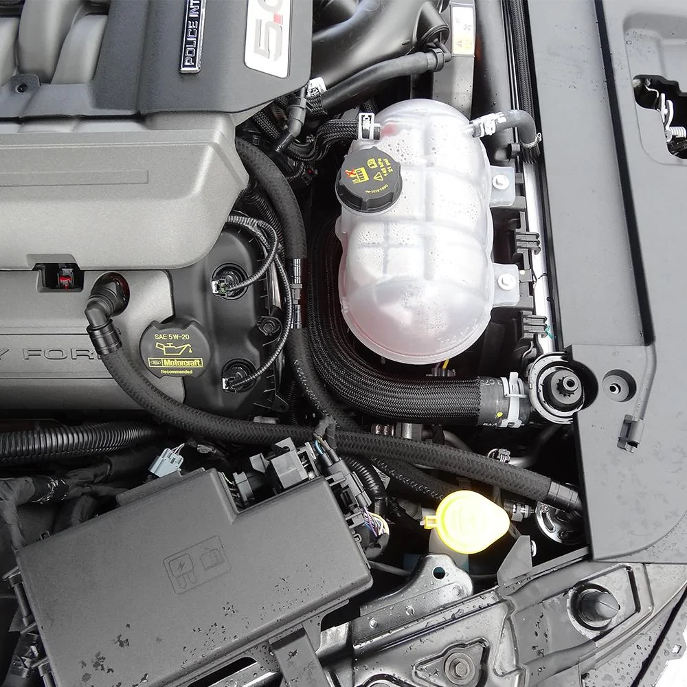

Anybody have pictures of their setup installed. Hoping to install this tonight if I can get some garage time.

So if we have this one it won't work? What will I need to make it work?

No. The can is the same but It will mount on the driver side as shown the pictures I posted and it will need different hose length along with the CSS for the driver side valve cover.

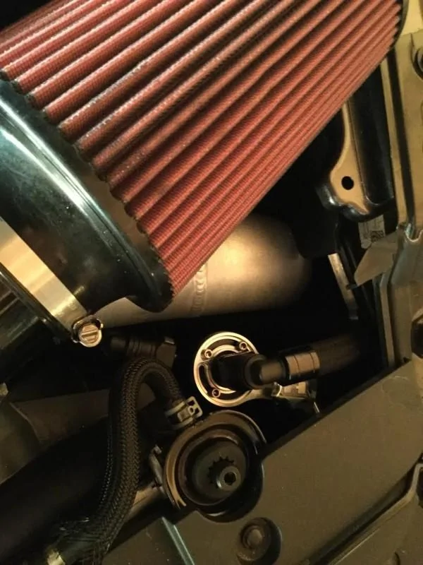

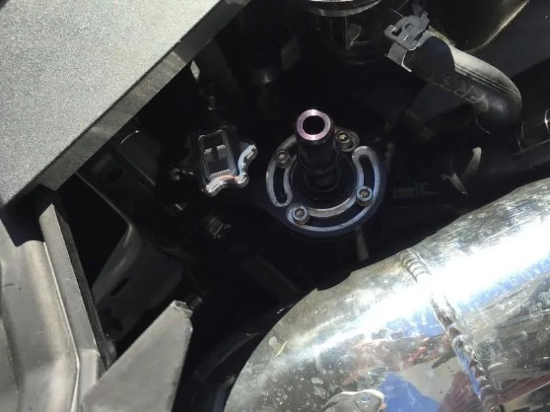

What is the mounting bolt threading in to on the driverside?

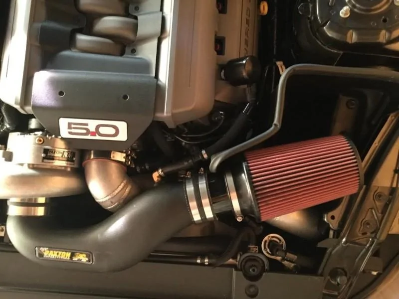

Check valve goes from the side of the can towards the intake? Arrow pointing towards the intake?

Yes... Arrow to the intake manifold. And it threads into a hole behind the drivers side headlight area.

Done and done. Think my upper hose maybe could be routed cleaner but I can handle that latter.
