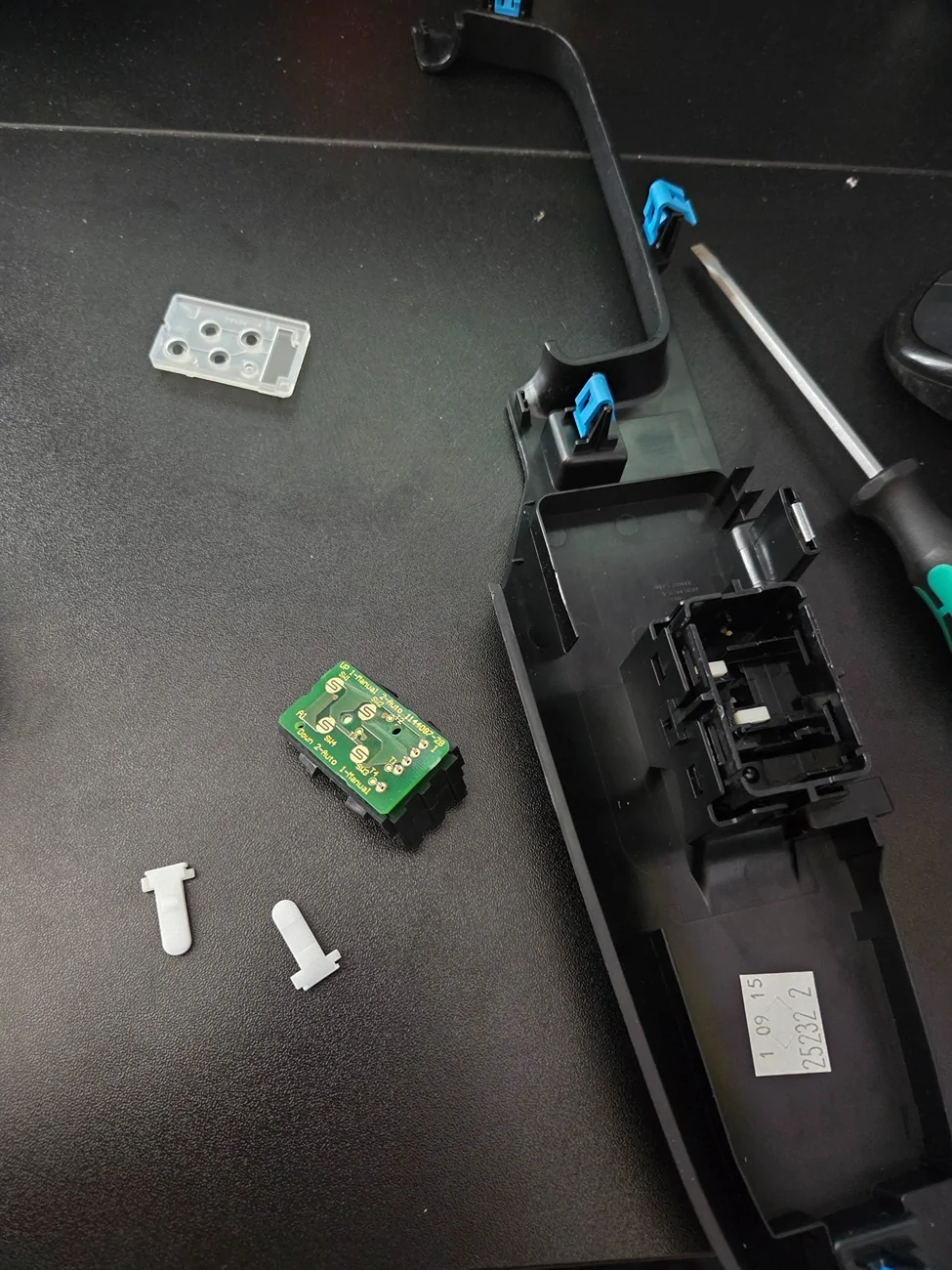

So I was taking apart my door panel today for some speakers. My passenger window switch was very stuck. When I finally got it out the switch came apart. I ahve all the peices, but I have no idea where these white plastic pieces go. It seems that without these the button is completely slack. See picture below.
Any input would be great.

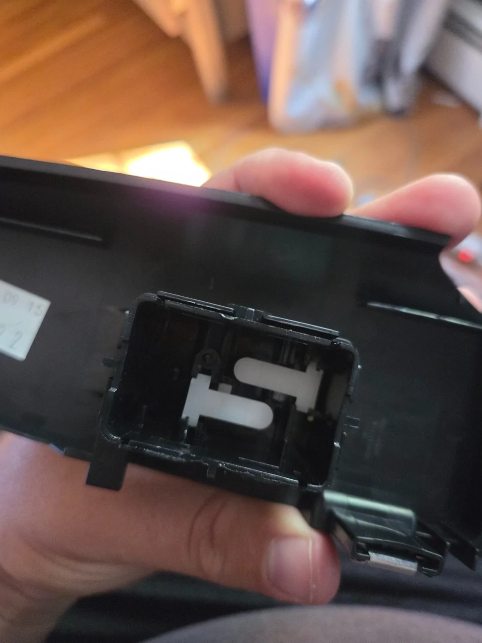

Well after a bit of looking it I figured it out. The white pieces go on their side into the plastic housing and fit into a T slot.

if it was loose enough to 'fly apart' how did you get it to stay on reassembly?
jono12345
Sep 26, 2020
233
234
Massachusetts
2015 mustang gt
It just snapped back together. Idk how it came apart since I wasn't actually prying on that specific section. But it did, and parts went flying.
