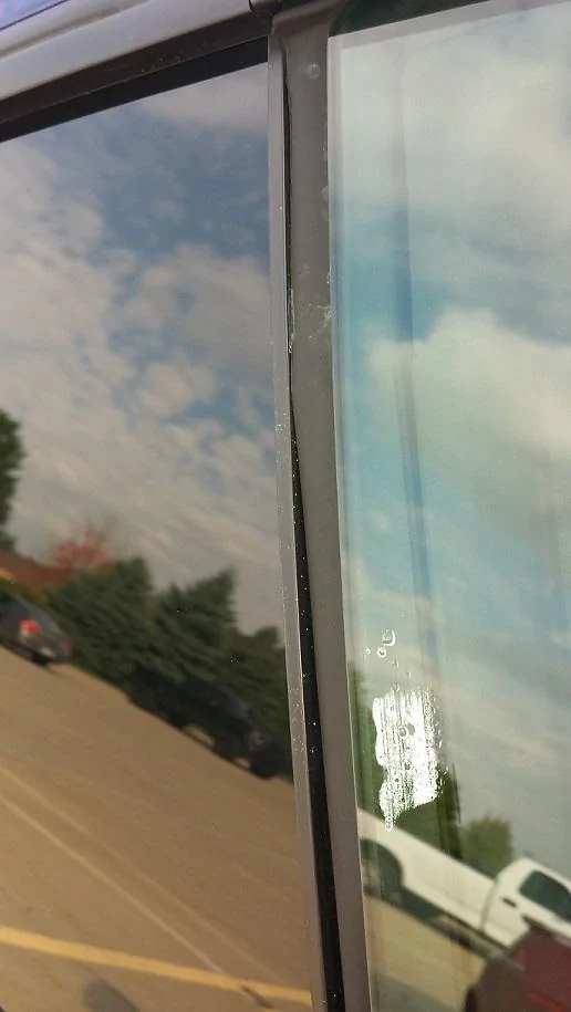

I'm still under B2B warranty and haven't taken the car in yet, but is this was the TSB issue is for? I don't notice wind noise, but moisture ingresses past the first window seal, luckily stopped by the second seal. The photo is of the passenger's window.
[MENTION=19075]jcasti07[/MENTION] check you window seals are fully seated, this one is not and it's taken a set so it doesn't want to stay in place.

The TSB was not for this issue.

Dealer told me that the weather strip lost grip so they ordered another one and will install soon under warranty. Thanks for the replies
