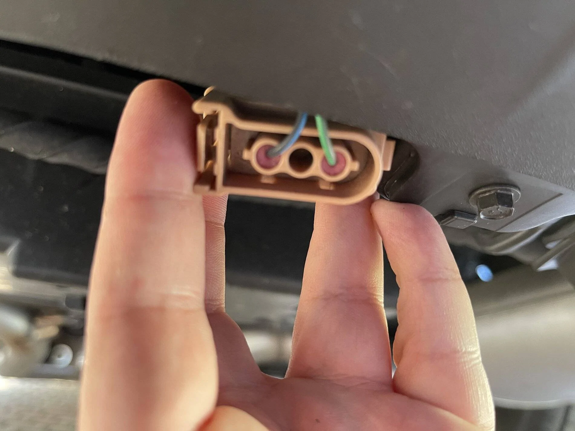

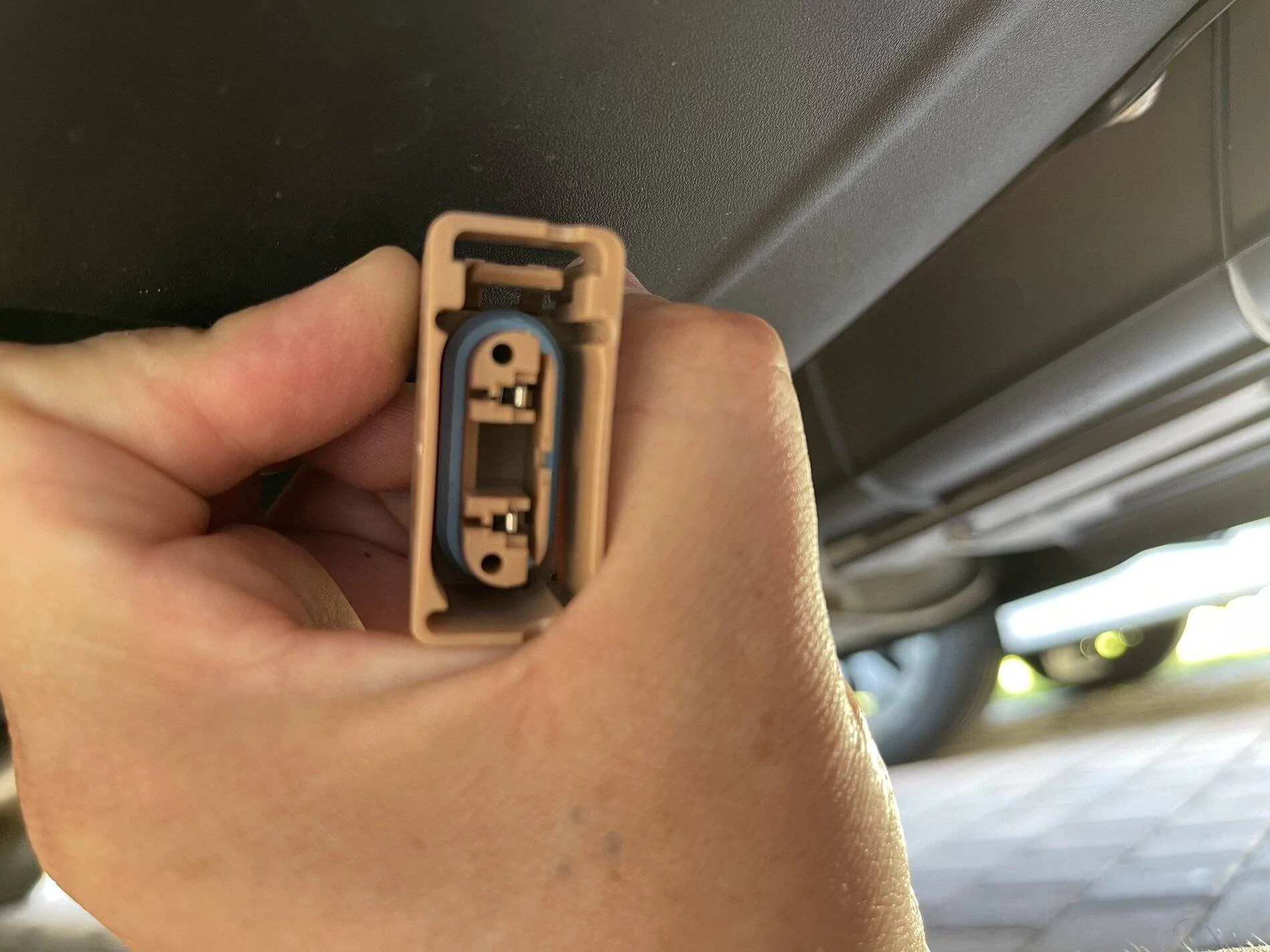

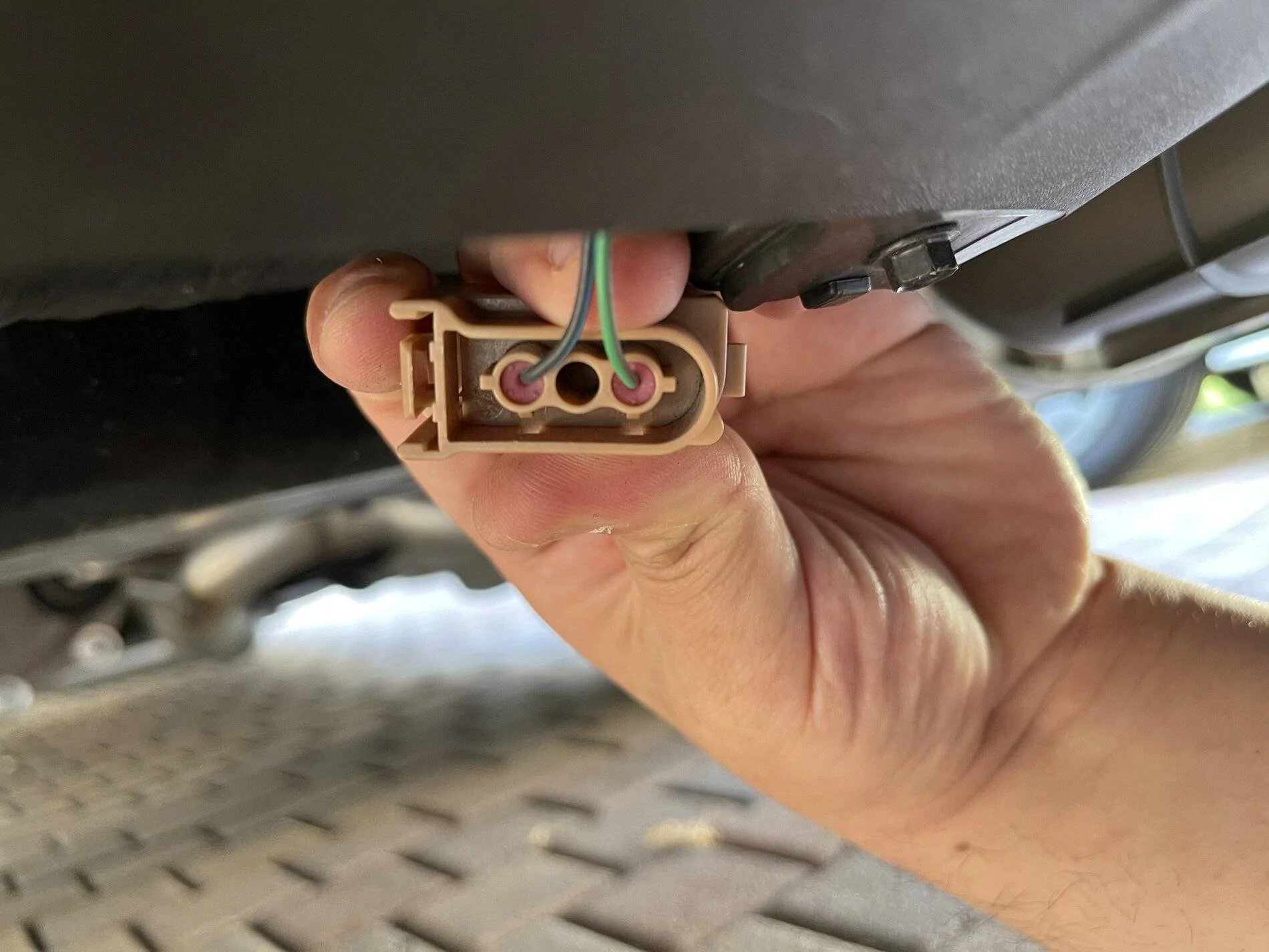

I need some help locating a part. I had the Diode Dynamics 4th brake light on my 2020 GT but now I have a 2021 GT and there are some differences on the reverse light plug, the middle has been sealed so I cant run the wire through (see pictures). I contacted Diode Dynamics to see how are they selling this kit for the 2021's when the plus is different. Their response was sorry contact the seller. Can someone tell me what part number is this for the 2020 GT.
The first 2 pictures is the plug I need and the last pictures is what the 2021 GT has

I can find the socket part number, but not the connector. The connector is going to be a part of the trunk harness.
Your best bet is to call your local Ford dealer and ask if they have a pigtail connector for the reverse light for a 2020. If they do, it will have to be de-pinned and repinned back into your car, if it'll fit the same. Not sure why they changed it for that year.
