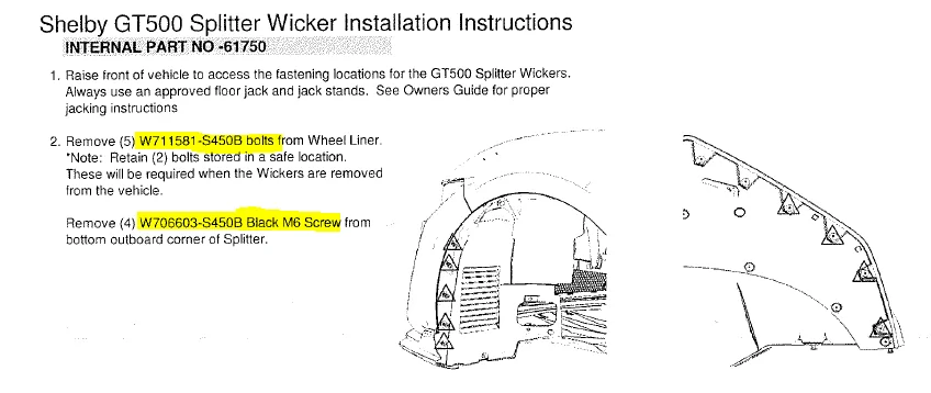

Does anyone have the PN for the mounting screws etc? Mine are missing a few and I’d like to get them. My local dealer wasn’t too helpful

The screws that secure the winglets
To the wheel well and underneath the car. My car is missing multiple screws on the underside were secures to the vehicle

Not sure what harware you are missing, but this should get you what you're looking for.
