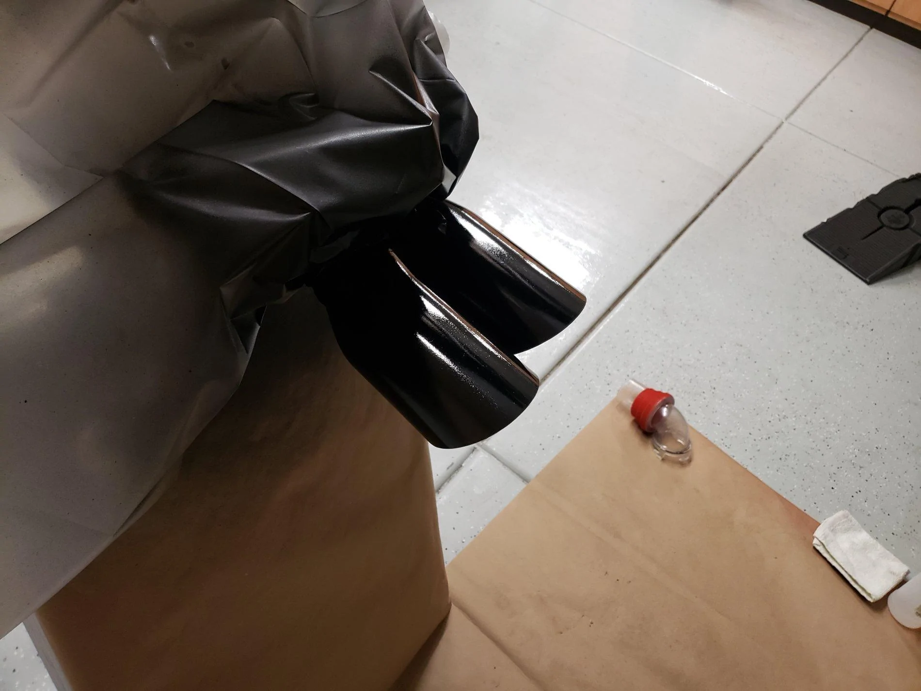

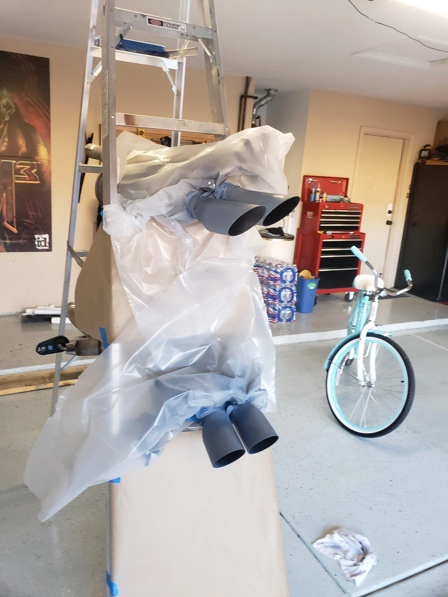

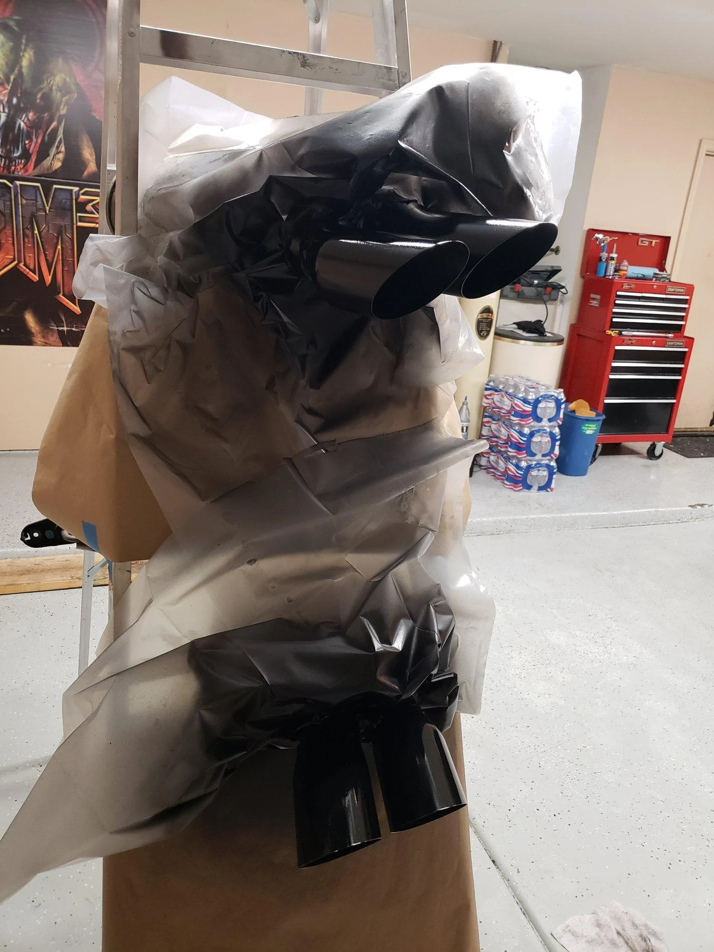

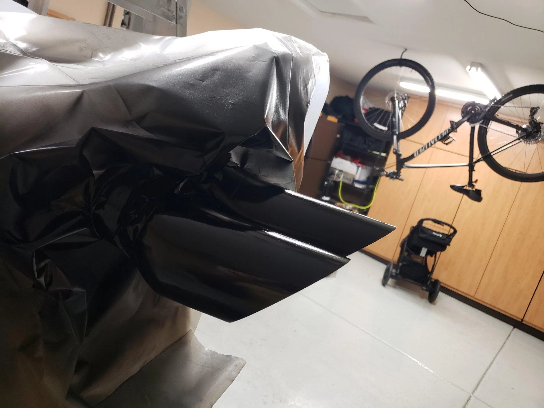

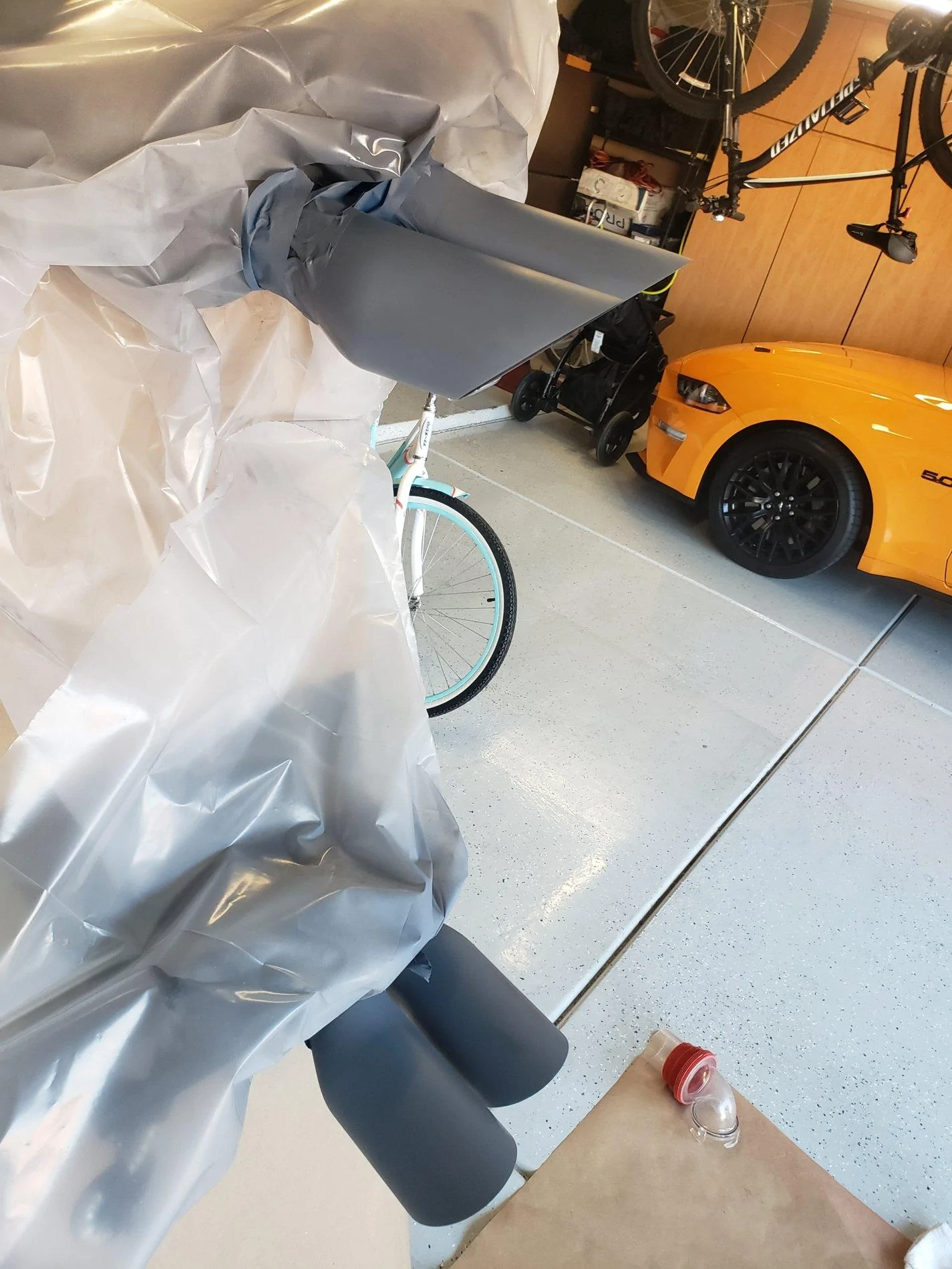

We will see how this shit turns out. I'm really good at messing up anything with paint. I did a 120 grit sand, then a 180, then 2 coats of primer. Waiting for it to dry right now before I do a coat of gloss black. Stand by for more pics.

Problem is, I don't want to disassemble the active exhaust. I'll seev what this looks like in a few hours lol

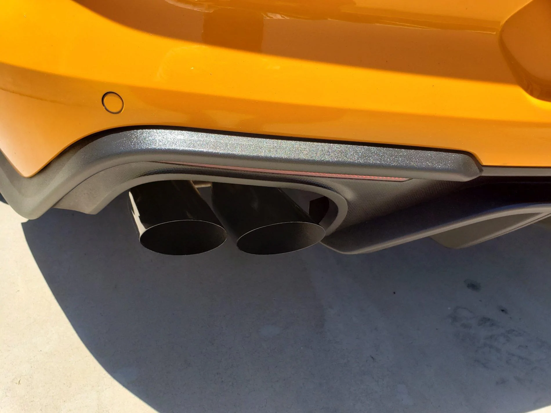

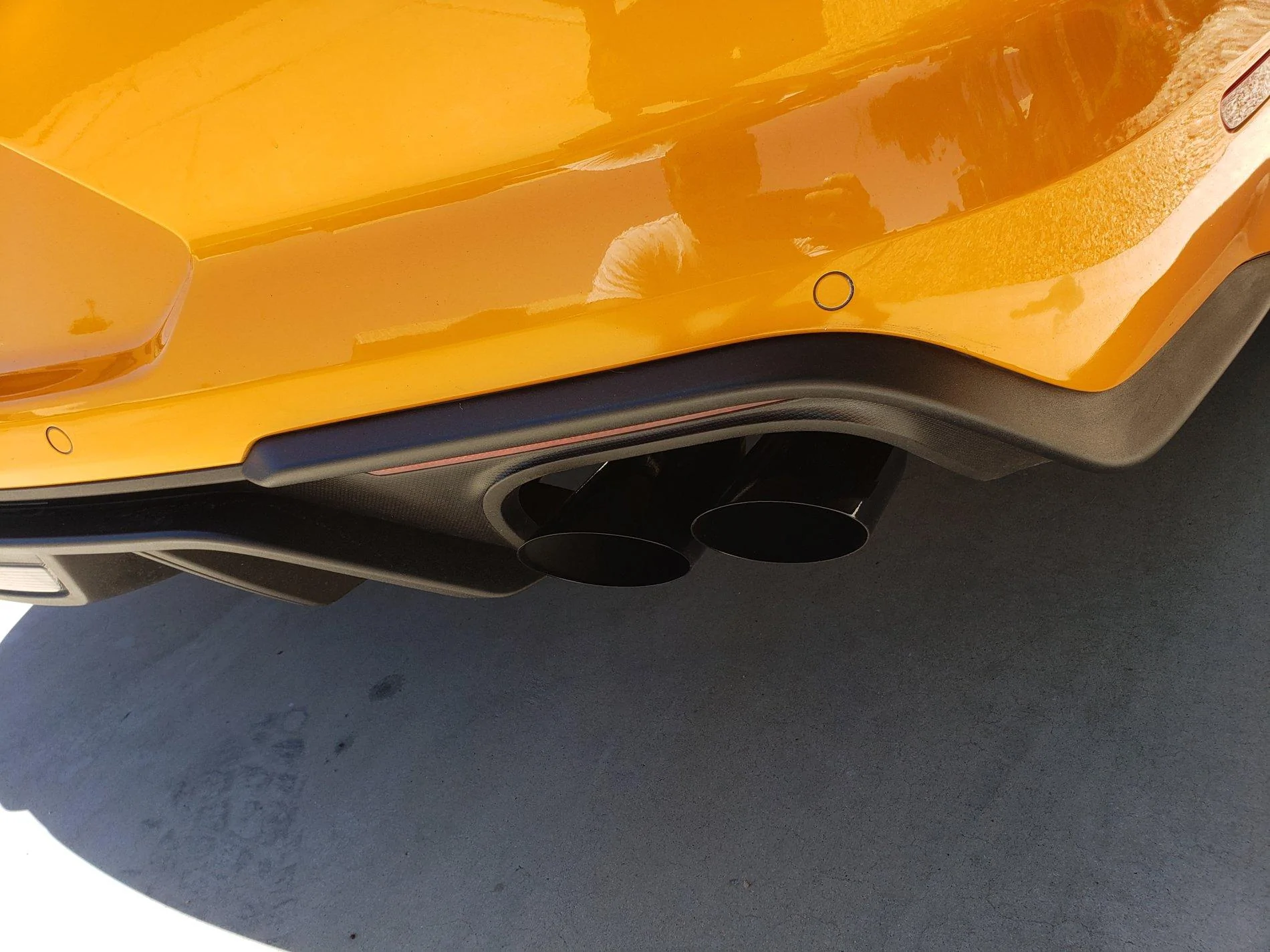

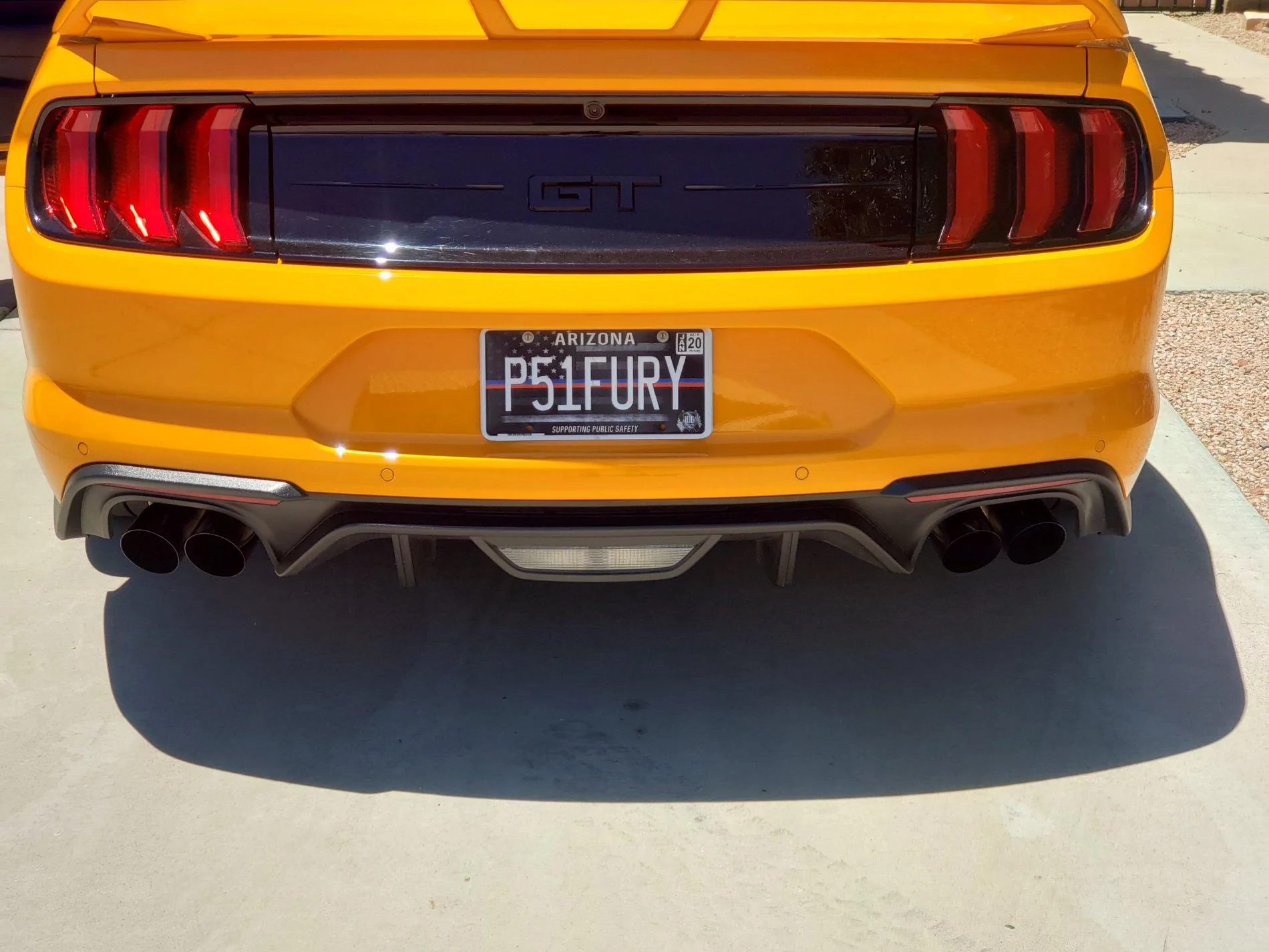

Looks good, lets see how it handles the heat, probably fine since carbon coating will act as a shield anyway for the outer layer heat wise.

I'll update in a year. I do a spirited drive through the backroads up here once a month, so this summer will be a test of it.
