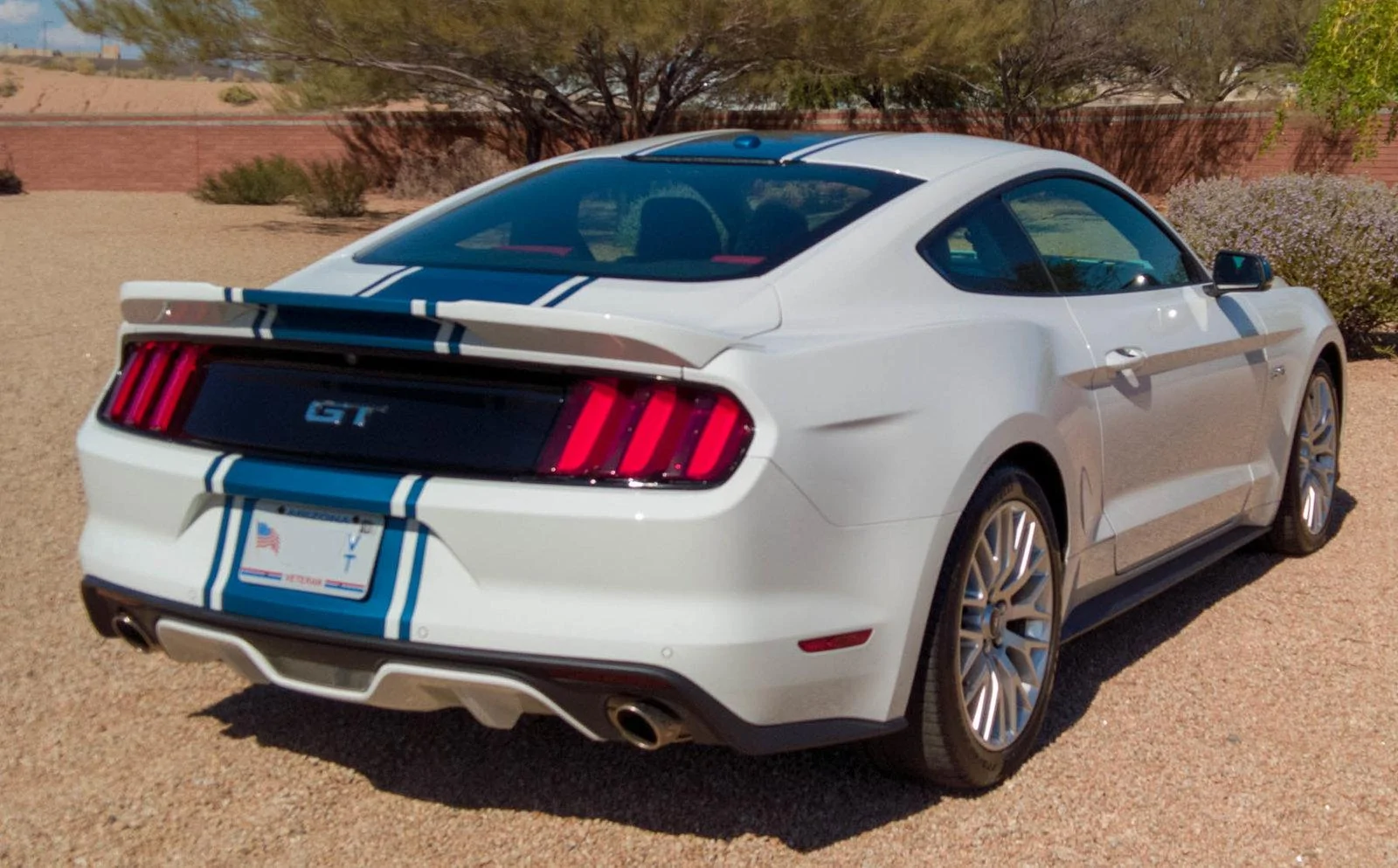

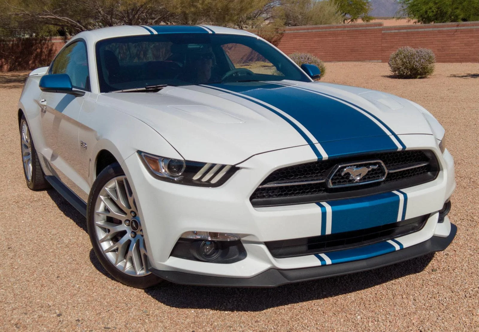

Yes, you can paint stripes over the factory paint. That's what I had done. They scuff up the factory clear for the entire panel that will have stripes. For the best results they have to remove the bumper covers and everything attached to them. Likewise, anything attached to other panels that get stripes, so things like hood vents, antennas (which means getting behind the headliner in the interior). Then they lay down the stripes. Then they clear those panels and reattach everything.
As noted, it will be much more expensive than vinyl, but it was worth it for me. You have an unlimited choice of colors and there is no special care for the stripes. There are numerous threads about vinyl stripes that were damaged by birds, tree sap, the wrong wax, etc.. For things like rock chips, you can use touch up paint with painted stripes; with the vinyl, you live with it or replace the vinyl on the panel. On the down side, this method of painted stripes means they must be the same gloss as the panels the stripes are on. So, no matte, etc. (unless you want the whole panel matte).
But you better be sure you get the color right. If you think painting the stripes is expensive, think about having to do it more than once. I agonized over the color for months and changed my mind six times before pulling the trigger.
