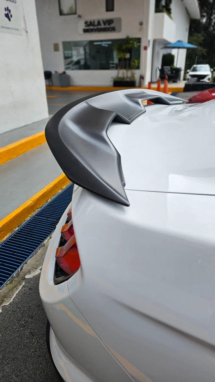

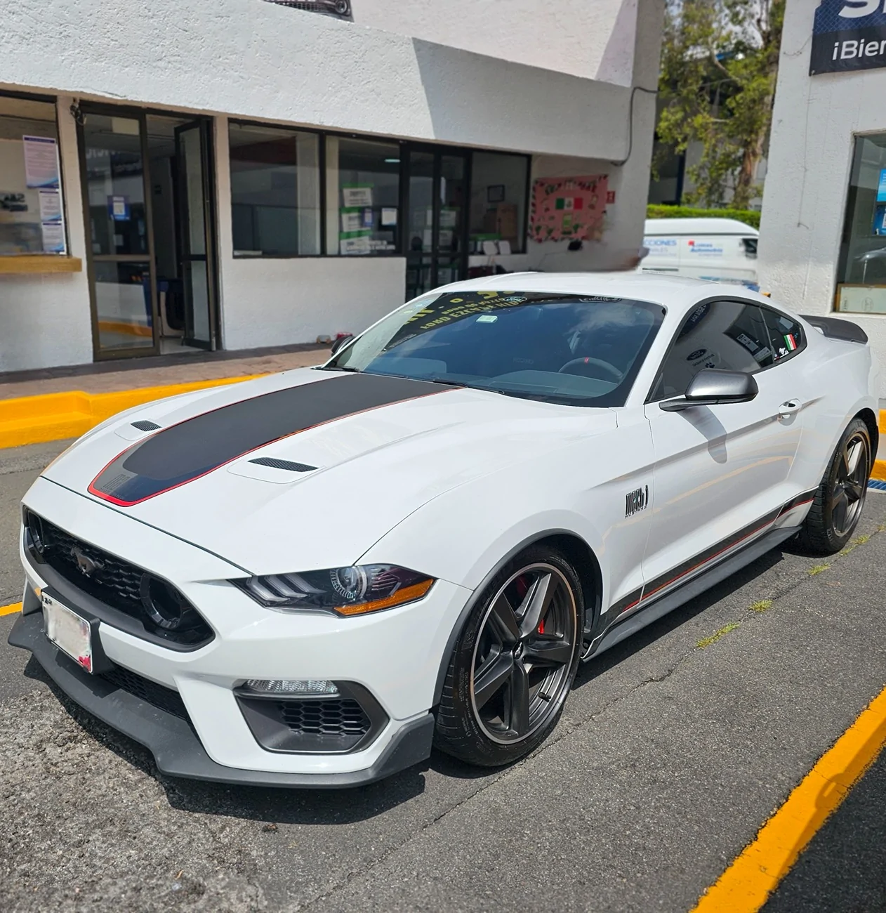

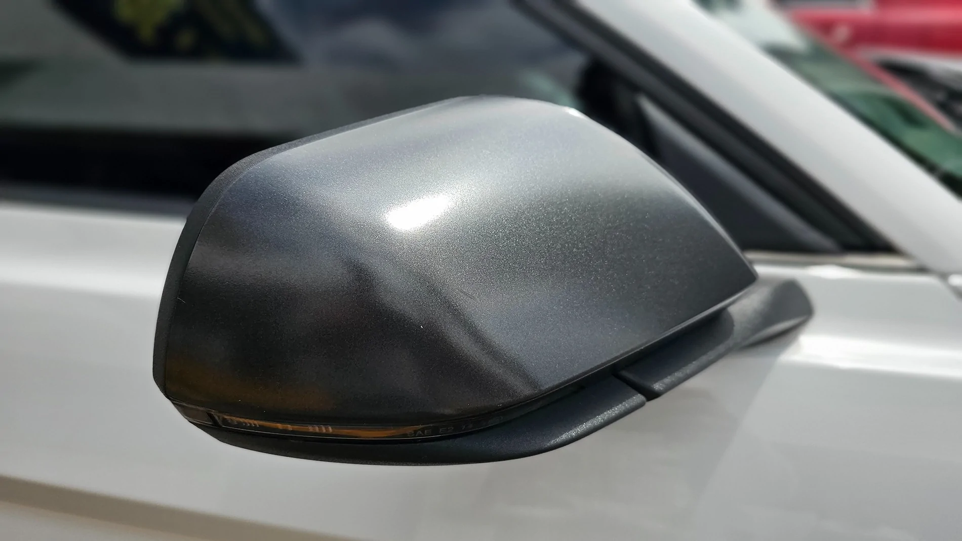

Could anyone find the correct paint code for the rear spoiler?
The magnetic, looks to me a bit different vs the mirrors

Magnetic Metallic Color code is 5FM6 or J7 and finishing is satin clear.
Ford touchup pen PN J7 PMPC-19500-7325A
Dupli-Color EAFM04170 Scratch Fix All-In-1 Exact-Match Automotive Touch-Up Paint – Ford Magnetic – 0.25 oz. Paint Pen, 0.5 Fl Oz
