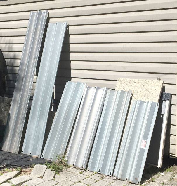

Jim: We too are in a good area for solar but I'm picky about "stuff on my roof." Nearly always eventually leads to leaks. Plus, the power here is pretty cheap.
Definitely a good idea to put in the backup generator/alternator and believe me, the galvanized and Lexan shutter panels are a breeze to put up and take down...ground floor, that is. Second story a little more difficult. I waited too long and dealt with plywood and those damnable clips for years.

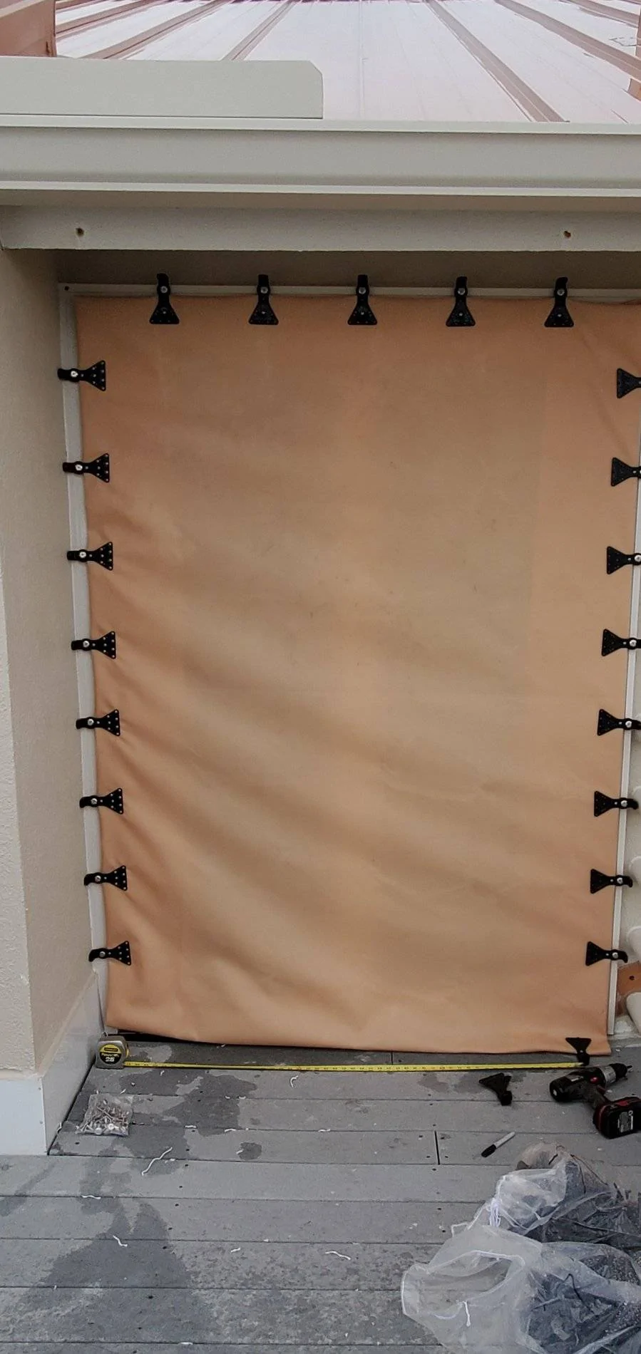

When I build my new house next year, the plan is to install 20 kw generator, storm shutters and possible solar panels.
Not sure about the solar panel idea yet but will wait and see.
Get impact and never look back. Us old farts need to stay off ladders as much as possible these days. Yet I continue to find myself on top of a ladder.
Another option is hurricane fabric. I have all impact, but on the upstairs sliders, the dynamic pressure of the wind keeps the rain from draining out the gutter. A lot of water accumulates because it cant drain. Even though they are impact, the fabric provides a water barrier so that the rain cant build up and collect in my sliders gutter.

Those certainly look safe and, easy to store, Tom but it does look like more work installing than my stacked sheets of galvanized. Most windows at Casa KB are tall front windows and they require six panels horizontally with a wing nut at each end. Very easy.
And as you know, what the most depressing parts of living through a hurricane is being in the dark. You don't have that problem but someone without a gen would wind up with a totally dark house using those shutters you showed...UNLESS they also let light in, which they may very well do. I have some windows where I use clear Lucite panels that let in light and, can be seen through.
These are what I purchased:
Yes, the hurricane fabric does let some light in. Good enough.
They go right on and come right off, with 1/4-20 sidewalk bolts set in recessed female fasteners. When not in use, the female portion of the fastener is covered by a nylon push in screw which models itself as a 1/4-20 screw. I didn't want to have studs sticking out from around my door, but that option is available and less money too. They say the hurricane fabric is stronger than the panels, its supposed to be made of Kevlar or something. Again, I bought it for water resistance, not so much impact resistance. The only other concern with the fabric is if your windows are flush with the outside of the house. Think of the fabric as a net. Something hits it, and the net will absorb the impact, but will have to give a bit and move inward. If non impact glass is right up against the fabric, I think the window would break. I don't think it would be a factor if your windows are recessed inward from the side of your house.
