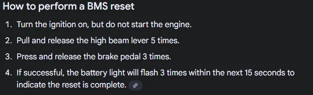

Probably needs a new battery. Or at a minimum, charge your battery completely, and then perform the BMS reset procedure

Probably not enough. The BMS system can sometimes drop the alternator output down to battery voltage, but shouldn't be doing so if the battery's state of charge were very low. Did you reset the BMS system after you installed the new battery?
You can unplug the BMS sensor and see if the alternator output goes up to 14 volts. If the alternator output stays at 12ish volts, you probably need an alternator. Check all your fuses too.

I was questioning the alternator but wasn’t sure if that was the problem or not. And this may sound bad but I didn’t know you had to reset the BMS system after a new battery install since I’ve never had to install a new battery on this car until like two weeks ago.
