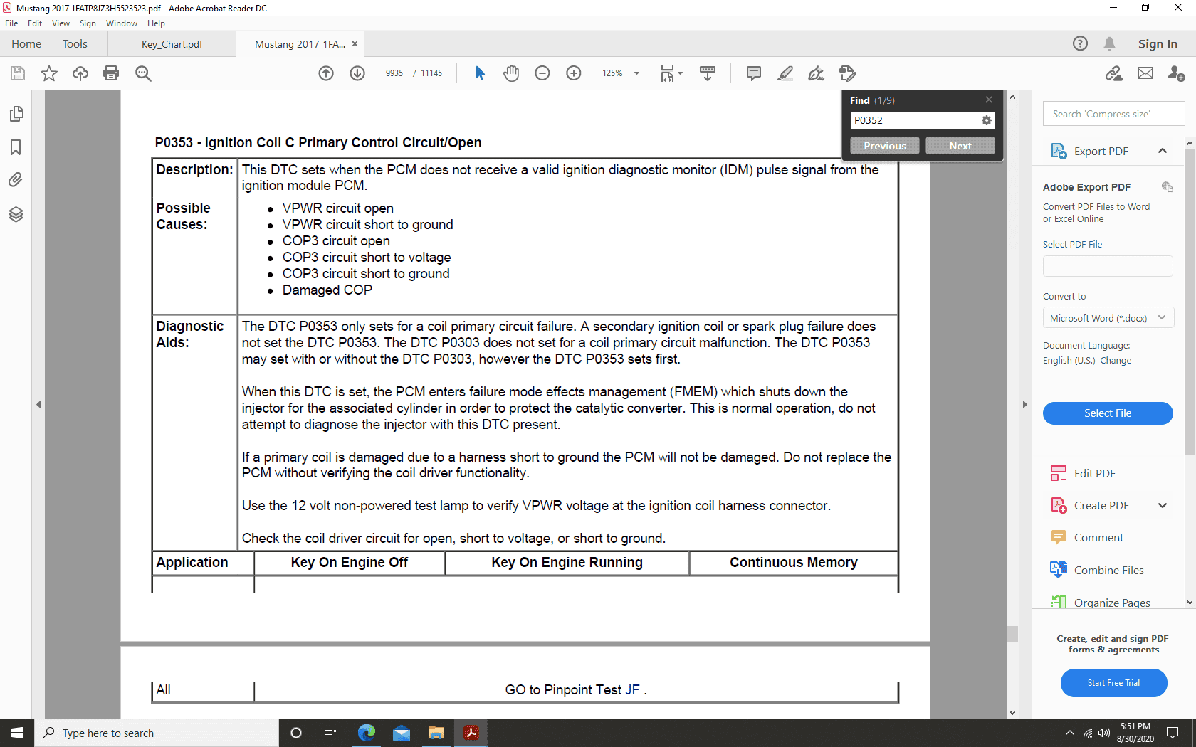

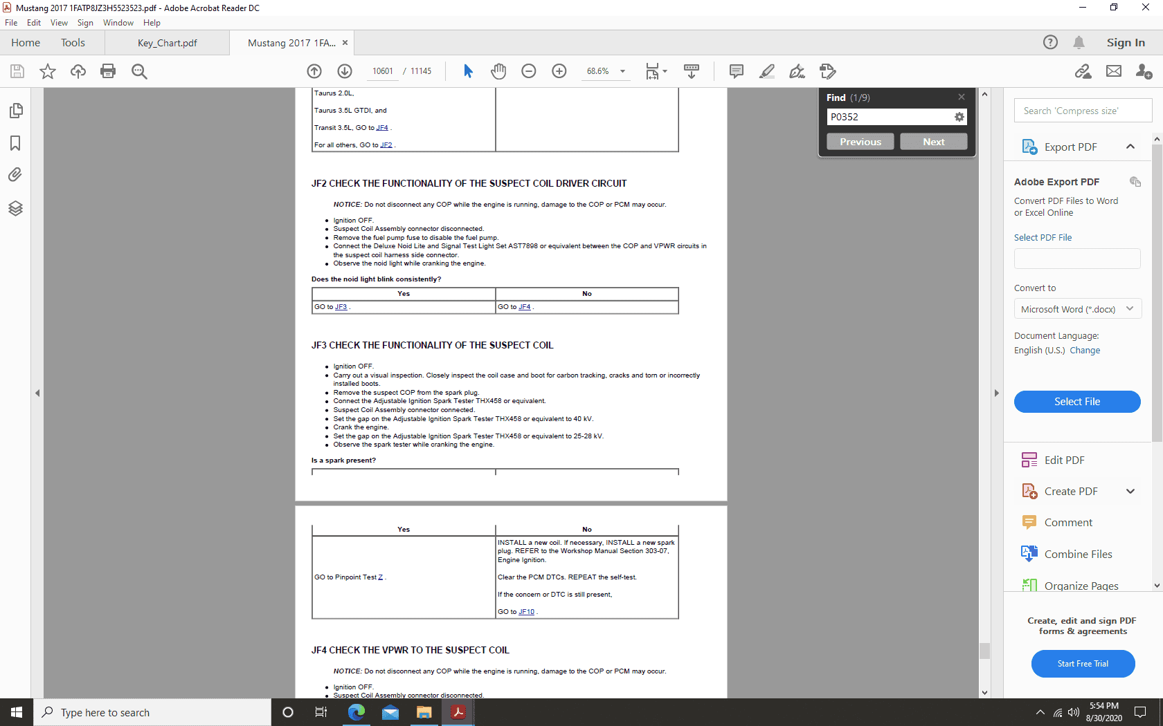

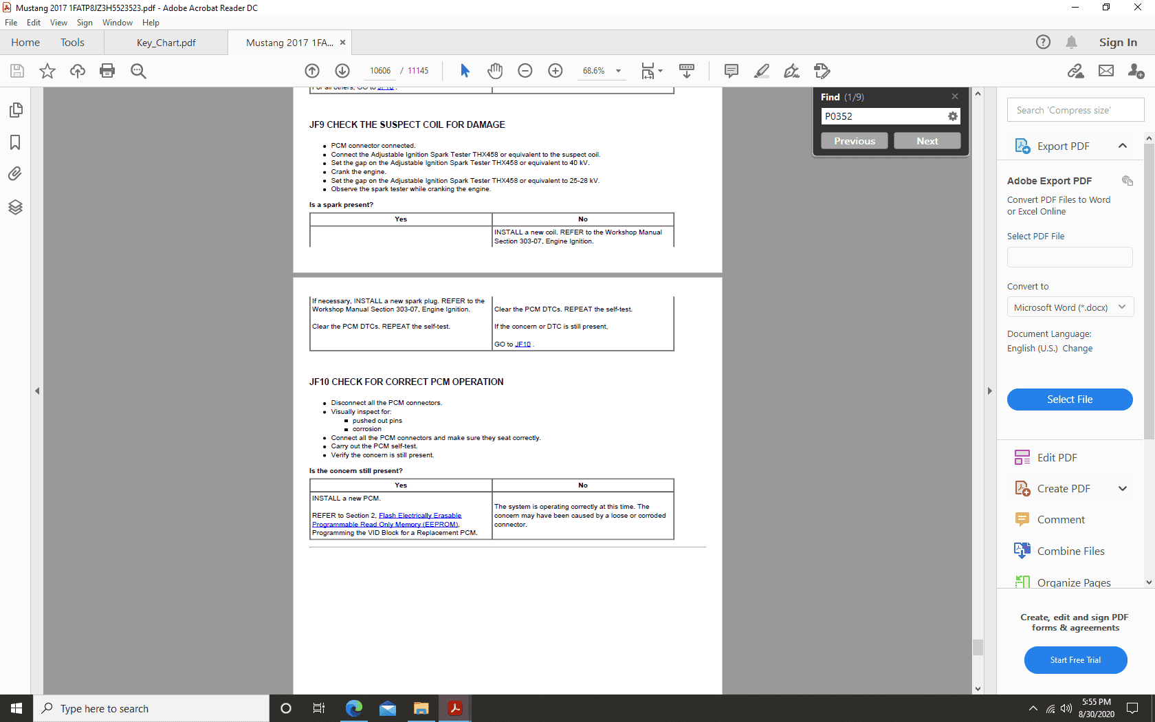

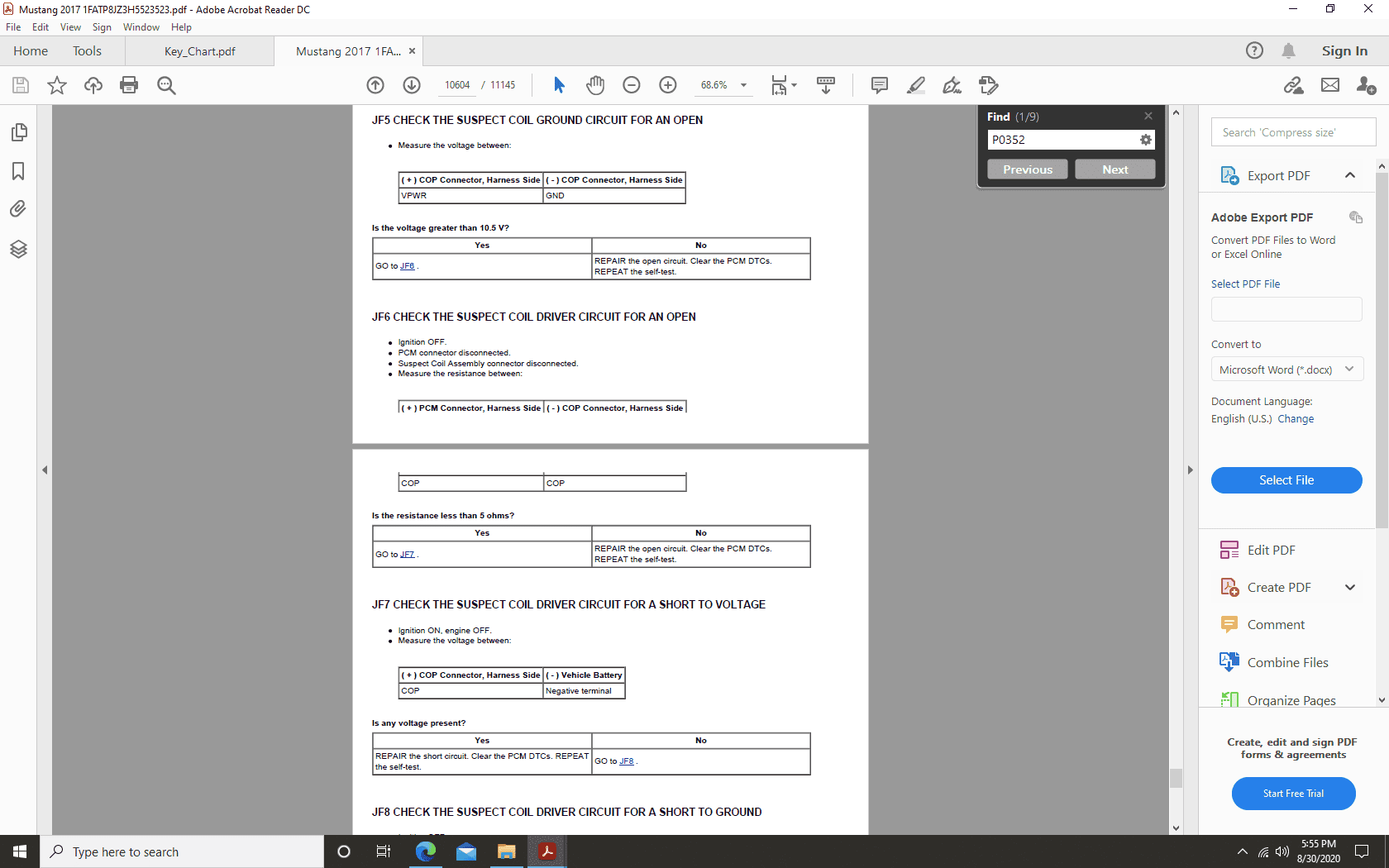

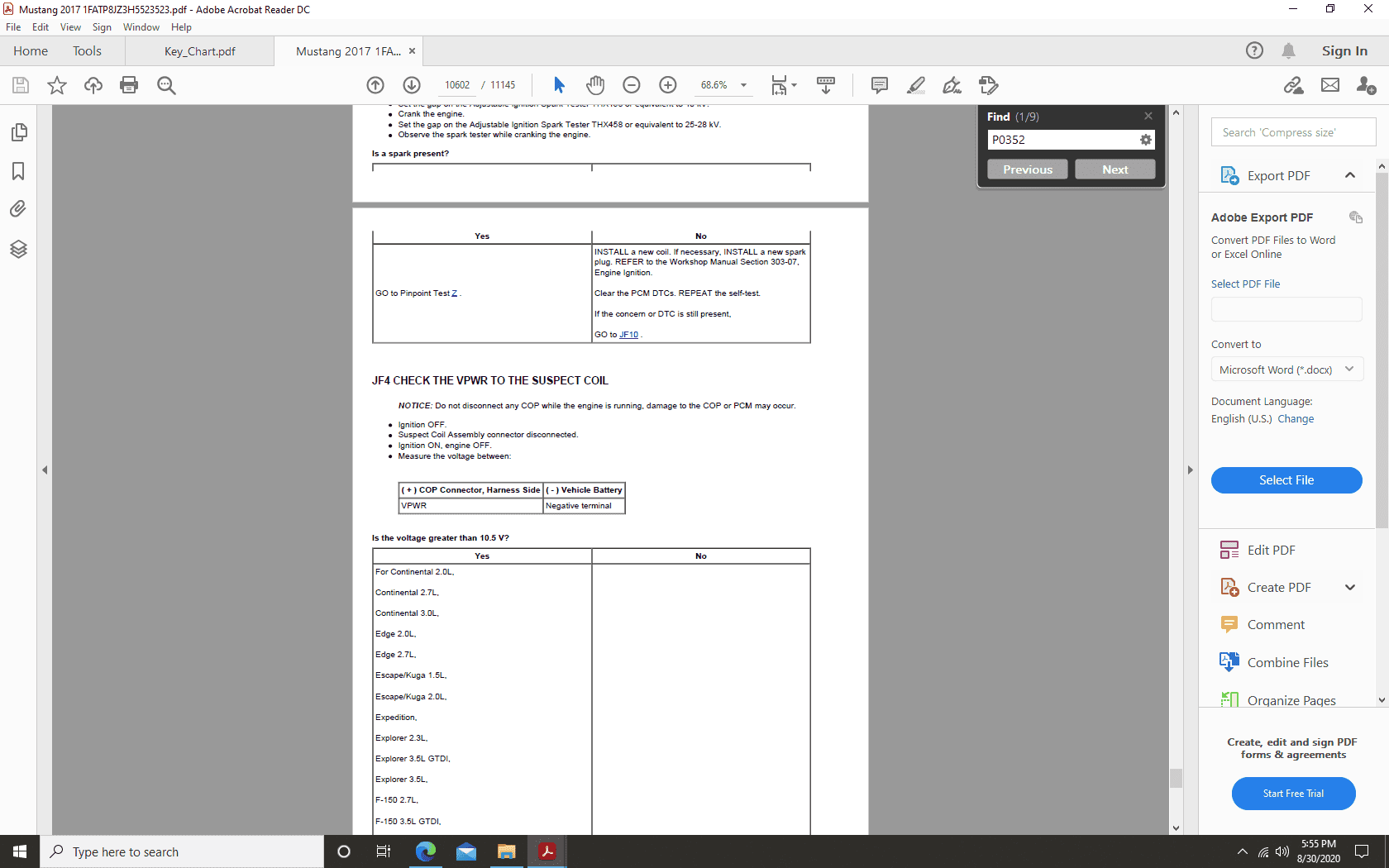

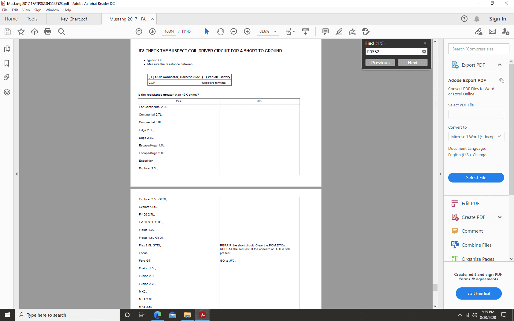

I was getting in the high rev range on a back road kinda hitting some corners pretty hard, and all of a sudden huge power loss and backfire while my foot is on the gas. Seems like a huge misfire, I took it to autozone and had the code read. They told me it was a coil pack issue and that that prob needed to be replaced. Any insight on this issue, and also anyone know what coil packs I need to get for this car?
