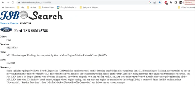

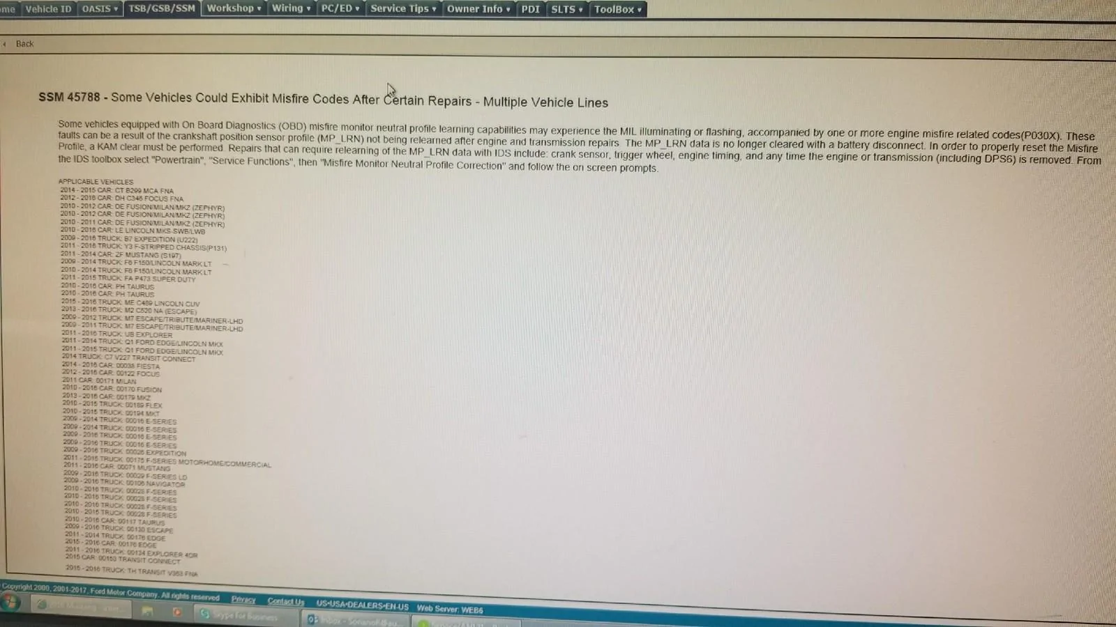

My friend is a service advisor and I called him and he found this TSB. It doesn't have the GT350's listed, but has the exact issue I'm having. Guessing maybe our cars aren't listed because they are so new.
Has anyone else replaced their clutch and flywheel and had a similar issue? The second time I got the code, I disconnected the battery to see if it would reset and relearn, and then my friend sent me this pic and it states doing that won't work. I went through the NGauge to see if there was a setting where I could reset the KAM. I couldn't find it. I hope to find a way to fix this myself without taking it in, because I know if I do, as soon as they hook it up to the computers, it'll see my tune and flag my car. It has to be something they did, because before this past month it has been with them, I've had no issues in 27000 miles and I drive my car hard as shit.
My understanding is that when dropping the trans to replace the clutch and flywheel, that the crank can be slightly rotated throwing off the timing. It used to be that it could be relearned by disconnecting the battery, but now that doesn't work and it has to be connected to the IDS system at the dealership. Not sure on this, but that's how I read and have understood it.

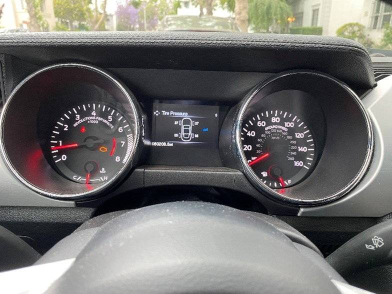

No check engine light initially, within 24 hrs check engine light came on

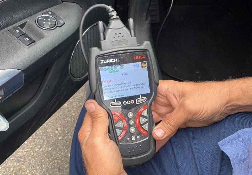

Went to mechanic. Hooked up scanner #1 (Zurich ZR15S)
I took a picture of the code: P0304 (meaning cylinder misfire in 4th cylinder) to look up later even though mechanic told me not to worry about it.
I looked it up and seemed like it was potentially pretty dangerous

Went home. No problem till next day, check engine came back on.
Later that night, I actually felt the engine misfire (before I experienced it, I wasn’t sure exactly what that’d feel like, so I wasn’t 100% sure if I’d even be able to recognize it, but once it was actually happening, I knew immediately). The feeling was like a vibrating ratatat when depressing the gas pedal, and when I felt that immediately looked at the check engine light and saw that it had began blinking. That all lasted for about 10 seconds, then it was fine again, though the check engine light was still on.

See official ford technical service bulletin (TSB) outlining the problem:
Had car towed to shop just to be safe since I’d experienced an actual engine misfire the nigh before
He hooked up the Snap On scanner above and when I got there, he said he thinks I might be right. Cleared the check engine light, then ran the profile correction.
Link vid to people running that profile correction:
Been 2k+ miles and running like a top now, no check engine light has come back, and the car is running great. Note: for a few hundred miles (about 500 or so) after clutch and flywheel replacement, there was slight shudder (nowhere even near what it was like when I first brought it in) in shifting out of first and reverse. However, have read others experienced the same break in period post clutch and flywheel replacement, and shudder went away completely by 1k miles.
Turns out then whenever transmission is removed from engine, the computers inside the car need to be recalibrated.
See 2:06 for what it looks like when your transmission Is separated from the engine to access the clutch and flywheel for replacement:
Bottom line: super easy fix, just have to know about the “misfire monitor neutral profile correction” process and send them this doc/insist that your mechanic hook his scanner up and run it, even if he’s understandably skeptical because he’s never heard of it.
