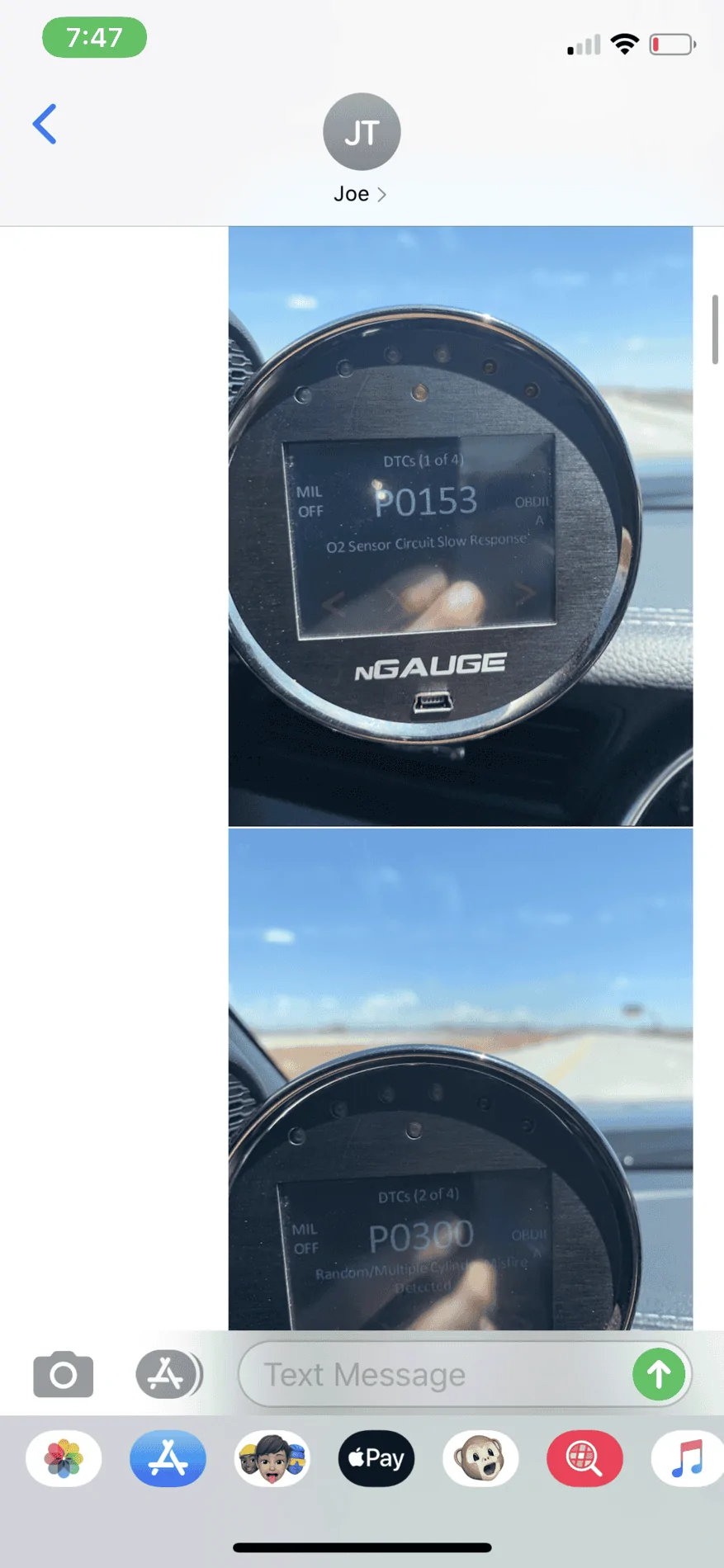

I have a 2019 gt with 5K miles on it. It’s A twin turbo car and under hard acceleration it is flashing the check engine light and throwing the p0300 (random cylinder misfire) code and also the p0153( o2 sensor circuit slow response) code. Is the misfire due to a bad 02 sensor? Do these codes go hand-in-hand when the O2 sensor is bad? Will a bad O2 sensor cause a random cylinder misfire. Any help is appreciated guys, thank you in advance!

What are the other 2 codes? It says there are 4 on the ngauge.

It Was those two codes but they weren’t illuminated, they were in gray font and not bold
