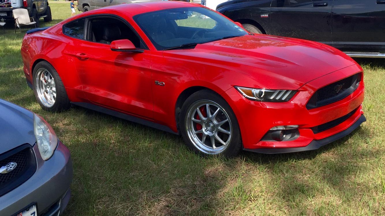

Order the splitter from Mr. Bodykit. Got it in 4 days with all the hardware and it was $85 shipped.
Did you order the belly pan too?

I wimped out though and went the CS route since it bolts right up in place of the standard splitter with no other changes or trimming needed.
Looks much better.

No I ordered the performance pack Apr splitter. Since the splitter blocks all the benefits of having the PP belly pan I couldn't see a reason to buy the belly pan.

I'm glad i changed the splitter the original was to wimpy looking lol
