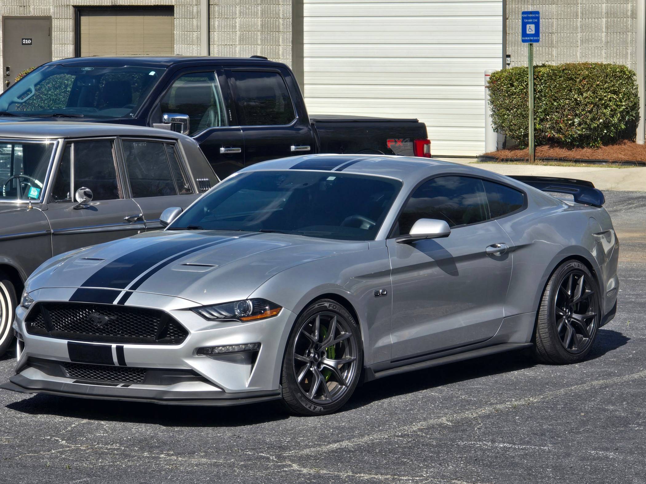

I also have a PP2 mine is a 2019 gt, I did a lot of research back when I first got the car and I went with the ford performance gt350 springs (link below), they lower the car just the right amount and they're super comfortable, my car is also a daily so i did not want any harsh springs. car looks perfect to me, wheel gap is about 1 1/4 F and 1" B...
i had them on for over 3 years no tire rubbing at all, you do have to be a little more careful on steep driveways but that is to expected, i remember when i first did it i measured the splitter height difference, it was just a little less that an inch.
