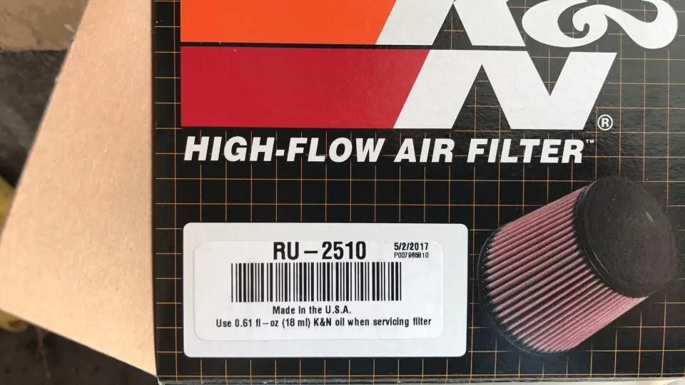

Any idea how much power this picks up or loses vs the JLT?
From my testing back to back pulls on the dyno when i had my 2200sl it was worth almost 20whp removing the jlt filter and tube and running open blower. I can only imagine the gains are bigger the bigger the blower you have. This filter is just for street cruising and looks much cleaner to me
In the engine bay. Its always off and run a bell horn inlet when racing.
