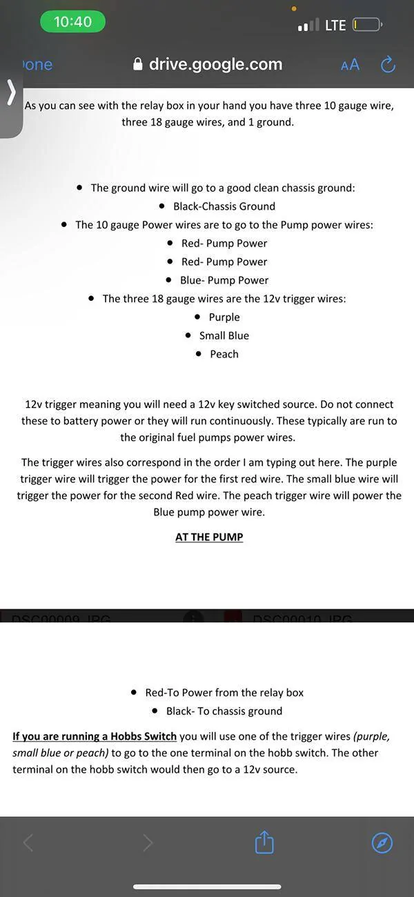

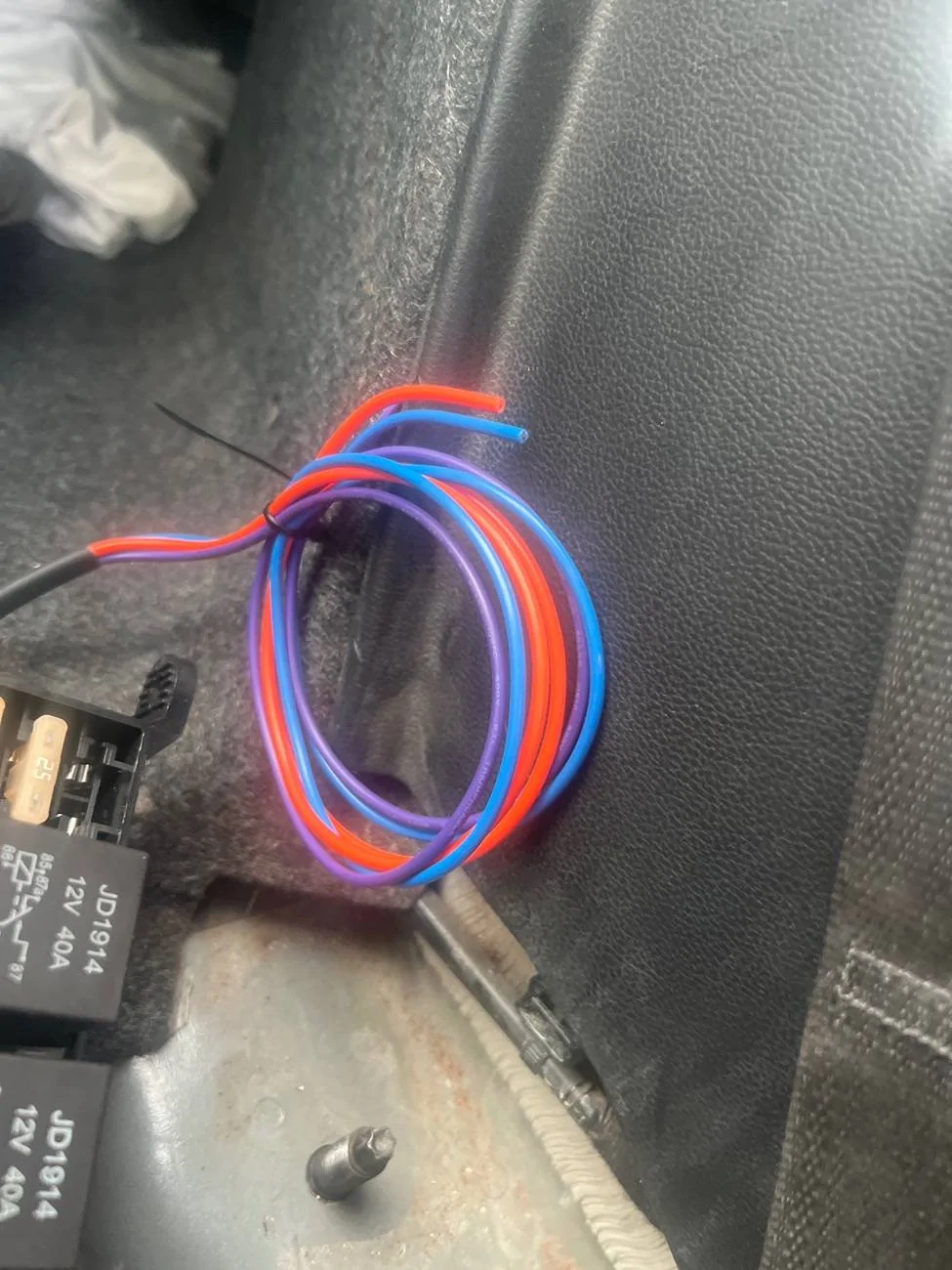

i am finishing up my on 3 return style fuel system install and i’m stuck on the wiring, i gave power from the relay to both the pumps now i’m missing a connection from the relay into the fpcm , here are the instructions from on 3
do i tie both the purple & blue into the single grey/yellow wire coming out of the fpcm ?
i appreciate any replies
