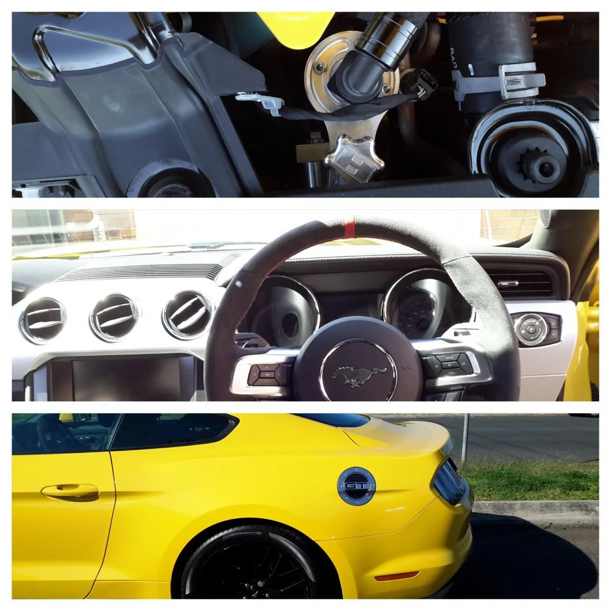

There is no need to remove the radiator cover.
Simply slip off both connections, and unscrew retaining nut.
BE CAREFUL - not has tendency to slip from between fingers and fall down onto bottom splitter tray...lol
This is the only photo I have at the moment of the catch can in situ.
Hi FPV GT, I like your fuel cap. Do you mind letting me know where you got it from. cheers, Peter
