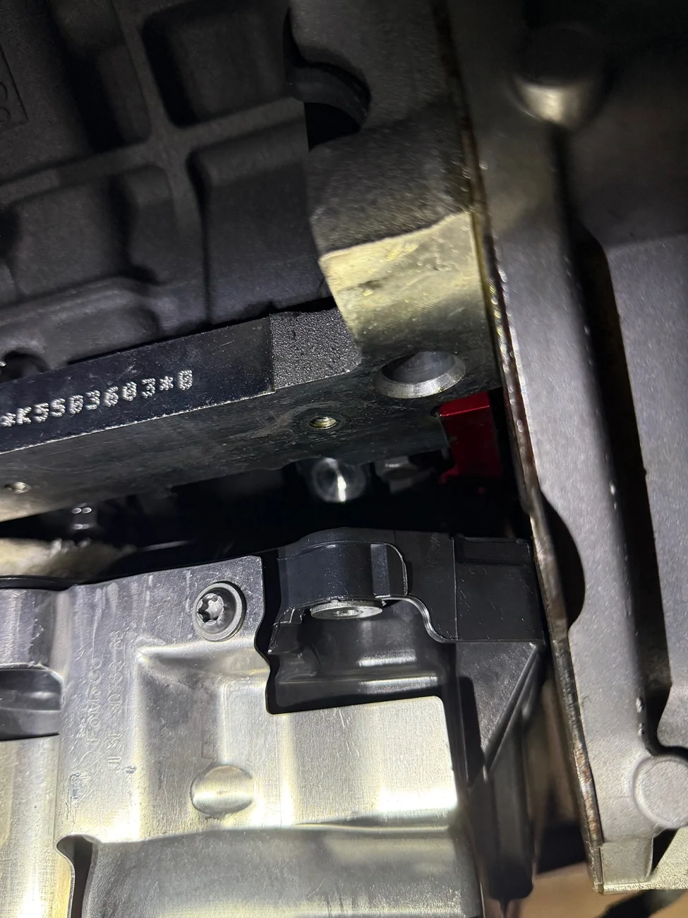

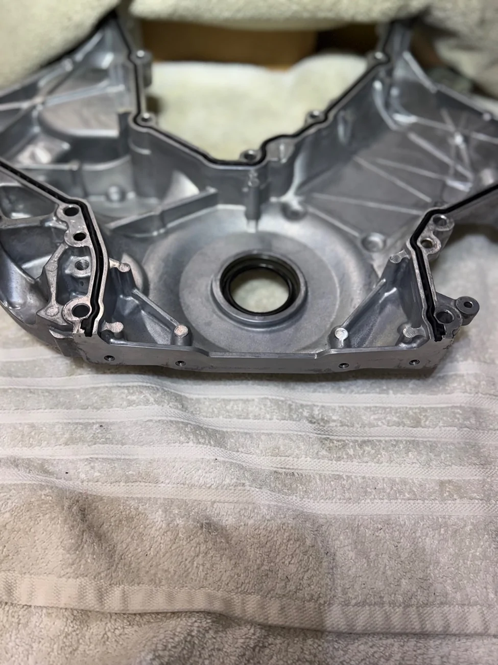

Scrape away all old RTV sealer on the bottom of the rear seal plate area and the 6 spots on the timing cover (as well as the bottom of the block and tiMing cover) before installing the new gasket. I’m right here at this step as we speak. everything is clean and ready to accept the new gasket. I think part of the problem with leaks after a pan has been dropped is failure to clean the mating surfaces and the RTV acts as a speed bump, so to speak and creates leakage.
If you need me to take any pics, let me know what you need and I can take some before my timing cover and oil pan are reinstalled. My car is also a 2019 btw.

Here’s another shot of the left rear corner of the oil pan and bottom of the timing cover. You want those areas (both sides) squeaky clean.
