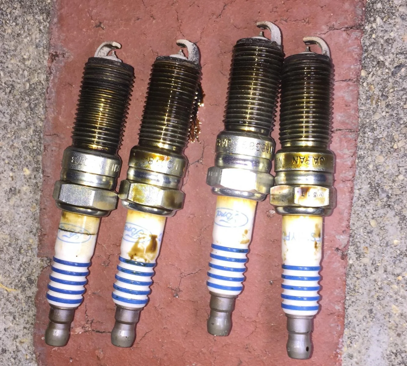

PCV working? Could be excessive pressure blowing oil pass the valve cover gasket which can be a sign of ring wear. You are going through a lot of oil.

Those are the brisk spark plugs I put in Monday. I put back the stock ones back in. Don't want ford throwing those out lol. At the dealer right now. I basically pushed the issue of wanting a new motor. I'm tired of them trouble shooting and it possibly not be the reason. I honestly think it's the rings not setting correctly. Eating 4-5 quarts every 5k miles isn't normal. So the manager basically said I should have a new motor but I won't hold my breath. And just to clarify this was a 100% stock car outside of muffler deletes. Added the mishimoto intake (fucking awesome product by the way) and catch can this past Monday.

They can confirm if it's the rings by doing a leak down test.
Yea they said they're going to do a compression test but I made sure they also do a leak down.

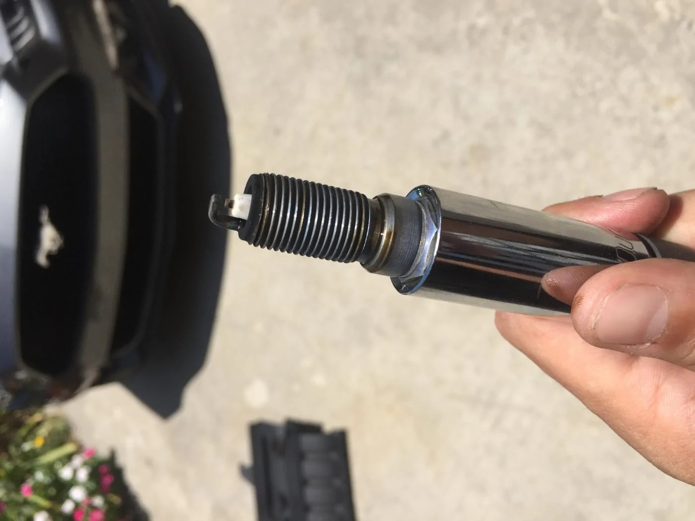

Your spark plug tips are too clean to be burning through that much oil. I think it is leaking elsewhere as well..

I changed the plugs about 100 miles ago. So the new pic of the one plug is basically brand new plugs. The original post has the pic with the plugs drenched in oil
In my honest opinion this is what I think it is.... The car was a dealer trade and whoever drove the car the 15 miles over was basically WOT the whole way lol. Yes I know new motors don't need to be broken in anymore per say. But maybe I just got unlucky and the rings didn't set correctly.
