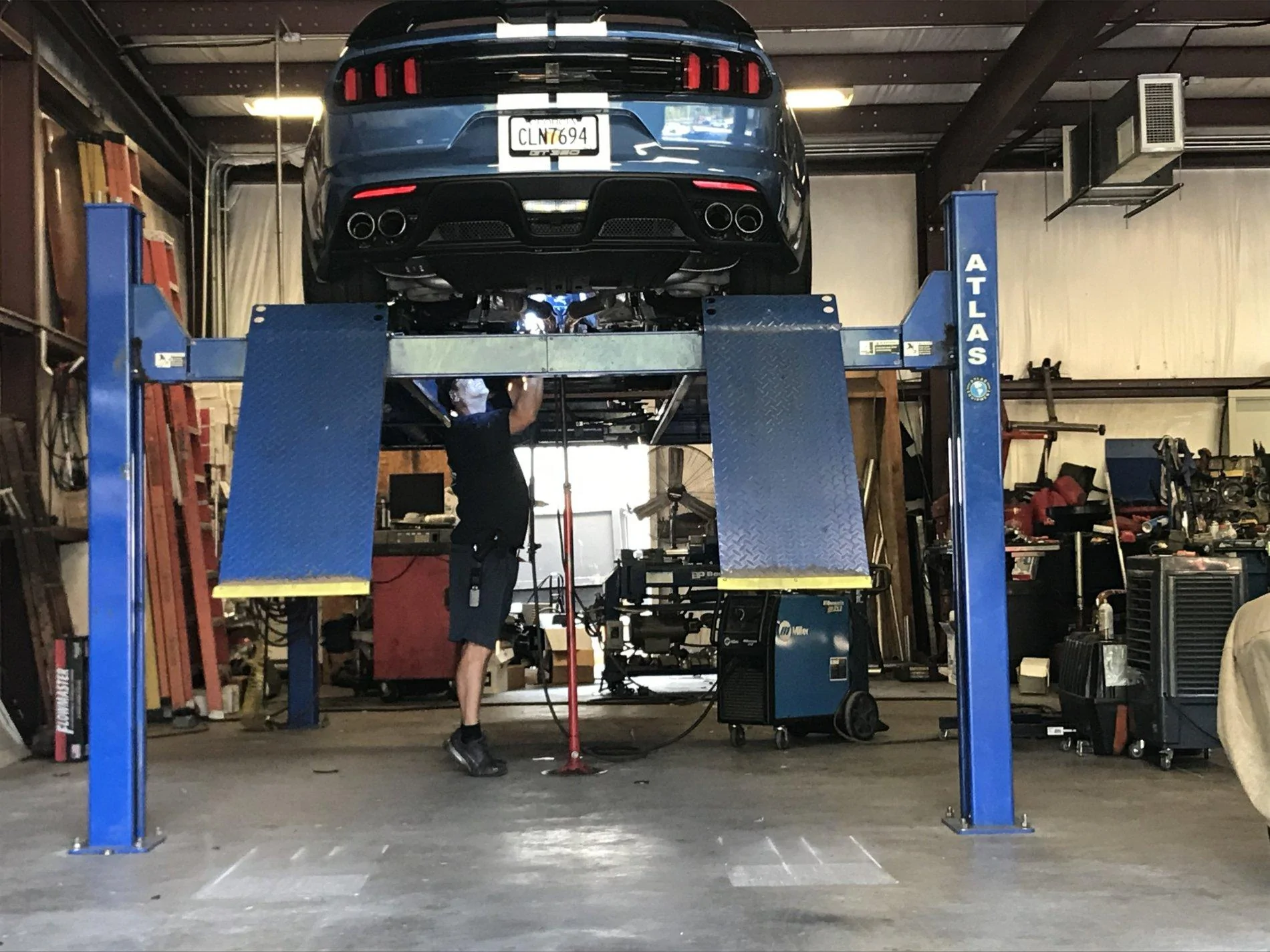

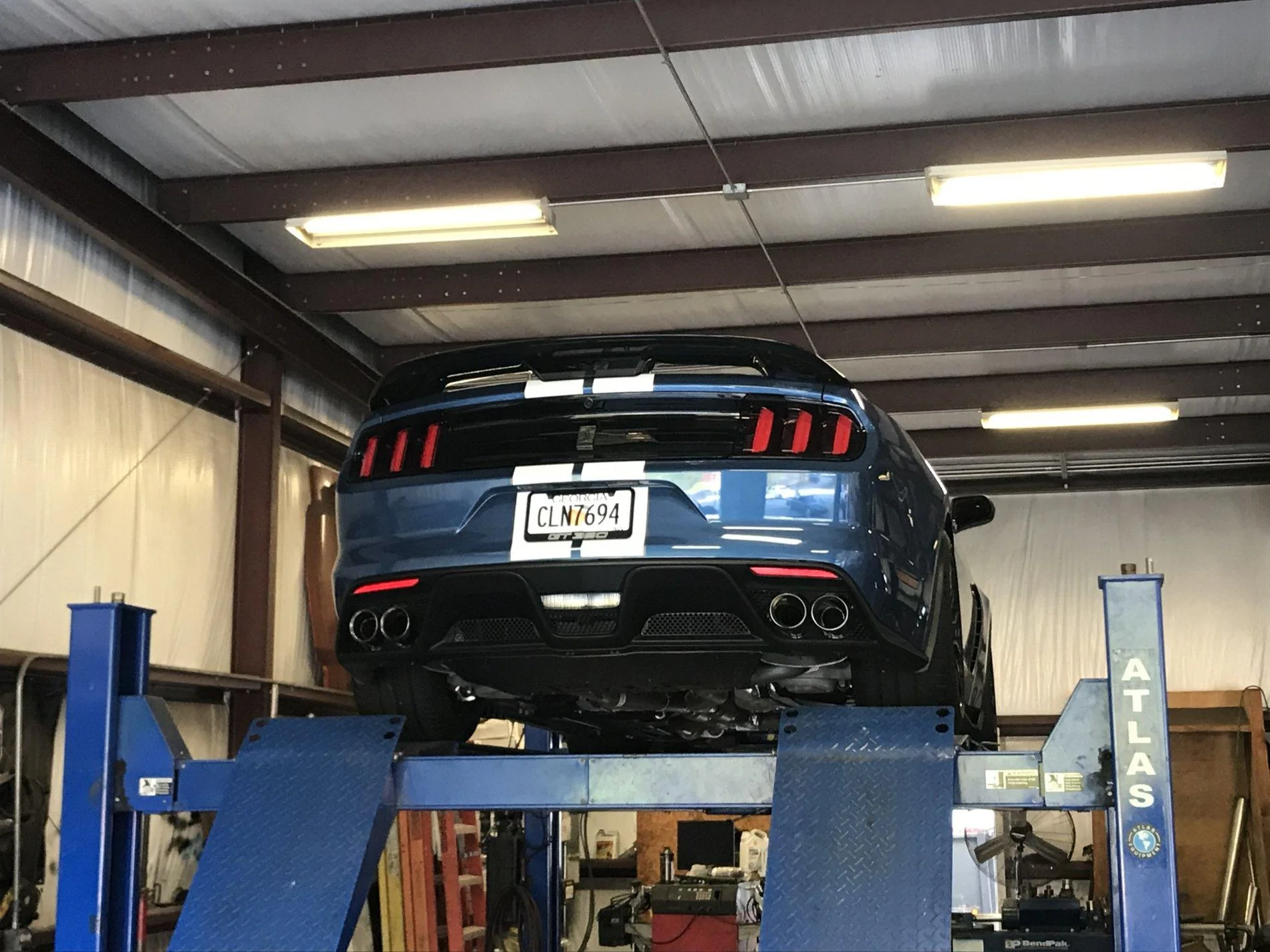

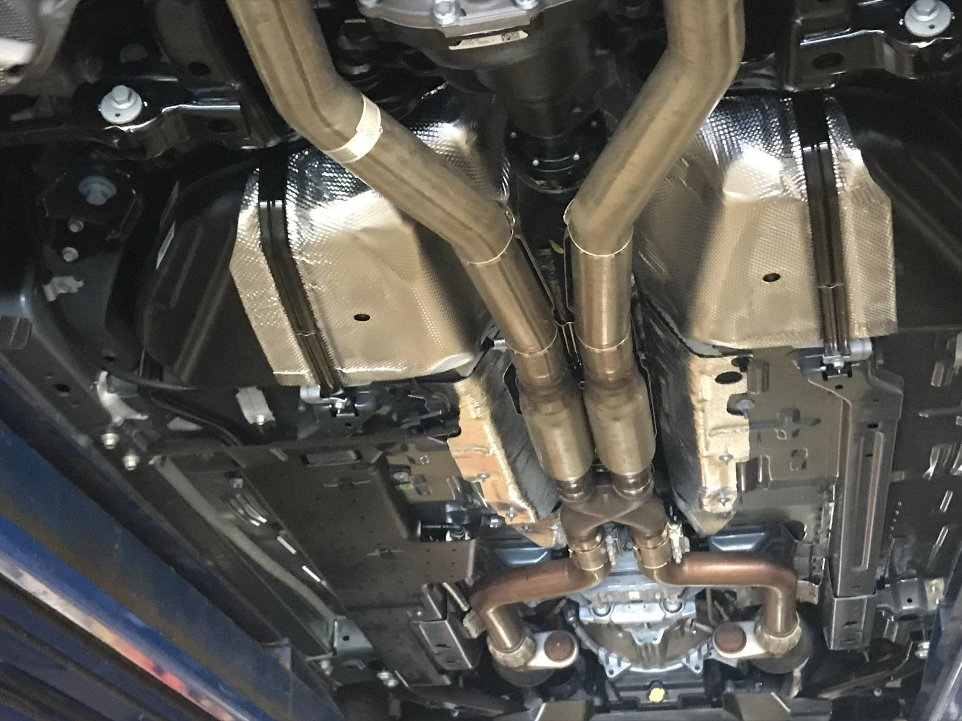

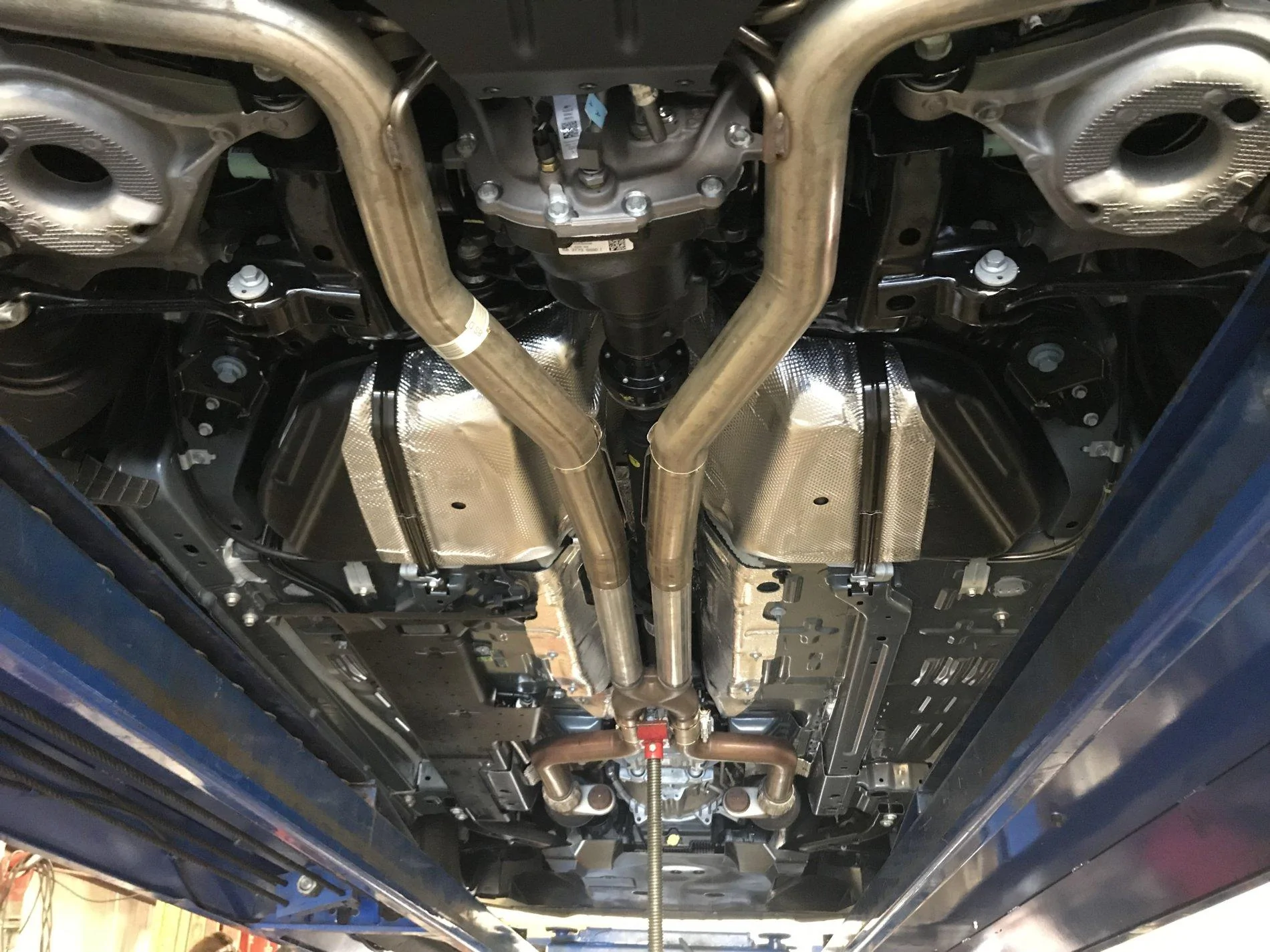

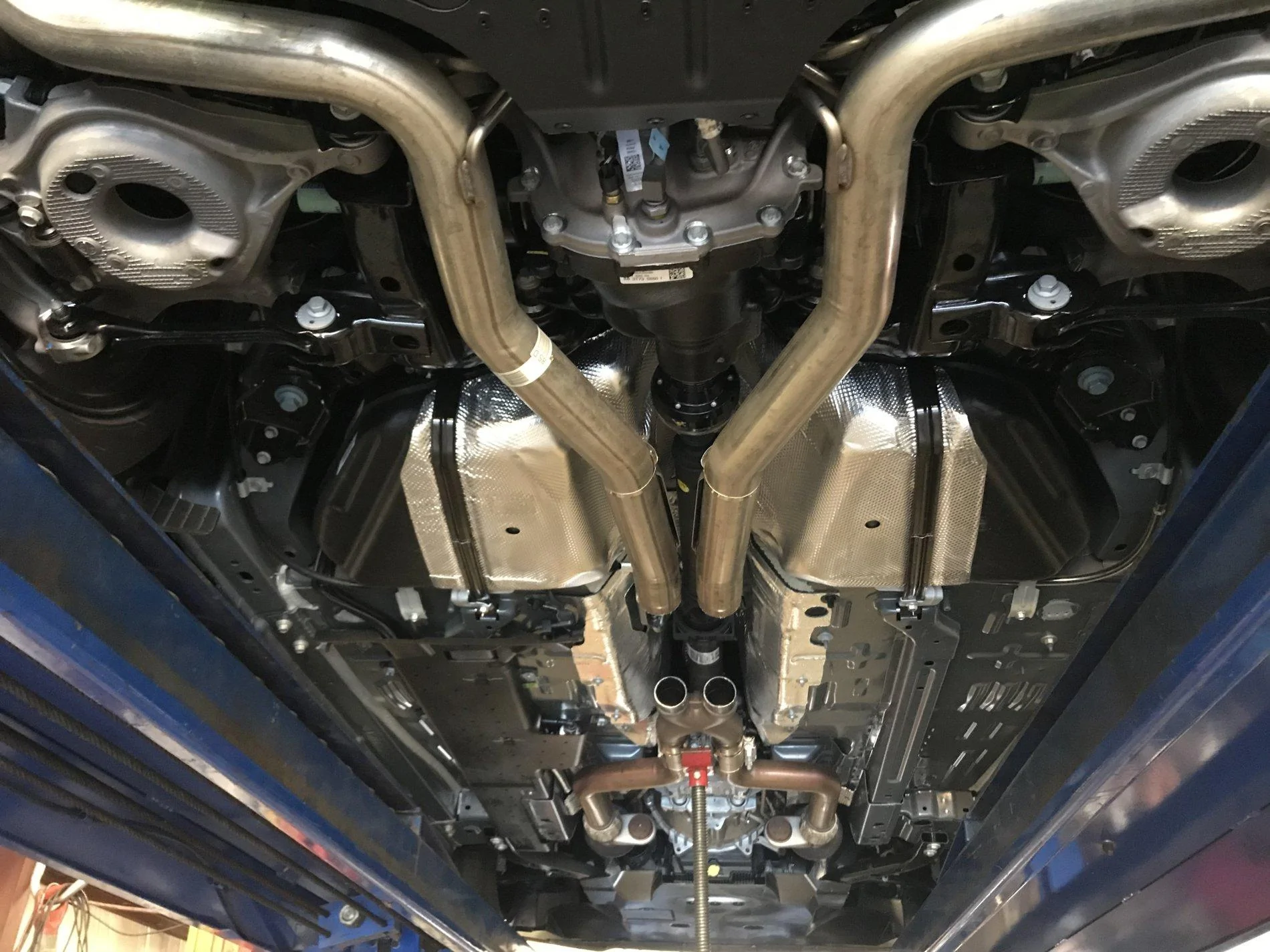

I went the simple route. I found a good muffler shop that had done plenty of resonator deletes, and had them cut the resonators out and weld in straight pipes in their place.
Essentially, I now have the "R" exhaust I believe. The factory X-pipe remains in place as you can see:
The guy charged me $150.00 and his welds looked top notch.
