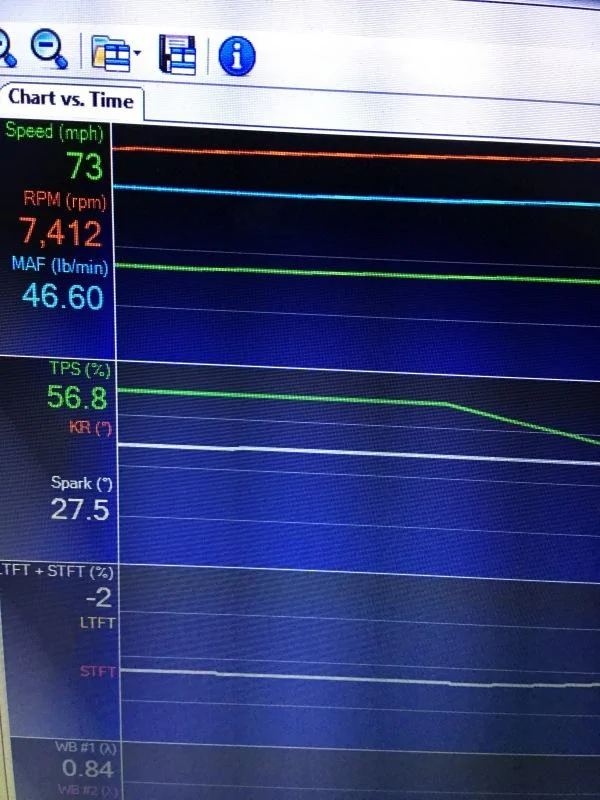

Log shot from last night. 94* ambient air temps and 65% humidity. I'm close to sea level (30ft above) but DA was 2800ft according to the drag times DA calculator I used. Corrected to 0 DA this is about 49 lbs/min through the stock intake manifold. IATs as logged were 100*
Edit I found a calculator. Relative density is 92% which means I'm at 92% airmass I would be at 0 DA which means 46.6/0.92=50.6lbs/min corrected for DA. I technically need to remove 2% for my -2 STFT so actually 0.98(46.6)/0.92=49.63lbs/min corrected for total fuel trim and DA!
Use this calculator here. To calculate your DA and relative density so everyone has fair numbers.
https://wahiduddin.net/calc/calc_da_rh.htm

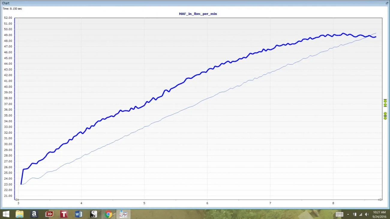

Mods in sig. 7400rpms on 93 oct.

[MENTION=15992]Jayme[/MENTION] that looks about right . I've logged mine at 49.?? With 1.02 corrections . I need to get some VCT tuning time .
