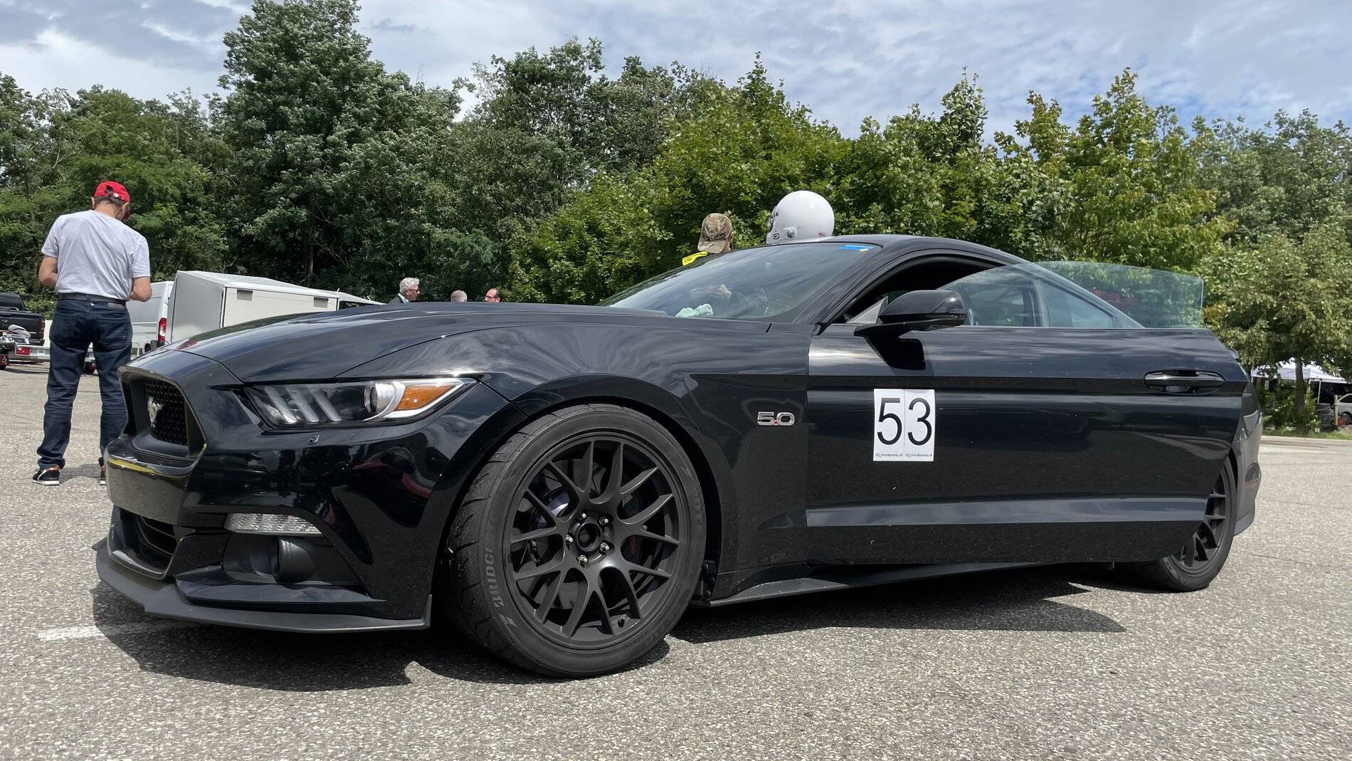

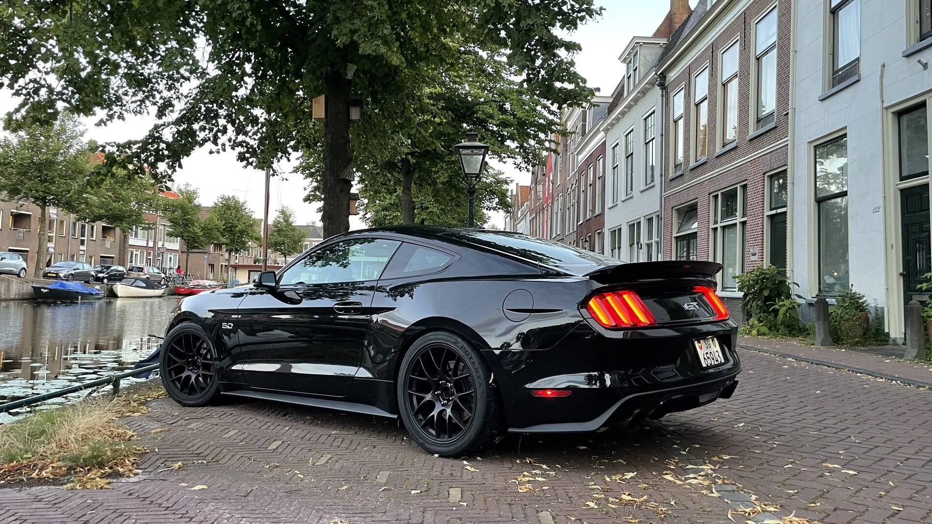

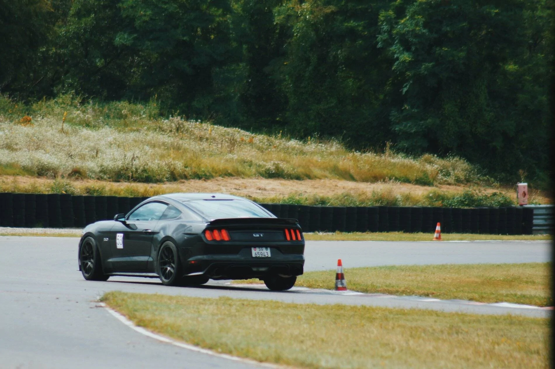

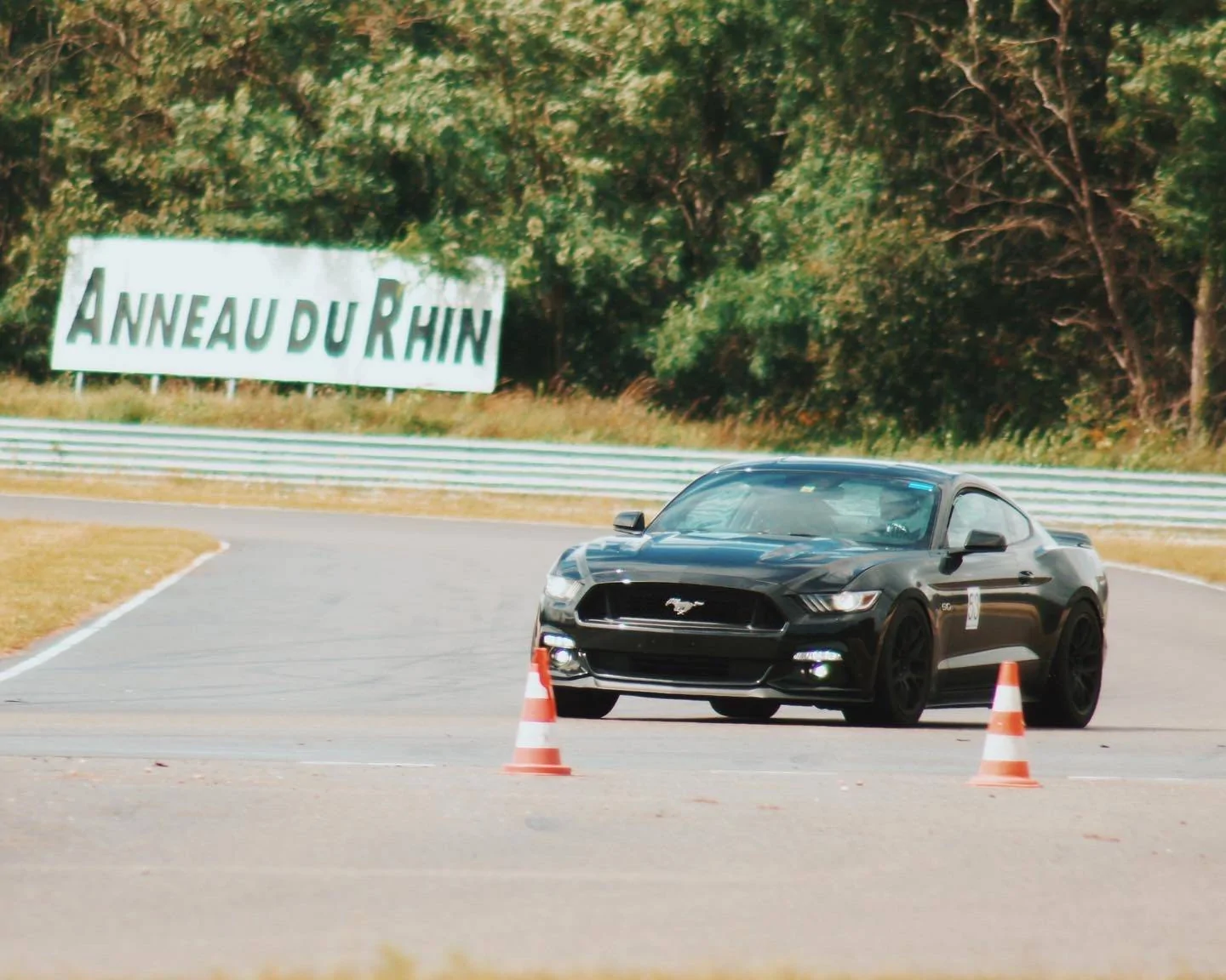

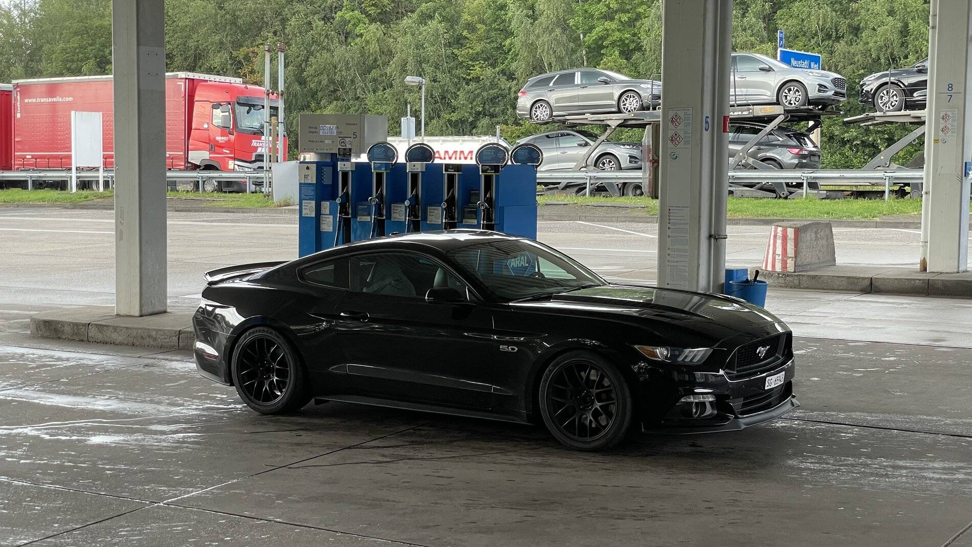

Here’s some pictures from my recent trip to the Netherlands, and from my most recent trackday at anneau du rhin in France
yes, I took on a 2000+ mile roadtrip on my track wheels lol
specs are 19”x10“ EC-7 with a 1cm spacer in front and 5mm spacer in back.
Tires are 285 RE-71R’s. Doing amazing work on track.
Car looks great. Is it lowered? Also how was the ride trip on these wheels any difference in comparison to stock setup in terms of ride quality? I don’t track my car it’s just a daily, but I like the look of this setup!
thanks man! I just have some Steeda progressive lowering springs on it, other than that it’s just the stock performance pack dampers. It’s a great setup that handles surprisingly well even on track.
I always drive with my track wheels so I don’t really remember what stock was like haha. But they’re a big upgrade just in terms of weight savings which you’re definitely gonna notice.

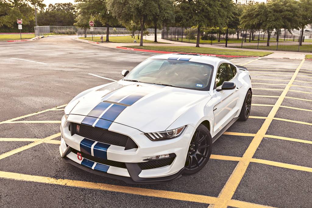

Our customer Mark's GT350 rocking the perfect 19x11" rotate-able square fitment in our SM-10 wheels.
APEX Wheel Fitment Specs:
  • Front/Rear: 19x11" ET52 SM-10 in Satin Black with 305/30-19 Bridgestone RE-71R tires
  • Additional mods: 25mm front spacer and ARP extended studs
Owner's Instagram: @markjardine
