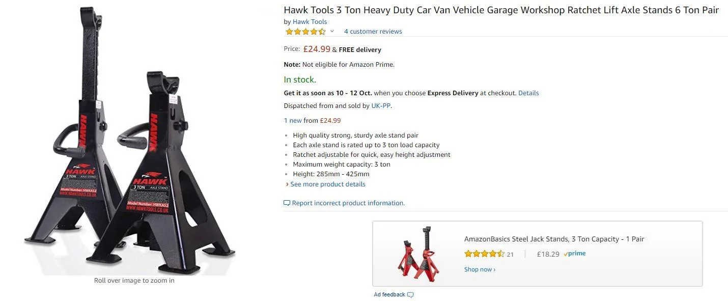

Found these (Same brand as my jack stands but 3t not 2t)
https://www.ebay.co.uk/itm/3-Ton-Ax...m=283121344035&_trksid=p2045573.c100505.m3226

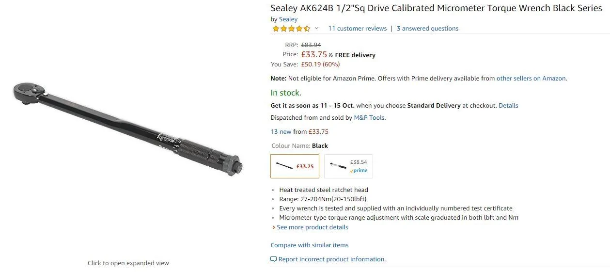

and then this for a torque wrench: (it's in NM, however 150lbft (stock lug torque) is 203nm)
https://www.ebay.co.uk/itm/Ratcheti...738760?hash=item3b1e055e48:g:HuYAAOSwkHJbnTBS

@kristian87uk means fuck all the price, they all torque lol. you're taking wheels on and off not doing anything too special. More expensive u get the more accurate u get sure, but we're talking within 1 or 2 nm lol

Made up my mind...couldn't help paying a few ÂŁ extra for the "black series" lol. Matching black axle stands on the way too :)
And...to further fuel my detailing addiction, some nice detailing brushes, Poorboys wheel sealant and a clay bar ordered through Slims Detailing. Gearing up for a major pre winter detail!
Good choice :like:

correct for spacers - 120, and 150 without.
You would be very surprised.
At work we get a van come around every 6 months to calibrate various items like torque wrenches, they stay about a week to do everything on site.
One of the apprentices bought an extremely cheap wrench (ÂŁ6) off ebay, had it tested and it was almost 18 NM out at 120Nm, (top end of the range on that wrench)
He then went and bought one from Halfords Advanced range, it failed too, (it even came with a certificate) when tested was found to be around 4.5Nm out at 100Nm.
My snap on torque wenches have never drifted or been out of calibration or needed adjusting, they have always been within 0.2nm across the whole range, two are nudging 35 years old now, and cost over ÂŁ150 each even back then.
With any tools, you get what you pay for, there is no possible way that cheap will be better or even equivalent to expensive when it really boils down to it
