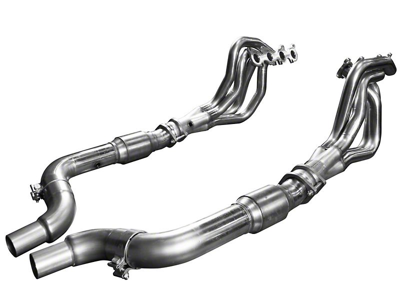

I went to Revolution Auto today, a local highly-respected Mustang specialist, to get a baseline dyno run before I start doing mods. So of course I talked to the people there about this issue.
He told me that headers with high-flow cats should be good, and nothing needs to be disabled or any other trickery. He recommended Kooks, with their “green series” high flow cats. He said the Kooks headers put the O2 sensors in a more ideal place than other headers do. He also suggested Texas Speed as another possibility.
So that’s what they’re suggesting, and they’re going to be who I ultimately get a dyno tune from. So I think I’m going to go along with their suggestions.

They aren't wrong, but those headers are $$$$$. The cat is still back further on the driver side than the OEM location. One nice advantage Kook's has is the angled O2 sensors for E85 use. I haven't had any issues with my horizontal O2 positions on my ARH headers with E85 though. One thing I've seen people say is to get the monitors to set with longtubes, you have to get some major heat going through them (WOT) to get them to read.
