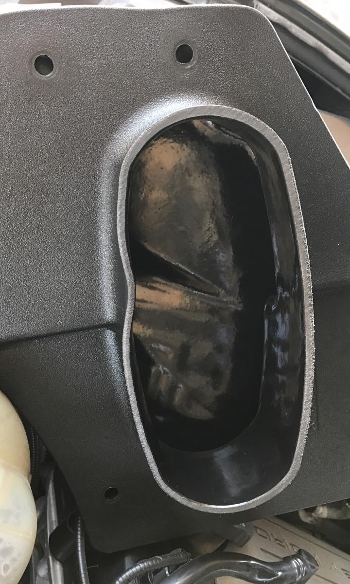

    Update
    After reading through everyone's thoughts, I took the Injen off and went step by step with the install checking for issues. Discovered that the mounting spot for the filter is warped and therefore not sealing correctly. Contacting Injen and/or Stage3 Motorsport (where it was purchased) on Monday to see about receiving a new lid. Can't believe I didn't notice it before. Thank you again for all of your help! IMG_0934.jpg

    wow!!!! Yeah, that would cause some driving issues and I can't believe it's not throwing a code! Glad you got it sorted out.

    I just recently installed mine and everything seems just fine. A rough idle at first but it sorted all out without disconnecting the battery.Sometimes boxes come out of the mold odd for some reason, call Injen asap, CS actually seems pretty decent. Also check all the bungs to ensure there isn't any left over plastic in the holes, Sometimes that causes issues. Also a quick throttle body clean may help. Just a few ideas if the plastic seal doesn't help.
