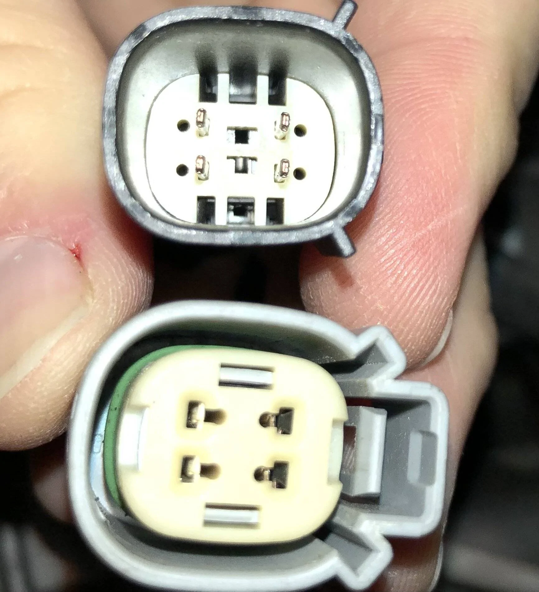

I have a 2019 GT Manual car with Kooks Long Tubes.
The car currently has the included o2 extension for the upstream o2 sensors.
My installer did not install rear o2s.
I noticed this during my spring time review.
I went to Ford and ordered the downstream o2s.
They ordered me Ford part JR3Z-9G444-C.
Those downstream sensors do NOT seem to have the correct connectors.
It appears to have a 4 pin connector with an open "U" shape hole.
The connectors on the car appear to be the same as the upstream ones.
Similar looking to what these would go into:
https://www.americanmuscle.com/ford-mustang-oxygen-sensor-upstream-front-driver-side-jr3z-9f472-a.html?utm_content=Exhaust - Oxygen Sensors|Ford&T5_Var4=410577&utm_source=google-pla&utm_medium=shopping&T5_Var2=shopping&utm_campaign=AMM+Mustang+Parts+Medium+RLSA&T5_Var3=blue&intl=0&dialogtech=ppc&gclid=Cj0KCQjwyZmEBhCpARIsALIzmnLDamqV8hsCs_v4MZ3xDczERDAPqCLHcqtpvlYva55DA0DtAahxYf0aAgX5EALw_wcB&gclsrc=aw.ds
Forgive my ignorance... Im not the most mechanical.
Does anyone know if I need an adapter of some sort?
Perhaps a different downstream o2?

My downstream sensor harness extension did not fit without modification but it still looks different than the sensor you have indicated. Hope this picture helps. Cheers

Wrong sensors. Why didn't your installer put the factory rear O2's in their rightful place during the install?
What are the correct sensors? Do you have a part number or link?

On mine the front O2 sensors had black connectors and the rear were gray. Also no extensions were required on my setup. There was enough cable for all 4 to reach.
