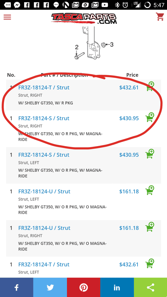

If I was willing to purchase, R struts, R springs, R rear sway, but not R wheels and the vehicle dynamics module was still programed as a stock 350, am I going to end up with a car that is "off" or am I still looking at an improvement over my stock 350 but at a little lesser results to an R. I am afraid of throwing off the balance of my stock 350 by doing a half ass R spec conversion. Thoughts??? Also could a vehicle dynamics module (suspension tuning) be ordered for an R and popped in or has anyone actually had any real world experience having the dealer flash it to R spec?
