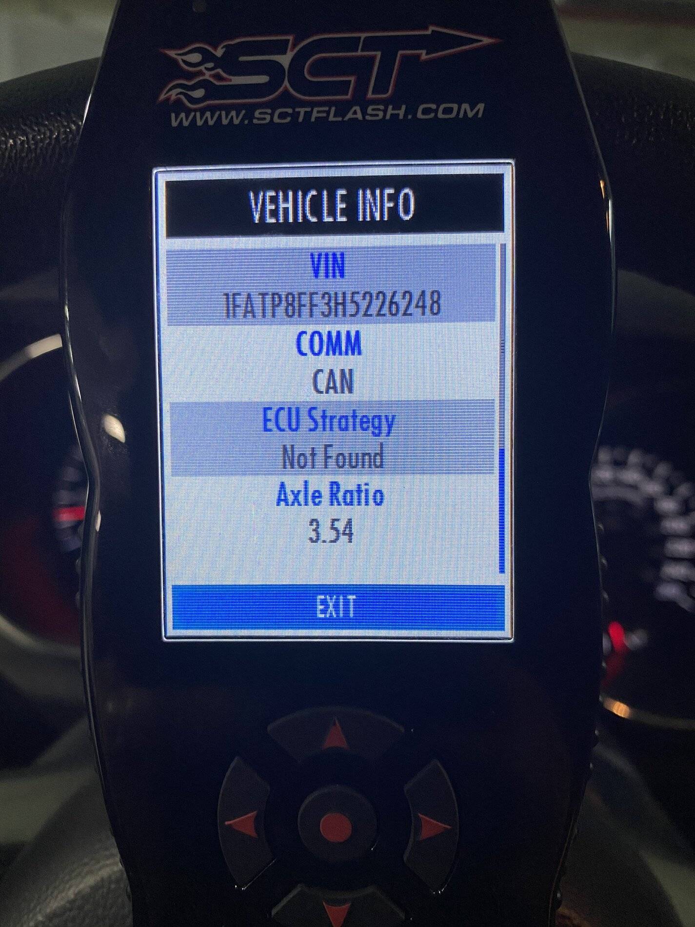

Hi Everyone
i installed a tune and went into vehicle info on my sct and the Strategy code is not available
any idea why is that

I think that may be normal for an SCT X4. Mine says the same thing after tuning, not sure if it said anything different with the stock tune. Runs fine, so I don't think it is an issue.

Put it back to stock and look again if you need to know what it is. But it’s probably blanked out when the tune is loaded to effectively lock your pcm from being flashed by anything else.
