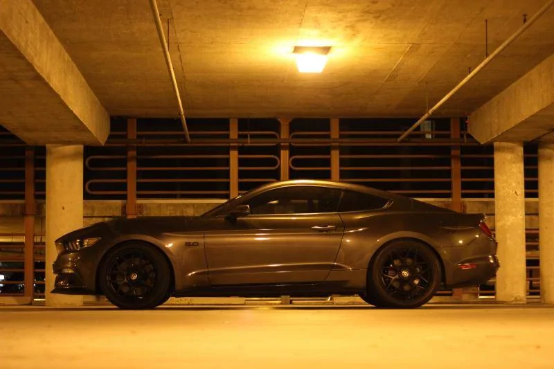

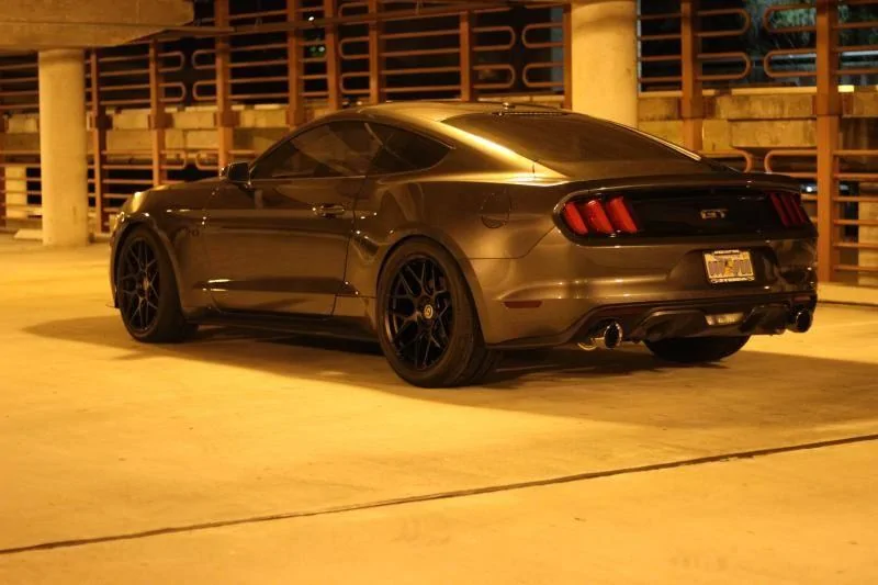

Anybody have a pic of 315/35/20 nitto invo on a 10.5 rim? just trying to compare the sidewall size from a 295/35/20 to a 315/35/20 nitto invo. Im hoping these tires will stick and go and get rid of some of the wheel hop. thanks

Here you go this is Mr. Olsens ride I did recently on HRE FF01 wheels with a 20x10.5 rear wrapped in 315/35/20 Nitto Invos and the front is a 20x9.5 with a 275/35/20

I think this is one of the nicest setups you can do alongside the Vossen wheels
275/315 tire sizing is perfect IMO as well, then again I like wide beefy tires on American muscle cars.

Doesn't look like stock ride height because of the rake. Front is lower than rear.

Agreed!

wow, these look great. The Nitto Invos are on the top of my tire list.

Do those rub at all? Stock ride height?
Cream Puff the fitment at stock height will not rub.
Now when lowering the vehicle you have to keep in mind to keep that natural camber the way it is and not adjust it or zero it out, that is what is necessary for doing these large tire setups. It wont cause that crazy tire wear everyone worries about thats caused by the Teo not the Camber.
So yes this setup stock or lowered is doable :thumbsup:
