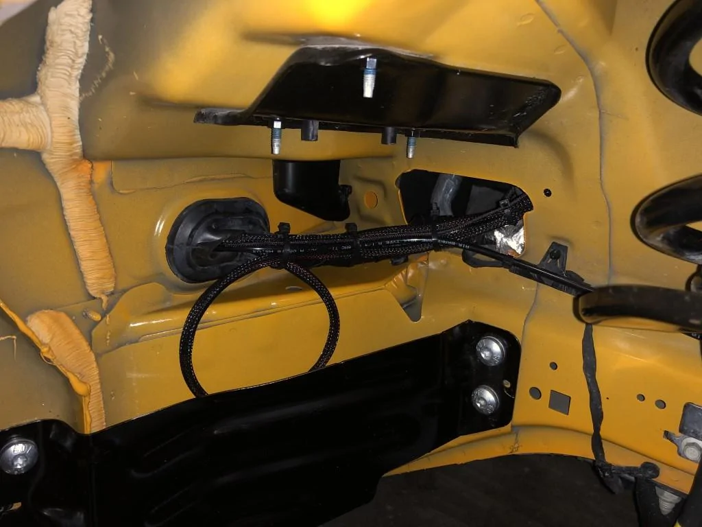

Want to pass a couple of power harnesses from the passenger tire well into the engine compartment to the battery. Have not removed the splash shield yet, is there an access hole available?

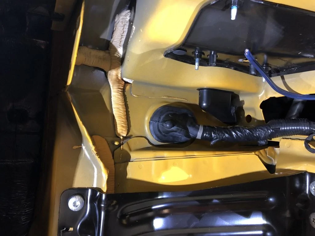

Found one, just follow the harness.

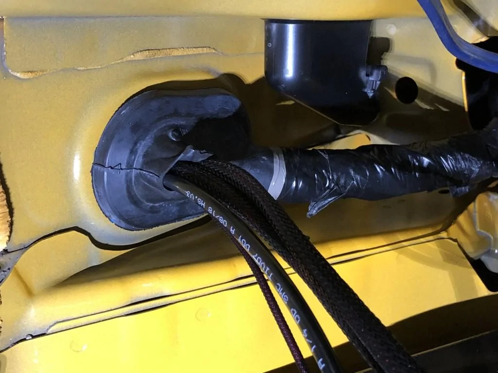

That dime size nipple on the black grommet...cut the tip of the nipple off and run your convoluted tubing through the nipple. I did that on my '05. Had the same set up.

Harnesses and air line done.
