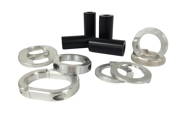

1. Subframe bushing support and alignment kit. - https://www.steeda.com/steeda-s550-subframe-alignment-and-support-kit.html This kit is going to eliminate Subframe movement front to back and side to side as well as top to bottom.

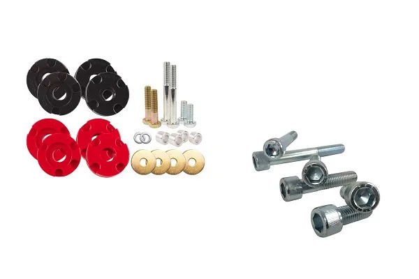

3. Differential bushing inserts with upgraded bolt kit. - https://www.steeda.com/Steeda-S550-...olt-Upgrade-Combo--2015-2019-GT-_p_16599.html These bushings will minimize pinion angle changes, increase traction, eliminate wheel hop and differential deflection.

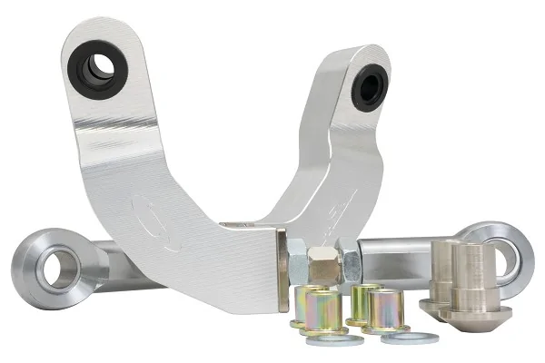

4. Adjustable camber arms. - https://www.steeda.com/steeda-s550-mustang-rear-adjustable-camber-arms-15-16-all-555-4123.html These arms will allow you properly set camber in the rear for Drag racing. They will also your supension to articulate the way it should.

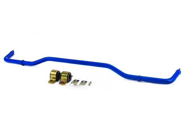

6. Rear drag sway bar. - https://www.steeda.com/steeda-mustang-drag-race-rear-sway-bar-2015-2016-gt-ecoboost-v6-555-1018.html This bar will provide substantially reduced body roll to support high horsepower applications through any drag race requirements.

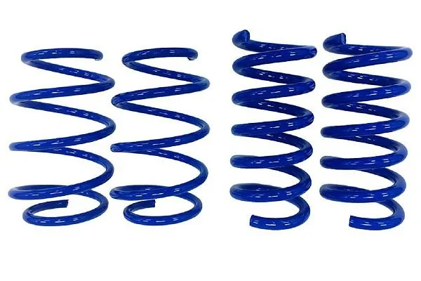

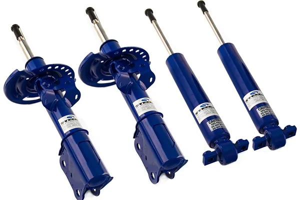

7. Adjustable Pro-action shocks and struts paired with Drag springs and Billet shock mounts. - https://www.steeda.com/steeda-s550-mustang-pro-action-shocks-struts-kit-555-8157.html
https://www.steeda.com/Steeda-S550-Mustang-Drag-Springs--Linear-2015-2019-GT_p_13500.html
https://www.steeda.com/steeda-s550-mustang-billet-rear-shock-mount-12mm-rear-shocks-555-8152.html
These shocks and struts along with springs and mounts have been proven to work on our own Steeda "Silver Bullet" drag car. The car currently holds the 2018+ NA world record at 10.36 @ 131 and has seen short times of 1.48.
This recipe has seen a 1.18 short time Jon Lund's record holding s550. I am a SME on our own personal drag car and can provide you with any additional information you need in setting up your car to get down the track the fastest it can go. All the parts listed are currently on Sale for the Holidays but I will gladly tighten up the pricing for a package deal. If you have any additional questions, my name is Jigar feel free to reach out to me via PM, email, or a phone call.
