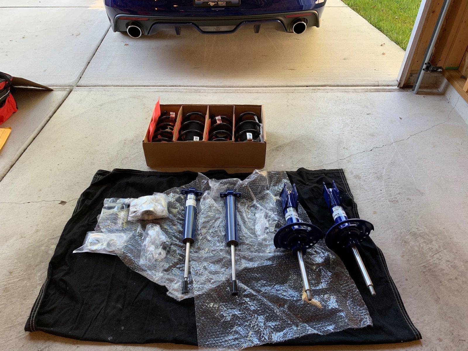

All new suspension being installed today. I’m hoping it all goes well and does what i’m looking for my street car.
I’ve read a lot of other members suspension input and asked a lot of advice to finally decide on the parts.
Steeda Fixed Proaction shocks and struts
PP springs bought off a members new 18
Steeda billet shock mounts
Steeda irs support braces and bushing kit
I’ll give my input when I can put some miles on it.
