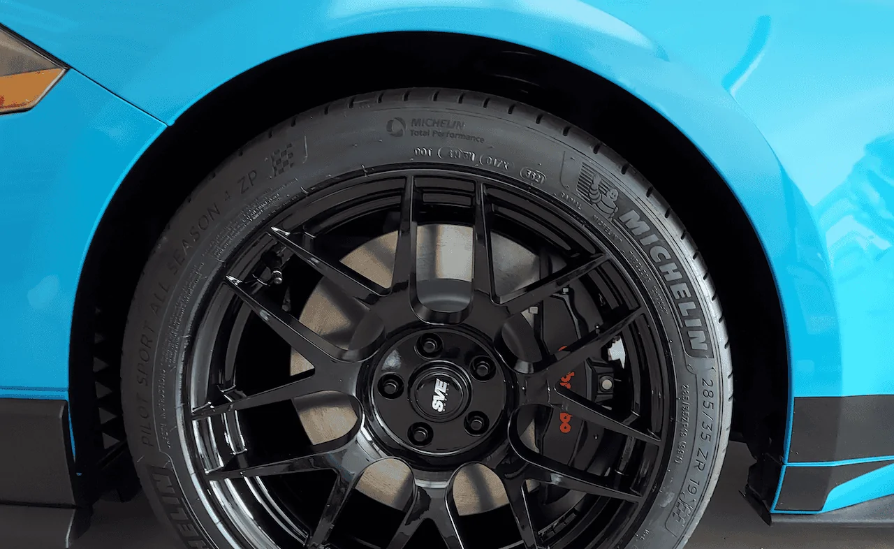

See attached.
My greatest change in diameter involved the front. I moved from a 305/30/19 to a 285/35/19.
The change was .7 inch / 17mm increase in diameter. As you can see, I continue to have a rather large, some would say, unsightly, gap. LOL. Have had zero issues with tires rubbing against the body or suspension.
My concern with your proposed change involves percentages.
A general rule of thumb when changing tire diameter is to stay within +/- 3% of the original; you appear to be exceeding this, at 4%. Speedo changes are one thing, but if an auto, it could impact shift points. Brakes: ABS distances. No, your car will not immediately fall apart. But the changes have the potential to be noticeable.
Can you exceed the 3% rule? Many can and do, without issue and without making any adjustments. I'll let others with more experience chime in.
